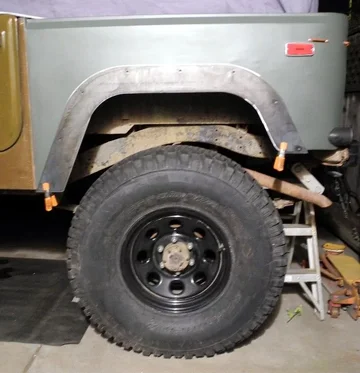

Hot off the presses! 3/16" thick rear fender protection panels

Edit: The latest versions are run on a $600k laser cutter and the vendor does the counter sunk holes if you want.
My design, cut on a CNC plasma cutter table. I've got a counter sink bit and matching flat-head hex machine screws for it. Still some adjusting to do. I might bring it down and redrill that lowest hole there on the right. I had him leave the lowest hole on the left, so I could move it around. There's not much metal behind it.
If you look at the pics at the end of my 'after' thread, you can see that the flares move the wheel opening rearwards about 2" to match how the axle is sitting on fj62 springs.
The basic shape of the flare opening is traced off my other fj40, which is uncut.
Actually, since I got them done at a fab shop, I'm pretty sure they can just make copies. $250 a pair, maybe $275 with hardware and shipping? They are just flat though, so not as cool as some other flares.

Before was with 33s (more like 31.5s), after with axle moved back 1.5" and 35s. Going to have to trim a little on the rear edge now.

Nicely done. That could be a good replacement for those of us with PO cut rear quarters and fiberglass flares that want to return to more stock wheel openings without welding in a patch panel or new quarter panel.
What they are also nice for is a platform for all metal or tube flares. Now to figure out a height and width that everyone will be happy with
What are your plans on color, match to body color or contrasting?
Matching. I don't want them to stand out.
This is exactly where this idea came from. My openings were cut out with crappy flares when I bought it.
This exact shape would be the price above, around $250. Any other size or shape will add at least another hundred for the programming time for the CNC.
