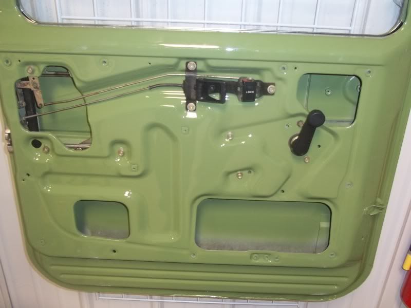

Next...in with the door handle
Inside view
Bolt it up like this...what the picture does not show is that the armature should be swung upwards and bolted to the door

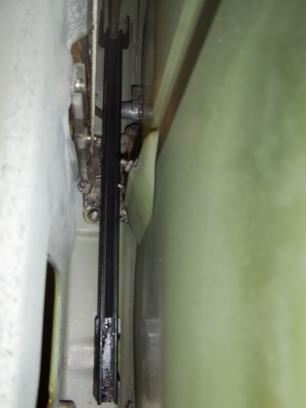

Clean out the old window channel to install the new rubber guides
I lubed the guide with Silicone seal to aid in lubricating the rubber guide.
A brisk push with a very long screwdriver
Now in place

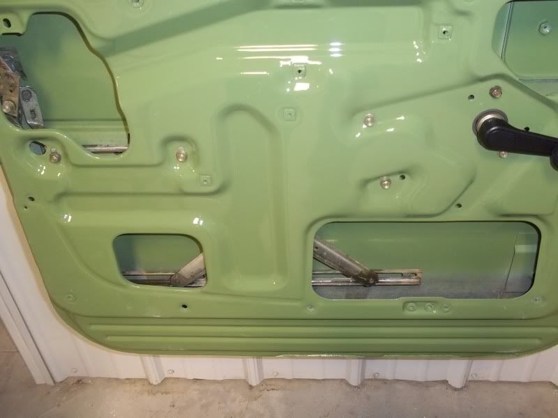

Roll the window mechanism all the way down
Tip the window in...don't worry it will wiggle through the new felt wipers.
It takes a little finaggling but eventually you will get the window upright and bolted in.
Hint make sure the leading edge is in the new rubber channel :doh:
Roll the window all the way up and install the new channel on the opposite side.
Install the outer handle and you are pretty much done

On my doors, when I lock them and close the door, it unlocks. I cannot lock the doors with the key, but if they are locked from the inside I can unlock them with the key. Does this make sense to anyone? Do I have the Cam in incorrectly, or is this likely a Key issue?
That's the way they're supposed to work; you have to hold the outside handle up as you close them to stay locked. Supposed to help you make sure you want them locked, and not accidentally lock your keys in the truck.
Don't know, but something is not right.

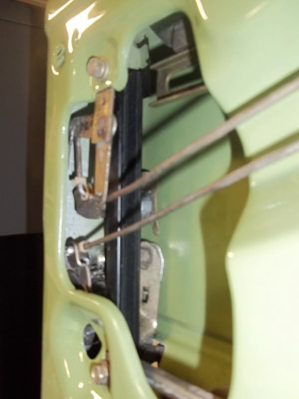

What part am I missing between the lock and the arm? Searched the old parts and can't find a part to connect the two...
Any help appreciated.
I couldn't tell you as i don't own doors... but that is a damn fine write up with some damn fine doors if i ever saw them.
Argh, checked every resource I can find, I'm convinced I am not missing a piece. Tried bending them (true Aussie way of making things work) to meet each other but then they didn't meet up.
Are my locks wrong? Are there longer ones available?
doesn't that rod with the green clip go in it? put the clip in the hole first and then the rod
