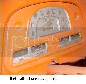

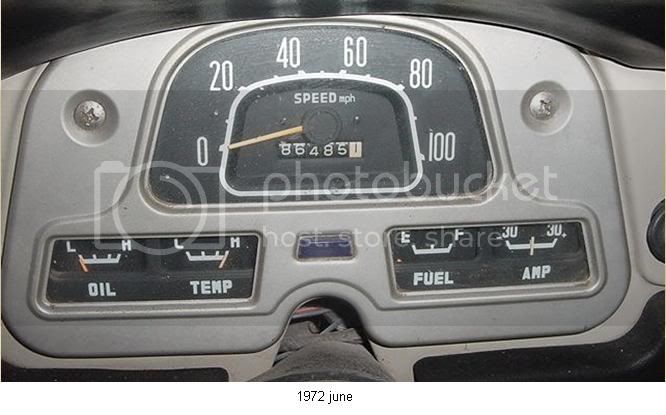

The 3rd generation from Sept. ’72 till Jan. ‘79
EDIT; Jan. 20, 2014 : This text is added later and is the same as in posting #310 which was inserted on Jan. 20 2014
I was always wondering why I couldn't find pictures of a '72 - '73 cluster.
Thanks to Mud member Sproggy we found it.
The front looks like a 3rd gen. cluster but the back looks like a 2nd gen. cluster.
Clearly this was the change over model from Sept. 1972 till Sept. 1973.
The cluster is technically a 3rd gen. cluster. Front and internals are identical to the 3rd gen. cluster.
The back side is a metal housing (2nd gen. style) but without the PCB (Printed Circuit Board) from the 3rd gen. clusters.
Have a look......
Note: the red arrow points to the ground terminal for the VR inside the Fuel gauge.

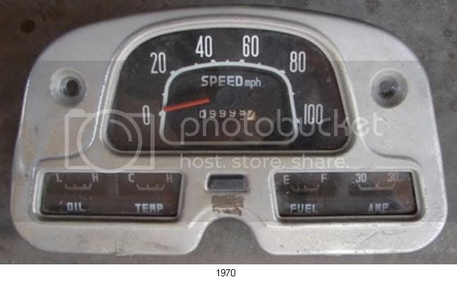

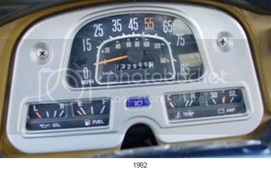

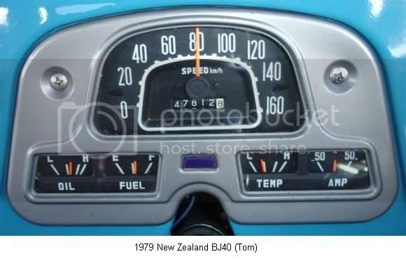

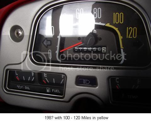

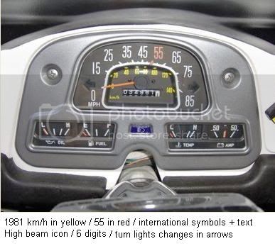

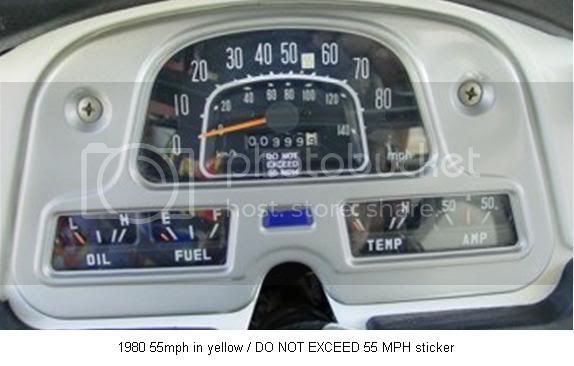

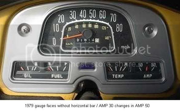

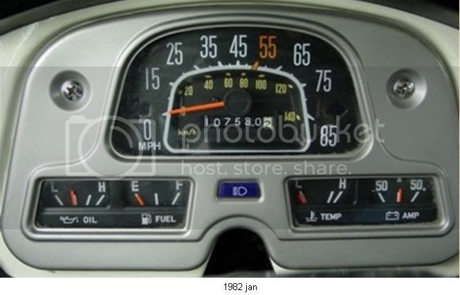

The 4th generation from Jan. ’79 till April 1986
The gauges face plates changed. The horizontal bar is gone.
The AMP gauge changed from 30 AMP internal shunt into 50 AMP external shunt (which is basically a mV meter).

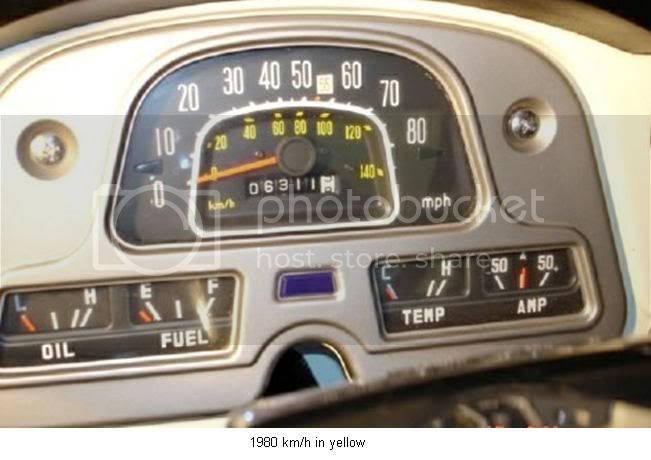

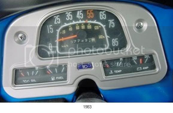

1981: Turn indicator changed from triangle to arrow, international symbols were added and the counter changed from 5 into 6 digits.

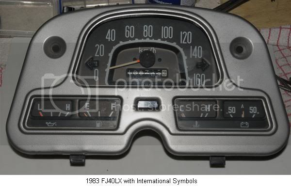

1983: Text under gauges was removed, international symbols only.

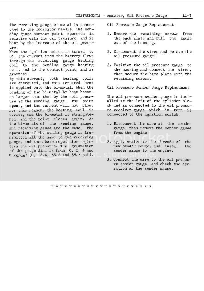

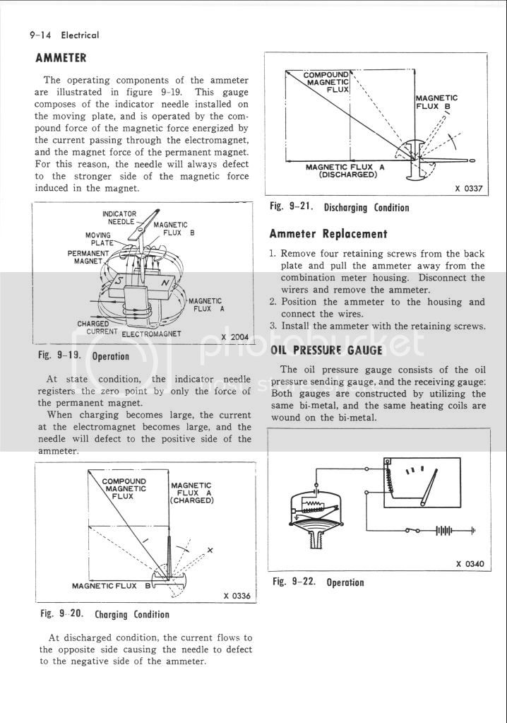

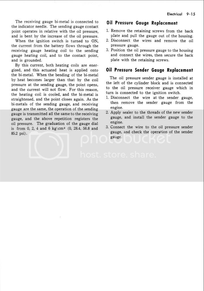

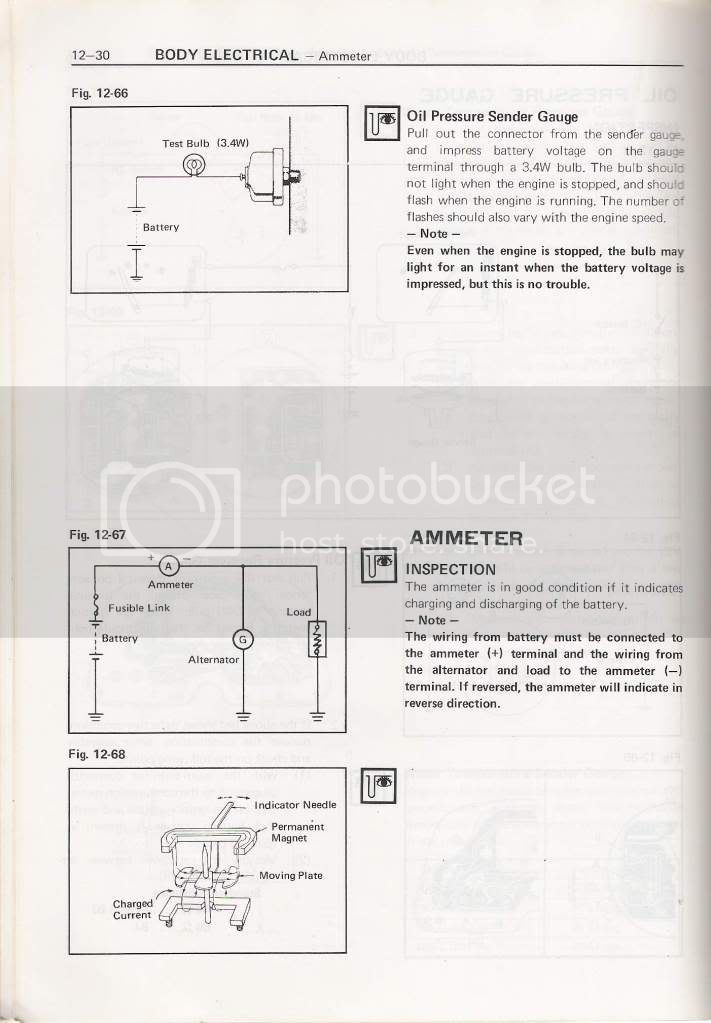

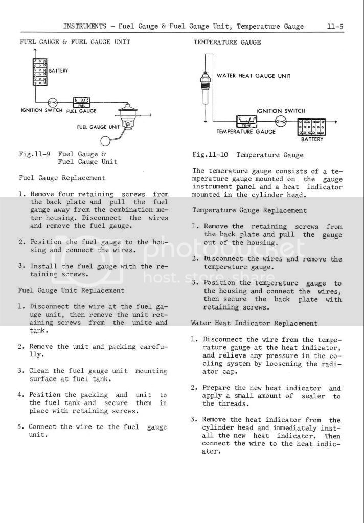

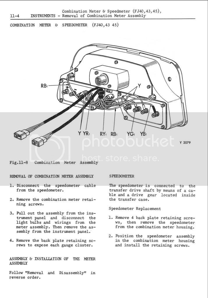

FSM’s for cluster explanation and repair.
As my father always said: Prepare before you begin and another one of his: Preparation is 90% of the success. So let’s start with the documentation.
Here are the chapters related to cluster and gauges from the FSM’s.
From the 1971 FSM for 2nd generation clusters
If you want this in pdf format, you can download it from here: https://docs.google.com/open?id=0BwGk8zcL34N4YWQ4NDljMDQtYzNjMy00NmZjLWEzZDEtMDY3OTg4MDMxNjE0

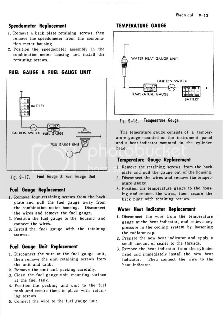

From the 1972 / 1973 FSM also for 2nd generation clusters.
This one is the same as the one above but for the purists under us…. the lay out is a bit different. Pdf format download: https://docs.google.com/open?id=0BwGk8zcL34N4NDIwMmUxYjUtMzY1NC00ODA4LTljOGUtMjJjYjAwOGM4NGQz

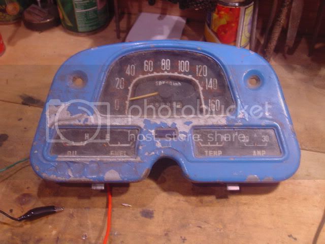

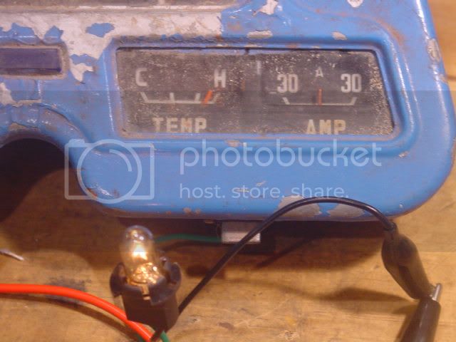

Cluster overhaul
A few weeks ago I bought a spare cluster through Craig list. This baby really needed a complete overhaul. This is how it looked when I bought it. It’s a 3rd generation, 12V cluster for the GENERAL market with only Km/h reading.
[URL="http://i1112.photobucket.com/albums/k490/ruud_coco/Toyota%2040%20series%20clusters%20overhaul/DSC06627.jpg"][URL="http://i1112.photobucket.com/albums/k490/ruud_coco/Toyota%2040%20series%20clusters%20overhaul/DSC06627.jpg"][URL="http://i1112.photobucket.com/albums/k490/ruud_coco/Toyota%2040%20series%20clusters%20overhaul/DSC06627.jpg"][/URL][/URL][/URL]

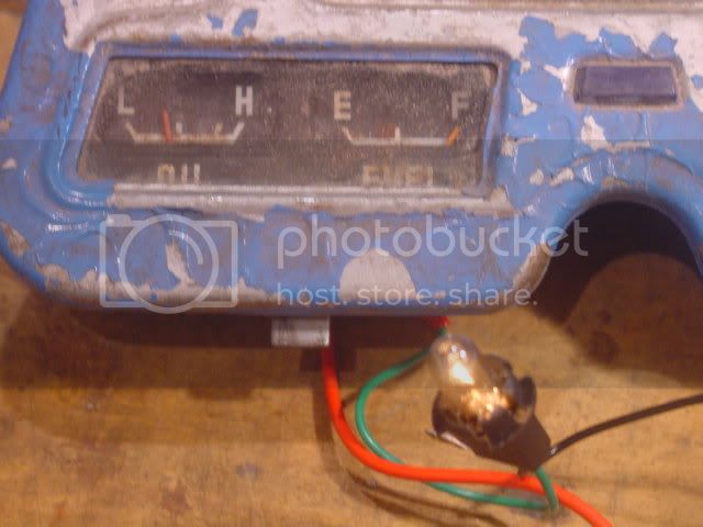

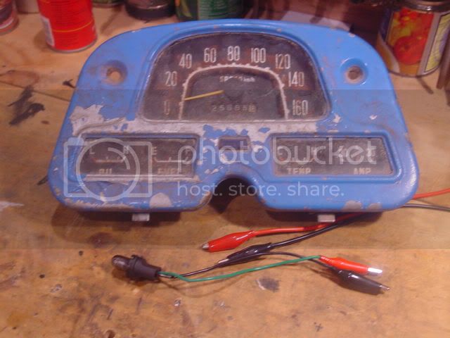

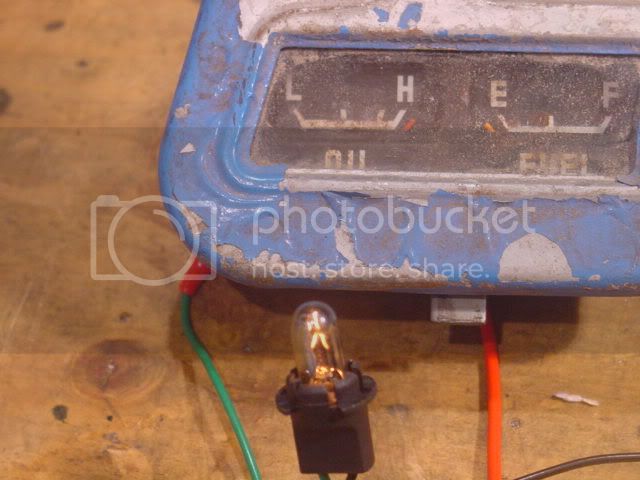

First thing I did was checking the gauges with a test light. The FSM says to check with a 3.4 W bulb but I only have a 3W bulb so that will have to do. The test bulb replaces the sender.
Here are the pics of the OIL, FUEL and TEMP gauges. The AMP gauge I tested with a 50W bulb to see if there was needle movement. All gauges passed the test!
The OIL gauge
[URL="http://i1112.photobucket.com/albums/k490/ruud_coco/Toyota%2040%20series%20clusters%20overhaul/DSC06628.jpg"][URL="http://i1112.photobucket.com/albums/k490/ruud_coco/Toyota%2040%20series%20clusters%20overhaul/DSC06628.jpg"][URL="http://i1112.photobucket.com/albums/k490/ruud_coco/Toyota%2040%20series%20clusters%20overhaul/DSC06628.jpg"][/URL][/URL][/URL]
The FUEL gauge
[URL="http://i1112.photobucket.com/albums/k490/ruud_coco/Toyota%2040%20series%20clusters%20overhaul/DSC06629.jpg"][URL="http://i1112.photobucket.com/albums/k490/ruud_coco/Toyota%2040%20series%20clusters%20overhaul/DSC06629.jpg"][URL="http://i1112.photobucket.com/albums/k490/ruud_coco/Toyota%2040%20series%20clusters%20overhaul/DSC06629.jpg"][/URL][/URL][/URL]
The TEMP gauge
[URL="http://i1112.photobucket.com/albums/k490/ruud_coco/Toyota%2040%20series%20clusters%20overhaul/DSC06630.jpg"][URL="http://i1112.photobucket.com/albums/k490/ruud_coco/Toyota%2040%20series%20clusters%20overhaul/DSC06630.jpg"][URL="http://i1112.photobucket.com/albums/k490/ruud_coco/Toyota%2040%20series%20clusters%20overhaul/DSC06630.jpg"][/URL][/URL][/URL]
The 12 Volt power supply and test light
[URL="http://i1112.photobucket.com/albums/k490/ruud_coco/Toyota%2040%20series%20clusters%20overhaul/DSC06631.jpg"][URL="http://i1112.photobucket.com/albums/k490/ruud_coco/Toyota%2040%20series%20clusters%20overhaul/DSC06631.jpg"][URL="http://i1112.photobucket.com/albums/k490/ruud_coco/Toyota%2040%20series%20clusters%20overhaul/DSC06631.jpg"][/URL][/URL][/URL]

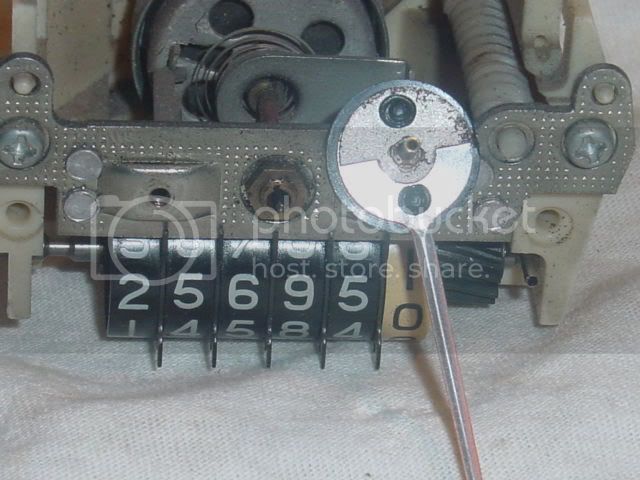

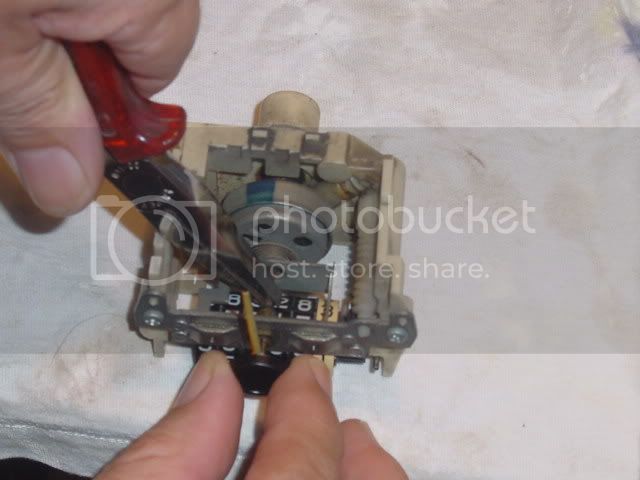

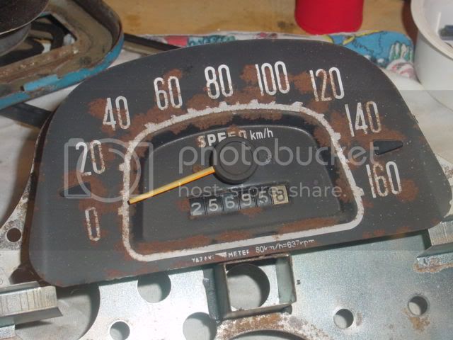

A supplement to this posting is the removing of the needle. I ran into that same problem and solved it this way: Move the needle to the 12 o’clock position. Hold the shaft with a flat nose plier and twist and pull the needle from the shaft.
[URL="http://i1112.photobucket.com/albums/k490/ruud_coco/Toyota%2040%20series%20clusters%20overhaul/DSC06652.jpg"][URL="http://i1112.photobucket.com/albums/k490/ruud_coco/Toyota%2040%20series%20clusters%20overhaul/DSC06652.jpg"][/URL][/URL]
[URL="http://i1112.photobucket.com/albums/k490/ruud_coco/Toyota%2040%20series%20clusters%20overhaul/DSC06653.jpg"][URL="http://i1112.photobucket.com/albums/k490/ruud_coco/Toyota%2040%20series%20clusters%20overhaul/DSC06653.jpg"][/URL][/URL]

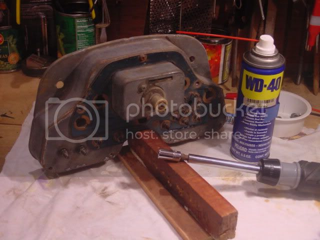

Before you start removing the gauges spray the studs with some WD40 and let it rest for a few hours or better for a night. The problem here is that the studs are red copper with metal nuts. If the nut is stuck and you apply too much force you’ll twist the stud out of the plastic housing. Ask me how I know.
[URL="http://i1112.photobucket.com/albums/k490/ruud_coco/Toyota%2040%20series%20clusters%20overhaul/DSC06633.jpg"][URL="http://i1112.photobucket.com/albums/k490/ruud_coco/Toyota%2040%20series%20clusters%20overhaul/DSC06633.jpg"][/URL][/URL]

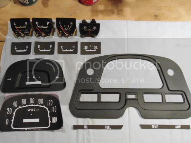

This is how it looks when everything is taken apart.
[URL="http://i1112.photobucket.com/albums/k490/ruud_coco/Toyota%2040%20series%20clusters%20overhaul/DSC06636.jpg"][URL="http://i1112.photobucket.com/albums/k490/ruud_coco/Toyota%2040%20series%20clusters%20overhaul/DSC06636.jpg"][/URL][/URL]

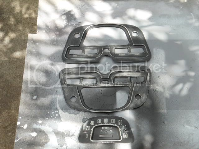

Here is a close up of the face plate. It really needed a new decal.
[URL="http://i1112.photobucket.com/albums/k490/ruud_coco/Toyota%2040%20series%20clusters%20overhaul/DSC06638.jpg"][URL="http://i1112.photobucket.com/albums/k490/ruud_coco/Toyota%2040%20series%20clusters%20overhaul/DSC06638.jpg"][/URL][/URL]

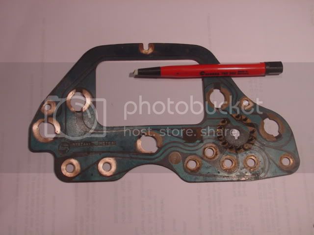

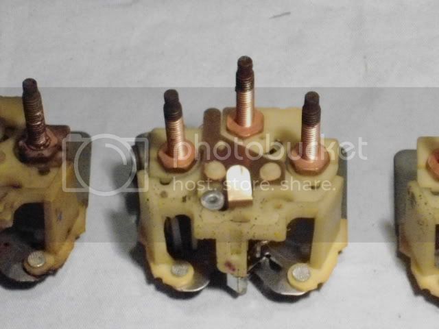

I started with the PCB (Printed Circuit Board). Degreased and cleaned it and cleaned all the contact points with a fiber glass pencil until they were bright and shiny.
[URL="http://i1112.photobucket.com/albums/k490/ruud_coco/Toyota%2040%20series%20clusters%20overhaul/DSC06661.jpg"][URL="http://i1112.photobucket.com/albums/k490/ruud_coco/Toyota%2040%20series%20clusters%20overhaul/DSC06661.jpg"][/URL][/URL]

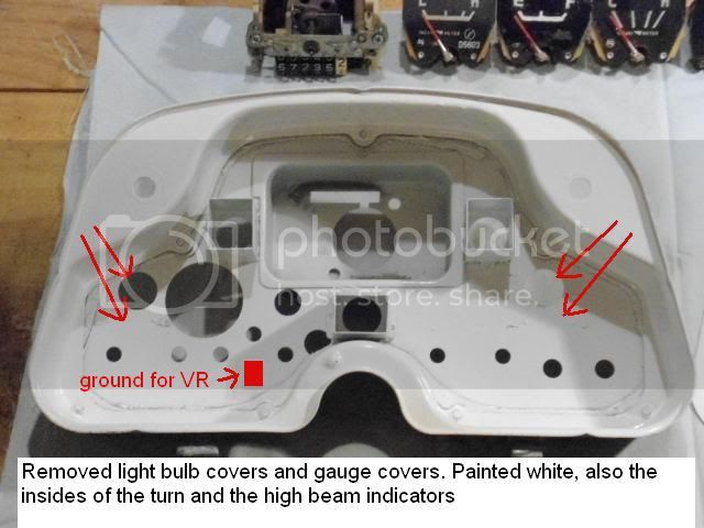

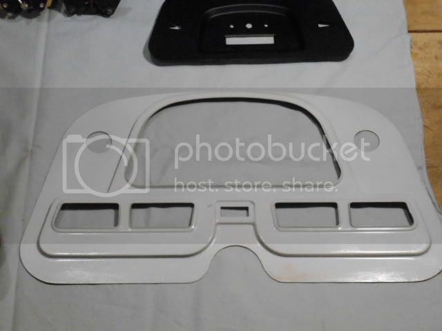

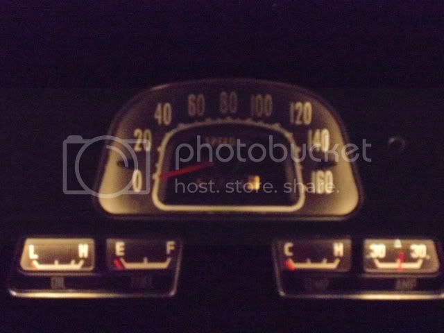

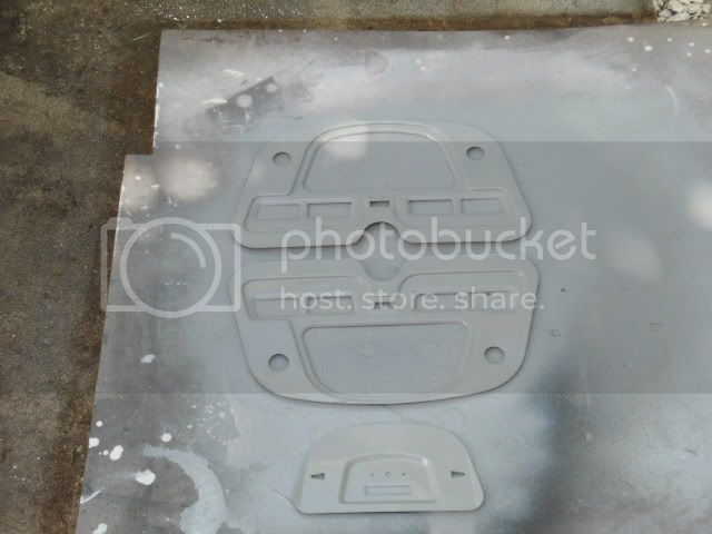

Next step is the housing. While you have it all apart you can improve the illumination drastically with some simple steps.
Remove the 2 round light bulb covers. 90% of the light is trapped in these covers. There is a small hole on the outside to let the light out in the direction of the housing so only 10% comes out of it.
Remove the 2 covers above the OIL and AMP gauge. They are blocking the light from spreading.
Paint the housing either silver or shiny white. My choice was white because I had one spray can on the shelf. This is how it looks after these 2 small modifications.
Tip. Make sure that you clean up the ground contact behind the Fuel gauge. There is a tiny rectangular spot that serves as a ground for the build in Voltage Regulator.
If you forget this...... the Voltage Regulator will not work and so your FUEL and TEMP gauge will be slowly fried by 12 - 14Volt!
Also clean up the ground contact on back of the FUEL gauge! Check the spring tension and adjust a bit if necessary.

I also painted the back side of the main face plate white for better reflection of the light.

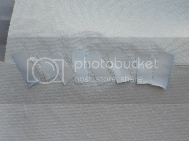

Next step are the gauge needles. I use fluorescent red. This kind of paint gives the best results when applied on a white background so that’s not too difficult.
Here is how I did it. I lined up the gauges between 2 pieces of wood. Put a sheet of kitchen towel under the needles covering the face plates. Another sheet to cover the bottoms and gently taped the spaces in between to prevent overspray on the gauge housings.
[URL="http://i1112.photobucket.com/albums/k490/ruud_coco/Toyota%2040%20series%20clusters%20overhaul/DSC00240.jpg"][URL="http://i1112.photobucket.com/albums/k490/ruud_coco/Toyota%2040%20series%20clusters%20overhaul/DSC00240.jpg"][/URL][/URL]
White
[URL="http://i1112.photobucket.com/albums/k490/ruud_coco/Toyota%2040%20series%20clusters%20overhaul/DSC00241.jpg"][URL="http://i1112.photobucket.com/albums/k490/ruud_coco/Toyota%2040%20series%20clusters%20overhaul/DSC00241.jpg"][/URL][/URL]
Leave it alone for 30 minutes. The paint dries pretty fast but you are going to change the color and these paints have the bad habit to dissolve the previous layer of paint a bit so walk away, have a coffee or a beer or whatever but let it dry for 30 minutes minimum.
Fluorescent red
[URL="http://i1112.photobucket.com/albums/k490/ruud_coco/Toyota%2040%20series%20clusters%20overhaul/DSC00245.jpg"][URL="http://i1112.photobucket.com/albums/k490/ruud_coco/Toyota%2040%20series%20clusters%20overhaul/DSC00245.jpg"][/URL][/URL]
Now….. LET IT DRY, leave it for a few hours. WALK AWAY, GET A BEER, do something else!
The point is that although the paint is “dry” after a few minutes, it’s still soft and damage is easily done at this point.
To be continued.....

Cluster overhaul part ll

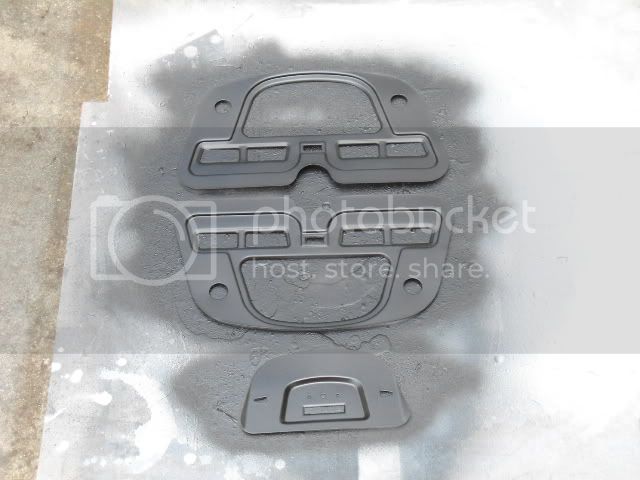

The face plates. Nothing difficult here. I sanded them, a coat of primer to check for irregularities and a final coat of flat black.
Sanded and ready for primer
Primer
Flat black.
It looks grey in the picture but that is because of the flash going of on my camera.
Now all the plates are ready for their decals.
I made them myself. I took photos of all gauges, did a lot of photo shopping and printed them on a laser printer. I used 3M Super 77 Multipurpose Adhesive spray glue to attach the decals to the face plates.
Put everything back in. Align all the gauges so that the horizontal bars are in the same line and height. Adjust the odo meter so the face plate lines up with the bottom of the glass window.
When everything is back in place and checked, I put in 5Watt light bulbs instead of the regular 3W.
These 5Watt bulbs together with the white paint and the covers that are removed make a huge difference in the illumination.
At night
And ready!
Now I'm the happy owner of a spare cluster :bounce::bounce2:
Rudi
