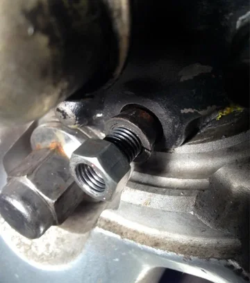

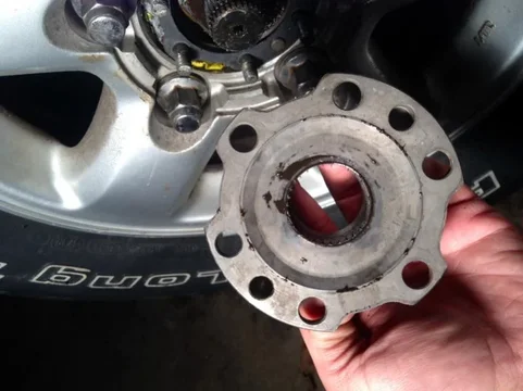

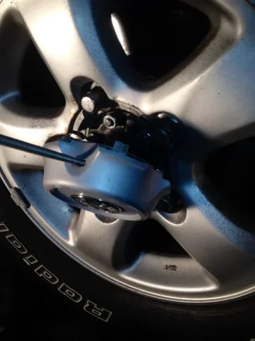

You'll need to remove your front driveshaft to drive around in 2WD until you can get your truck repaired: Before you remove your front driveshaft, mark with a grease pencil or masking tape, a line from the flange on the driveshaft to the output flange of the transfer case and front differential so that you can reinstall your driveshaft the exact same way it was before you removed it. This keeps your splines lined up properly and reduces the chance of creating driveshaft vibration. Once you've marked it, remove your front driveshaft by loosening the bolts and gently tapping the shaft near the flange to knock it loose. Hang on to it because you do not want it landing on your face. Don't ask me how I know. Keep the bolts and nuts organized and set aside with the front driveshaft. You won't be needing this until you fix your busted diff. image-528707593.webp image-388114960.webp image-979781669.webp Now, remove your drive flanges: 1. To remove the drive flanges, insert a screwdriver into the little rectangular slot of the plastic dust cap near the lugnut and just pop the plastic cover off: image-1799269500.webp image-1778120174.webp 2. You will need to pop off the grease cap to access the c-clip which must be removed before removing the flange. Use a screwdriver and some gentle, prying, hammer taps to remove the grease cap. image-2938777903.webp image-2778835458.webp image-2955377253.webp 3. You'll need to pop off the c-clip snap ring using snap ring pliers or creative use of a flat-head screwdriver and needle-nose pliers: image-1729138196.webp image-2863288331.webp 4. Now you can remove the six nuts on the drive flange with a 14mm socket (you'll notice I tapped the grease cap back on to prevent dirt from getting into the splined area while I'm tapping the drive flange and removing the nuts): image-1038008267.webp Underneath those nuts are little washers. Remove them as well: image-2913117645.webp image-3900293049.webp 5. Once you've removed all the nuts and washers, you can thread the nuts back on until it's flush with the stud so you can gently tap the ends with a brass hammer (don't use a regular hammer like it did, it destroys the nuts and studs) which should loosen and pop out the cone washers on each stud, another and possibly better method is to just screw the nuts on the studs to prevent the cone washers from flying across the floor when they pop loose, and tapping all around the flange. This requires you remove the tire/rim and if you have the time and ability, removing the tire and rim allows excellent access.: image-2740143692.webp Close up of cone washer fully seated image-2259904412.webp Cone washer popped up, success!: image-1039491861.webp Once you've popped up all the cone washers (this takes a lot of hammering and tapping, gentle but firm, be patient during this step), you can tap on the flange and gently pry at it to get it to slide off the studs. The gasket can sometimes act like adhesive and make it stick. But it should eventually slide off the studs: image-605294400.webp image-3277431822.webp image-2808028431.webp Now that you have successfully removed your drive flange, if you want to drive in 2wd for any extended period of time, it is essential to do two things: 1. Have your flanges machined on the inside to remove the splines, then order a new gasket from Toyota, and reinstall your machined flanges in the reverse order using the above instructions. 2. Be sure to reinstall your C-Clip. This is important. If you are having trouble getting the CV splined shaft to stick out of the flange far enough to reinstall the C-Clip, push and turn the CV joint/boot from the inside of the tire into the rim/axle and seat it properly. Once it is seated, you'll have just enough length on the CV splined shaft to get the C-Clip snapped back into place. As a last step, you'll want to put plastic or tape or something to cover, as best as you can, the hub/bearing/CV spline area until you can get off the trail or install machined flanges back on. This will keep as much crud, mud, dust, water, baby buffaloes and other a sundry items out of your greased bearing area. What I was able to do, was pull off the rim, and place a square piece of plastic over the hub area, I poked holes in it for the studs, and then put the rim back on which sandwiched the plastic between the rim and hub. This kept grime out until I could get my machined flanges back on. Putting your Toyota emblem dust cap back on also helps...especially with the baby buffaloes...they are just a hair too large to get by the dust cap.
Nice pictures. You need to remove the dustcap to pull the flange.
And most important...
Don't hammer the nut when it's only threaded just a few turns on the stud. Thread the nut on so the end of the stud is exposed and use a brass drift or a brass hammer to hit the stud.
You're only threading the nut back on to prevent the cone washer from flying across the garage or across the trail. You will damage the threads if you hit it while it's slightly threaded on like that and this job will get much more labor intensive when you put everything back together.
Yes, you have to pull the c-clip off to get the flanges off. I find it easier to pop the cone washers by hitting the sides of the hub surface and work your way around. Less change of buggering up threads. Obviously you can't do this with the wheel on. It also helps to leave the nut thread on a little so when the cone washer does pop, it doesn't shoot across the shop, never to be seen again.

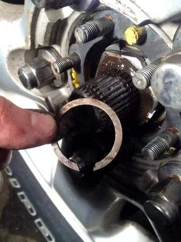

Ok, I've finally gotten around to getting under the truck again today to finish this writeup. I'm having trouble understanding the dynamics of reinstalling machined flanges though. When I put the flange back on, and put the c-clip back on the CV shaft, the clip is going to rub against the lip of the flange where the grease cap sits. This normally isn't an issue because the CV and flange all turn together, but now that the CV splined shaft won't be turning, but the flange will be, I'm assuming the c-clip wasn't designed to handle that friction at 75 mph??? I'm heading to Florida in a day and need to button this truck up. Can someone shed some light on this?
Sans splines and no front driveshaft the CV should not be rotating (appreciably). There should be a slight amount of play with a properly fit snap-ring/snap-ring thickness. Assuming you used a new snap-ring you should have nothing to worry about...
I am using the original snap ring...as this is just to get me by until July. But I just wanted to be sure it was ok for the flange to be spinning against the snap ring since the CV is indeed not turning, but the drive flange is. Ok. I'm just paranoid. One last question, the CV splined shaft on one side isn't sticking out far enough for me to get the snap ring on. What's your secret? I've already used vise grips to gently pull it out as far as it will go, but once the flange is on, it isn't enough. Is there a trick to this? Having someone sit on the hood to squash the IFS a little help at all? I'm trying everything and can only stand about 15 minutes at a time out there. Was 0 again today.
Recently there was another thread about how to get the CV to seat fully outboard. I just reach behind the brake rotor/knuckle and pull the CV outboard while rotating it...to fully seat it. Might take you a couple different tries, pushing, pulling & rotating the CV, but it will eventually seat (unless of course you've installed new bearing race and didn't get the race fully seated ;)).
Thank you so much. That's exactly what I needed. All buttoned up and taking for a test run right now. I'm used to the cold. but this is a whole new level. And you can't really install snap rings with gloves on. My fingers are numb, but my truck is hopefully back on the road again. Will find out in T-minus 5 minutes...or should I say T-minus 5 degrees. :frown:
