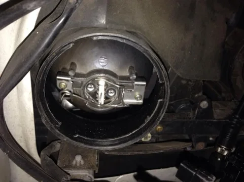

My brother owns a 2005 LX470. He has a lot more disposable income than I do and he wanted me to research how to have better headlights. I did a small amount of homework (evidently not enough) and purchased a set of Lifetime LED 9006 and 9005 from Southeast Overland. I assumed they were plug and play.
I looked on Rockauto and typed in 2005 Lexus LX470 and it called for High Beam is 9005 and Low Beam is 9006 replacement bulbs. So I called Steve at SEO and ordered a pair of each in LED. I went to install them last night and ran into a problem. I got the high beams in but the low beams don't appear to be anything like a 9006 bulb. WTF?!!
I am going to attach some pics and ask for any advice on how I should proceed. Did I just order the wrong bulbs? Has his truck been modified prior to his ownership? I'm baffled but then again it really doesn't take much to baffle me :confused:

No idea as to the '05, but my '01 has H1's as low beams.

This may sound silly but you do realize that the high beam is Not the projector lamp and that the high beam also acts as a daytime running light using a ballast that halves the voltage to the light during daylight operation, concern with this is how will an LED bulb react to a voltage reduction during daylight operation? I'm interested in this as I have added HID's to my projector/low beam and I still can't stand the orange light that the high beam displaces during daylight running mode!

I am the one that sounds silly. I should have done more homework on this before pulling the trigger.
I do realize the high beams are not projector lamps. I did not realize that they pull double duty as the DRL's. I installed the 9005 Lifetime LEDs into those sockets last night and my brother was very pleased with the light output. Now that you are telling me that there is a ballast that effectively halves the voltage, I have no idea how the LEDs will react. All this new information just makes me want to drop some F bombs!
The good thing is that if they will not work in my brothers Lexus, I have a 2001 LC and a 1992 LC that they probably will work in. I know neither one of my trucks has projector lights.
So can anyone say definitively if the half voltage is going to ruin these lights? Also, can anyone give me an idea how I can upgrade my brothers lights to a brighter whiter light and still be plug n play?

Thanks for your business and sorry you are having issues with your high beam headlight install. I checked Sylvania's website and it calls for a 9005 for high beams so that checks out - and it calls for an H1 for low beam so that might be the issue. We don't have H1s available currently but will in March. Just hollar at us at Sales@SoutheastOverland.com if you want return those headlights. We will give you a RMA and get them headed back our way, postage paid. We can either give you your money back or send you a pair of replacement H1s when they are available.
