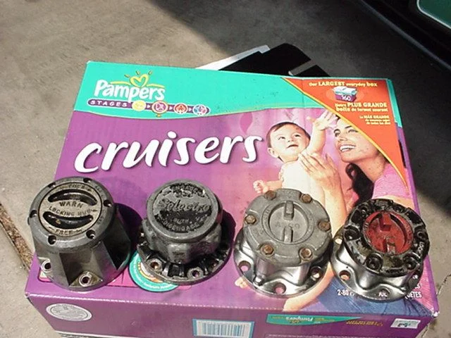

I'll try to make it simpler-here's how I understand it: Hub wise there are two different flavors. Short body and long body-see the picture. Your hub needs to match the axle stub length on your birf. 76-78 vehicles came with long birfs, so you need a long body hub. They exist, but they are not common. That would be the simplest thing to do.
An alternative would be to find short birfs and short body hubs and replace them all. These are widely available. The problem is that these short birfs are also slightly fatter so you would have to take a grinder to your axle housing to get them to fit. Not a big deal, just more work. And if you were going to the trouble to take your birfs out, you're going to want to rebuild your knuckles. And now your broken hub becomes an even bigger, dirtier, more expensive job.
I would see if you can find some long body hubs.

Selectro/Dualmatic are good hubs and should be serviceable.

You don't need to cross your fingers. Those old hubs won't work for you.
I was trying to make the story simpler by leaving out the part about earlier hubs and birfs.
Old drum brake birfs use a different spline count (coarse) and newer 76+ use fine splines.
Again, you have to match the spline count to the hub. So old hubs will only work with coarse spline birfs.
You need 76-78 hubs. On MUD they are usually referred to as 'long body' hubs. There was a pair listed here in the classifieds this summer. I don't know if they sold. These are just like the ones on my 78.

Or you could rebuild your hubs. Or you could rebuild the one hub while you look for a pair of long bodies.

Those long-bodied Aisins also come by the name of Asco. If it were me, I would swap those out for Warns until you decide to do an FJ60 knuckle swap, where you can then go to the short-bodied Aisins which are found on FJ60s, late FJ40s, and early minitrucks.
