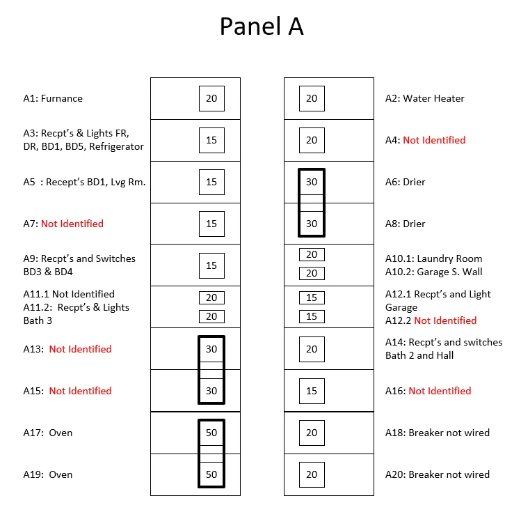

Thanks. Just a quick update. I removed the cover plates from both sub-panels. Panel A has two breakers without any wires and Panel B has five (this includes the 50A 220V breakers). I turned off those breakers that don't have wires. That leaves me with six unidentified breakers on Panel A and one on Panel B. I'm going out of town tomorrow, and when I get back I will continue the investigation.
Breakers without wires are likely safer than wires leading either to someplace unknown or to disconnected ends...
