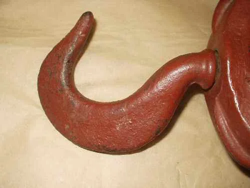

    I have a 23 year old More Power Puller (We called it a Red Devil).
    This thing has been through hell and back and still works perfectly. Just last year I ordered parts to spruce it up and make it safer. After years of hard use the frame hook had actually started to straighten out! See first Pic.
    The Wyeth-Scott Co. Established 1906
    I ordered a new 20' 5/16 cable for the spool with a new hook and reel attachment, an extension cable with pre-crimped ends, new frame hook, and a new handle. See second pic.
    While no replacement for a real winch, they are far more versatile. I use it for many other things besides getting unstuck. They are great for winching vehicles onto trailers, loading large logs onto trailers and the last thing I used it for, lifting my frame up while I attached the front axle. I highly recommend this hand winch.

    Off the record....It will handle much more than the rated amount. The weakest point happens to be the the rear hook that began to straighten out in the above photo... The handle will eventually begin to fatigue and bend over, afterall it is aluminum.... that takes years of heavy use. As for a heavy vehicle, a late 70's Blazer converted to 3/4 ton running gear stuck in axle deep mud on a slope... It required 2 guys to move the handle on a single line pull (which was done to gain the required pull distance), the handle did not bend. I can't count how stupid stucks mine got me out of. It takes time but it will get you out... which is better than walking out.
