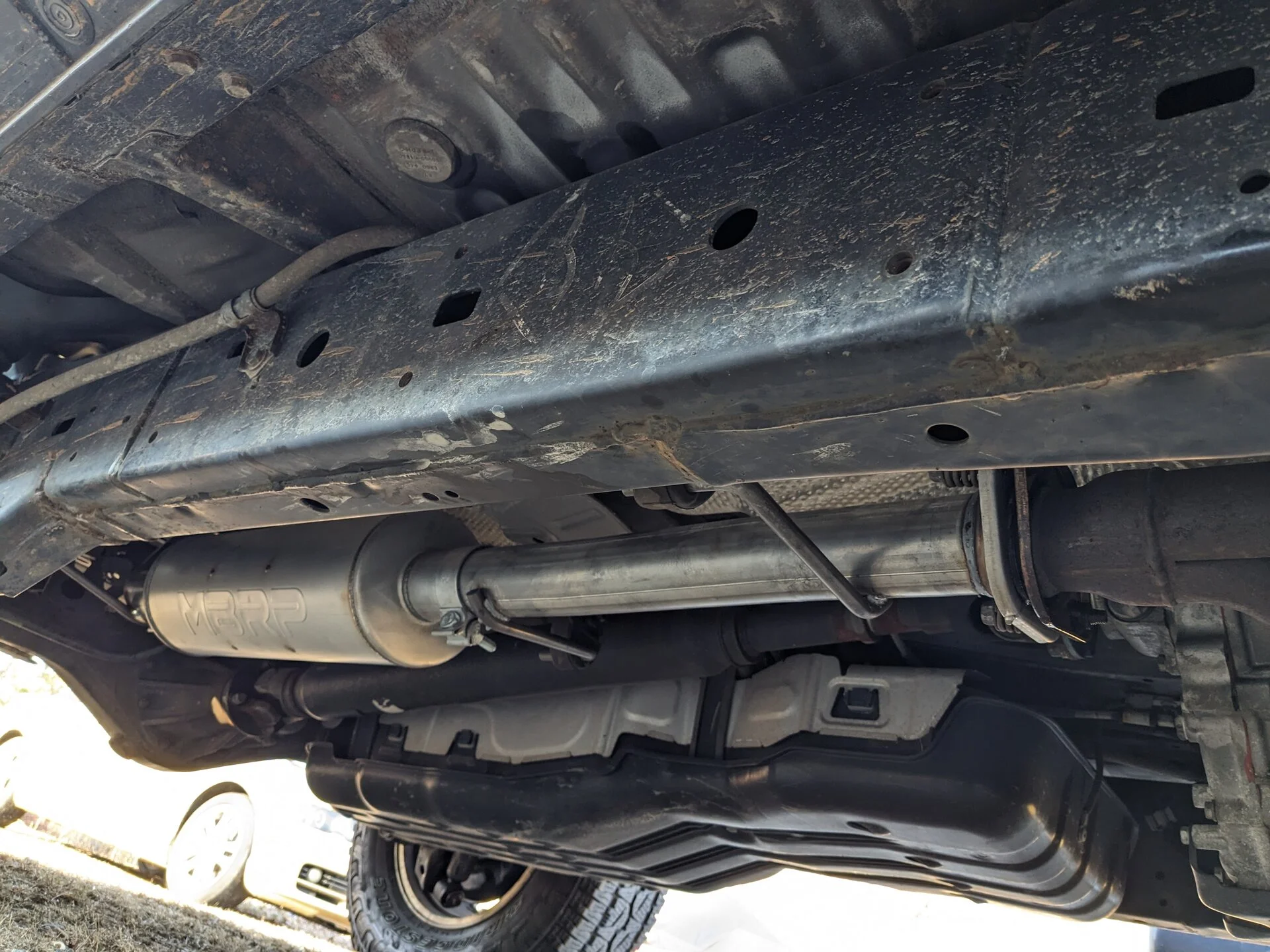

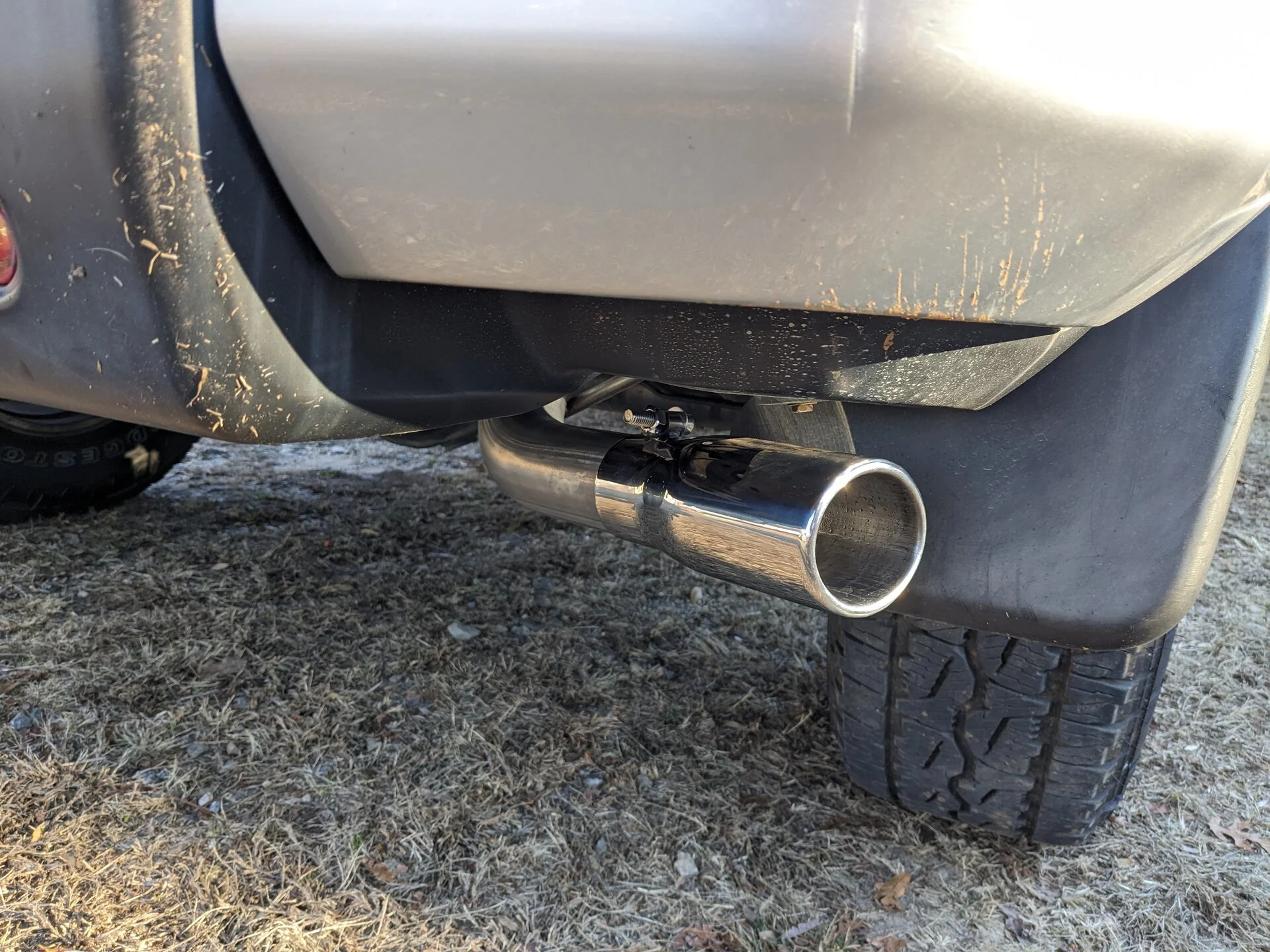

Somebody said you can gain up to 2 mpg with this setup, it definitely sounds better. I'll be curious to see if I have any fuel economy gains??? Doesn't really sound plausible, but we shall see.Looks good. I would crush that tip hanging out the back. I left mine tucked up against the frame rail in the back with a slight turn down. I need to replace my muffler soon though, as I can hear the innards rattling around in it.
I haven't gotten that far yet, this was just a fun mod. I'll prob do pcv stuff next and spark plugs. Then pull the trigger on o2 sensors depending on mpg and how they look.With those miles you’d see better milage improvement by replacing all 4 O2 sensors. You can get denso sensors from Rockauto for a decent price.
