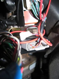

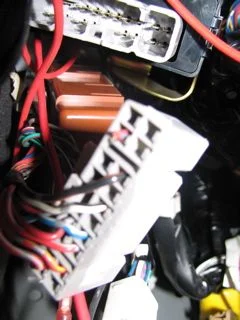

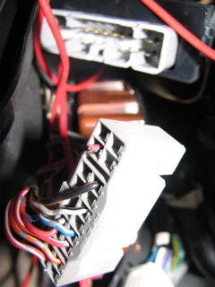

Pictures of DRL relay, connector, and wire to remove to disable DRL
lay down on and put your head on the brake pedal and look up underneath the steering wheel column, just to its right. in the mess of wires and to the right of the brake pedal metal assembly (looking up at it) is a black box mounted with a connector on its base. you'll be staring at it. reach up and disconnect the squeeze connector and locate a solid red wire with blue stripe. disable or remove this wire and your DRLs are off. On my pictures it is the only disconnected wire on the connector. if u keep your light switch on Auto, lights will still come on automatically when the detector on your dash senses darkness, etc. hope this helps.

pequiod is offline   Reply With Quote
