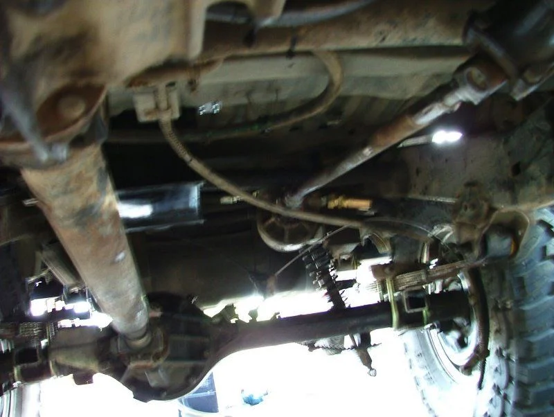

I had a custom built one that was about 2.5 gal that sat between the fender and firewall of my lhd bj70 but when I moved everything over to the rhd bj74 it wouldn't fit so I just stuck a plain old 2 gal reservoir under the floor just under the back seat and it has been fine. If you aren't running rams (even though an onboard woodsplitter would be cool) you don't need much capacity. I could probably use some cooling but haven't got a temp gauge and ignorance is bliss.
You can sorta make out the pump on the right side and the reservoir on the left in this pic...
attachment.php
