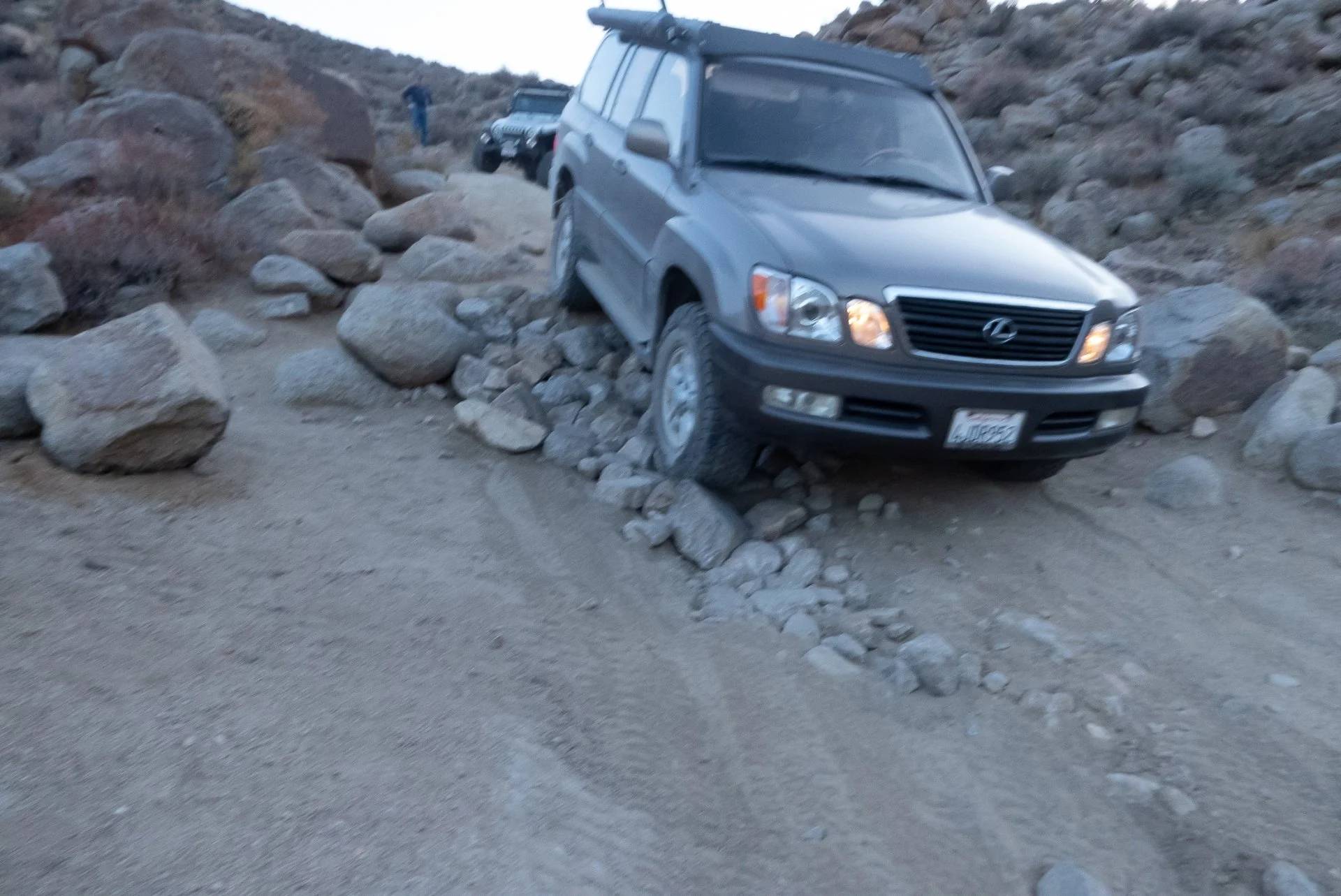

My LX friend on Top of the World trail. Its a level 6 trail, again his rig has stock gears, no lockers.

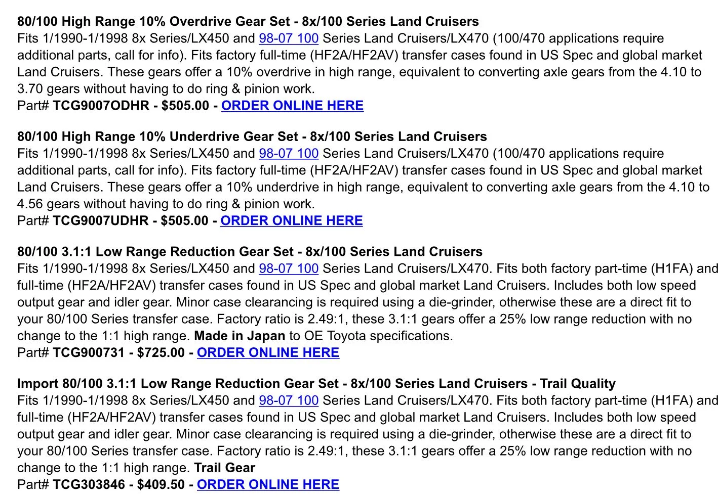

New options in stock :cool:
10% overdrive and 10% underdrive high range gear options for the 1980-1990 (and later non-US) Split T-Cases. - $350/set
These work WITH your existing idler gear and low range output, so you replace the input gear and the high range output gear to offer either a 10% underdrive or 10% overdrive in high range only. As the low range gearset is also driven by the input gear, this does alter the low range accordingly. These are a direct fit into a 86-90 38mm t-case. They can be used in the 80-86 34mm t-case by using the 86-90 idler gear (with conversion parts) and low speed output gear. Please call for pricing/options on the 34mm variants as we don't have these in the computer yet.
PART# TCG8690UD
PART# TCG8690OD
Kurt, will these (specifically the Overdrive set, TCG8690OD) work in conjunction with 3:1 low gears (TCG869031)?
Could one have their high speed and low speed cake, eat it too, and for the same money as the 3.3:1 and 4:1 kits? I'm guessing there's a reason this isn't offered as a kit already, seems like it would be really popular?
