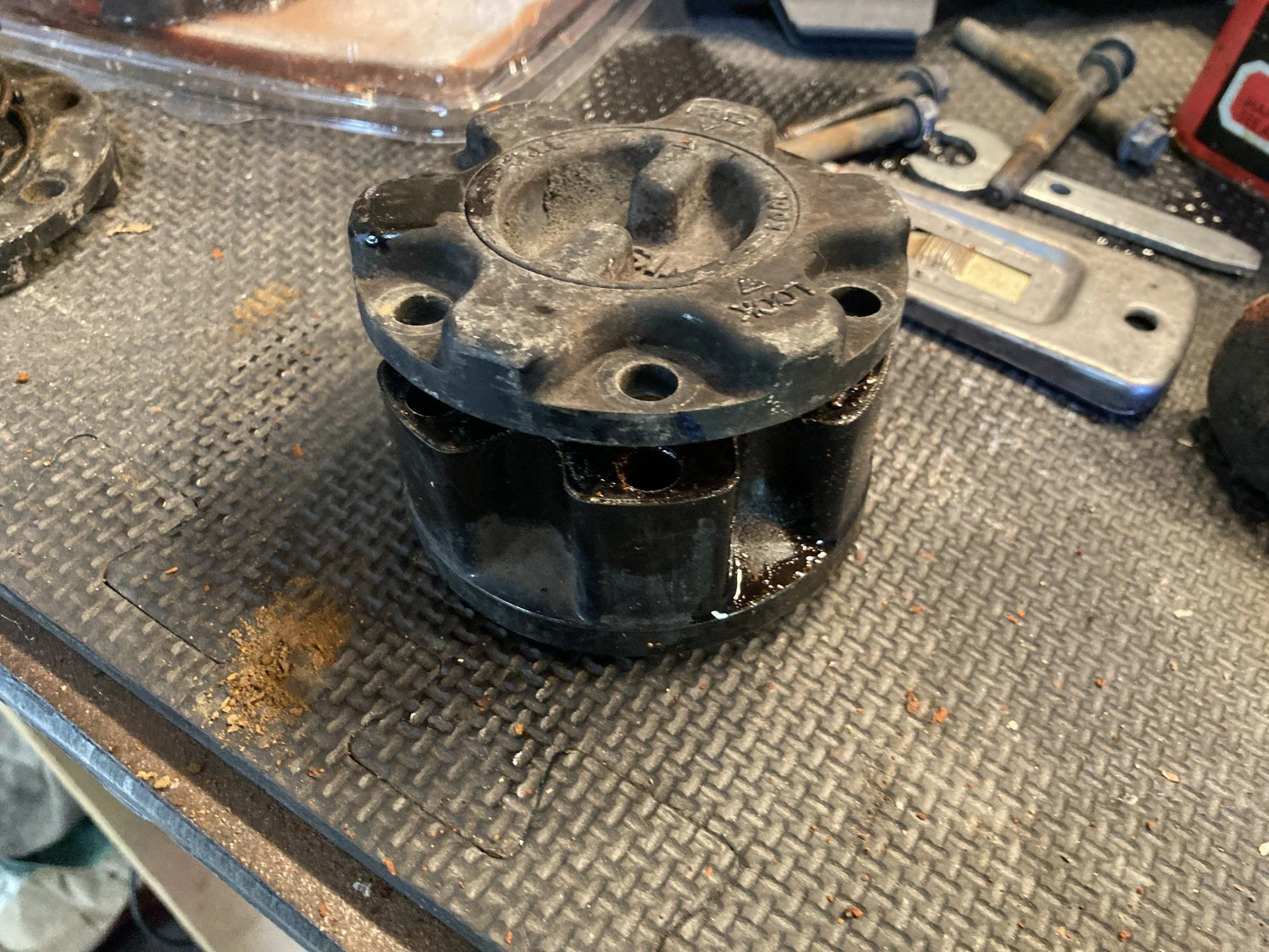

Maybe an old thread but hoping someone can help me identify these hubs. I picked them up hoping they'd fit my 2nd Gen 4Runner as they have a 26/7 spline count but they are way too small and have a different design than most aisins I've seen. They only use one set of bolts that run from the dial/cover through the body and into the hub. They are also way smaller than a toyota hub, even the axle diameter is smaller. Any ideas?
Looks like the older IFS Mitsubishi to me. There is very little carryover from one brand to the next, they all have different spline counts, profiles or depths. I can check at the shop and see if we have more resolute application data on that one.
Thanks cruiseroutfit. Still wish I could find another example of this style. Even the Mitsu's Iooked up have the 2 separate sets of bolts. Interesting.
