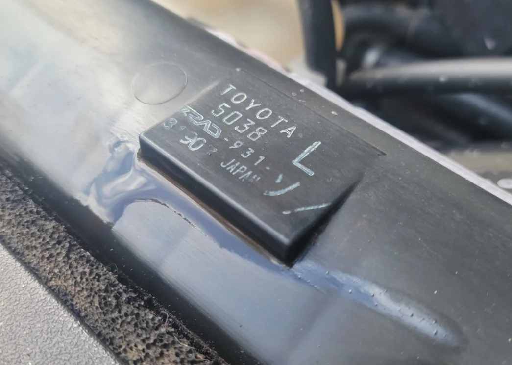

Yup, Radiator Crack.. 😢

Picture says 1000 words. Now what? JB weld until it fully goes?
No overheating, but slightly loss of coolant from expansion tank.
Where to order the replacement from?
Thanks in advance..
JBWeld works great if applied before it leaks. You can try but few have had luck with it sealing an existing leak.
Most parts sites won’t ship these large radiators due to risk of damage. Your best bet is probably to call around and see who has it cheapest near you. 16400-50384
Genuine Toyota is now an updated part to address the crack and better than anything aftermarket.
I got mine from Lexus in Arizona shipped to me, but I had time to wait for it as I replaced before it cracked. BellLexusNorthScottsdale.com
