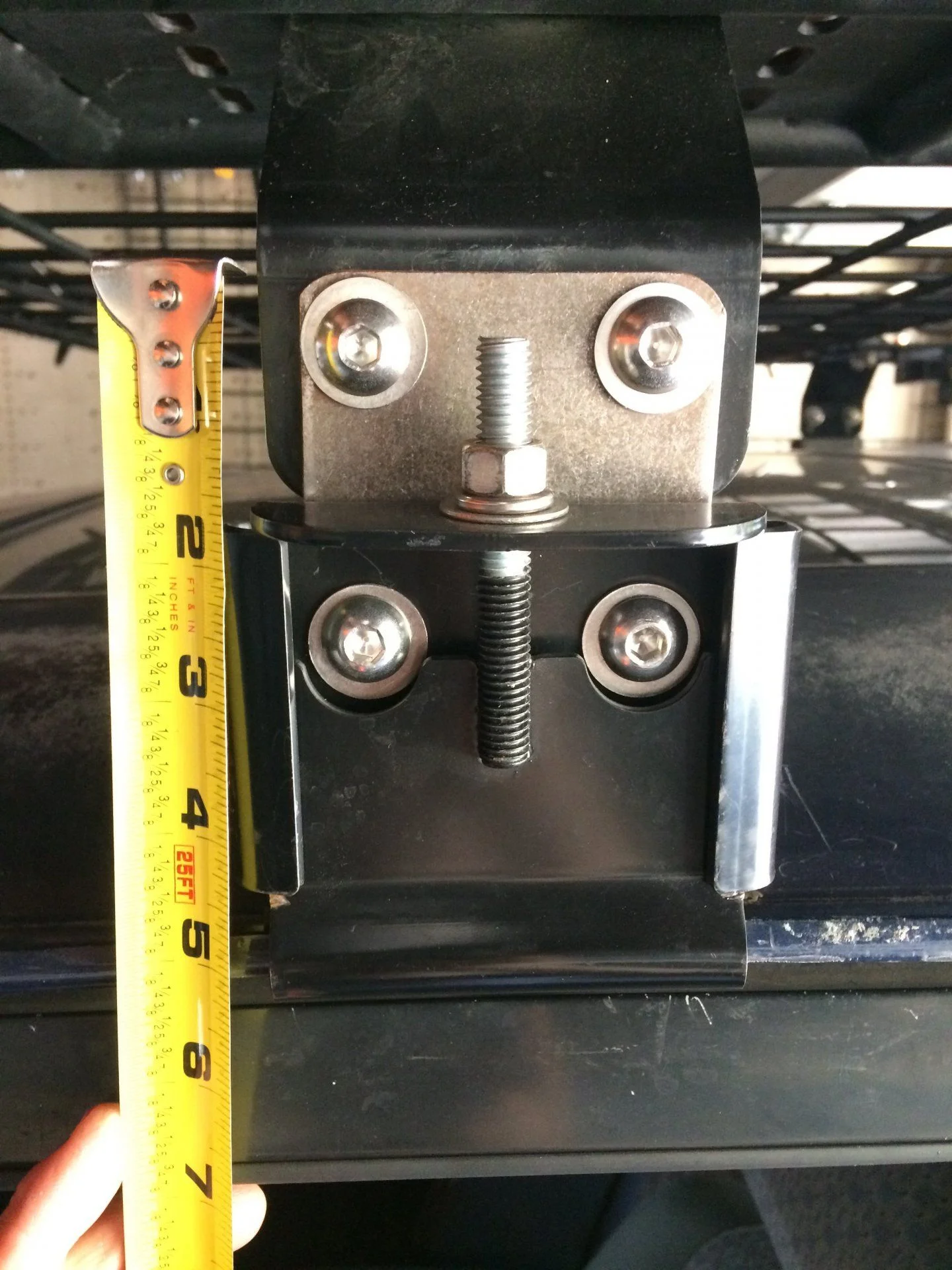

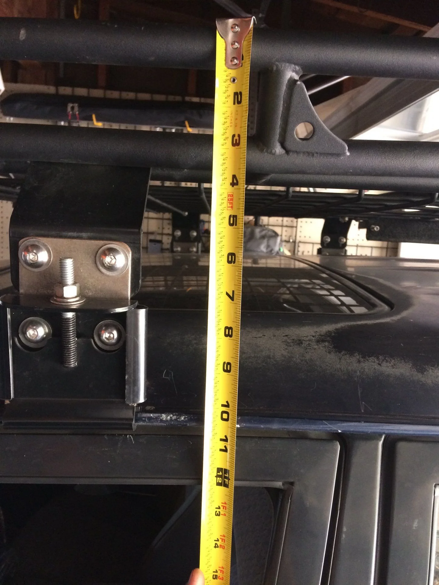

I measured from the roof gutter to the highest portion of the rack. I have these spacers that Tim made for me, so subtract that distance accordingly.
With the spacer it's 10.5" from gutter mount to top of the rack. The spacer raises the rack an additional 2". So without the spacer, I would say it's 8.5" from gutter mount to top of rack.

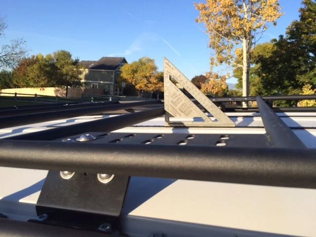

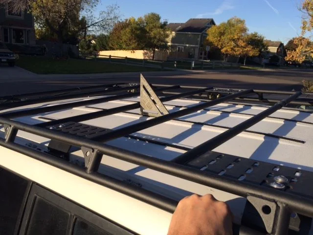

there's only about a 1" gap between the bottom of the cross bars and the roof... no more. Add an Expo bar and you're adding roughly 2.5" to the height. So total height from the center of your roof to the top of a raised Expo bar in front (non-tapered) is right around 4.5". Here are some pics of the center of the roof, showing the 1" gap below the 1" diameter tubing.
