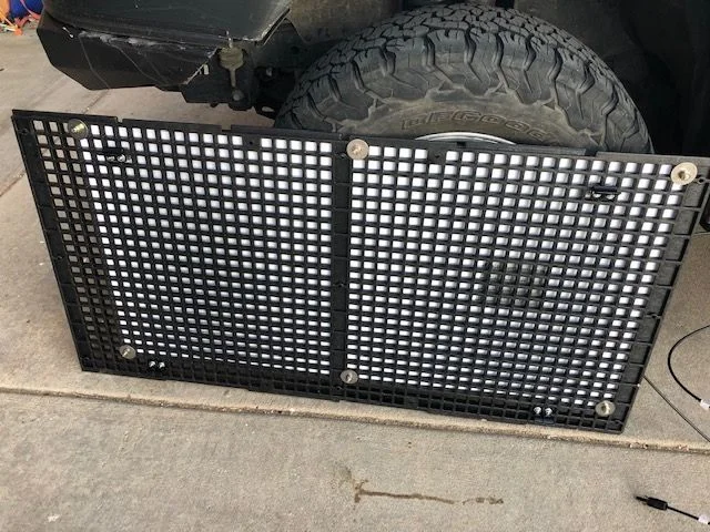

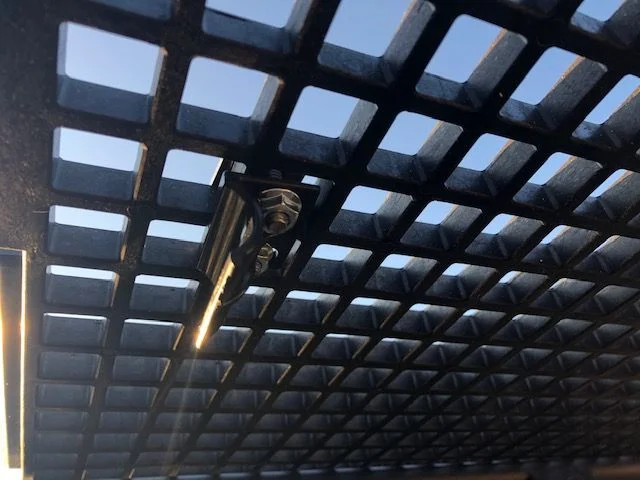

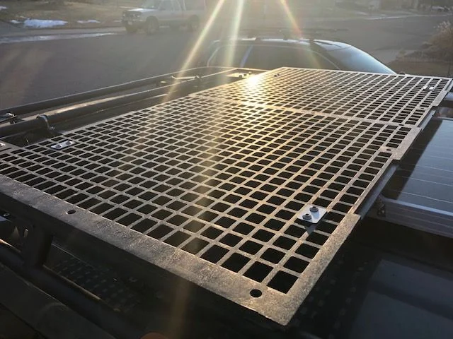

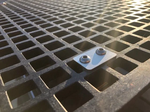

@guardcompany alright here you go... as mentioned we take a plastic grid panel Grid Panels — Gamiviti then add some of the plastic fairing clips Fairings — Gamiviti. The new backing washers work really well for the top side, I'm using some flare nuts with teeth on them for the plastic clip side which makes tightening really easy, don't need a wrench for the nut. For this mockup I used 4 clips, and it's pretty decent, if we did 6 it would feel really secure. I might add a little velcro leash or something, just in case (think snowboarding in the 90's) or just more clips, pretty easy to experiment.

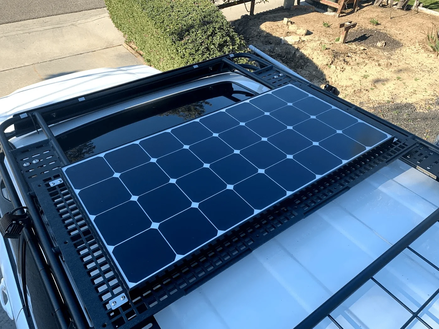

Then bolt a 110w flexible solar panel to the grid panel. Solar — Gamiviti I realize it is not centered, whatevs I need to give that panel to someone else tomorrow anyway.
So then the whole assembly just snaps onto the rack.
The advantage here is you're able to unsnap it in seconds, then tilt it towards the sun (or even move it into the sun, if you have extra cable). Again if you turned this 90 degrees it would even fit inside the tracks of your RTT. It's freezing out here... so gonna mess with this some more when it warms up a bit but hopefully this gives you some ideas. what do you think?

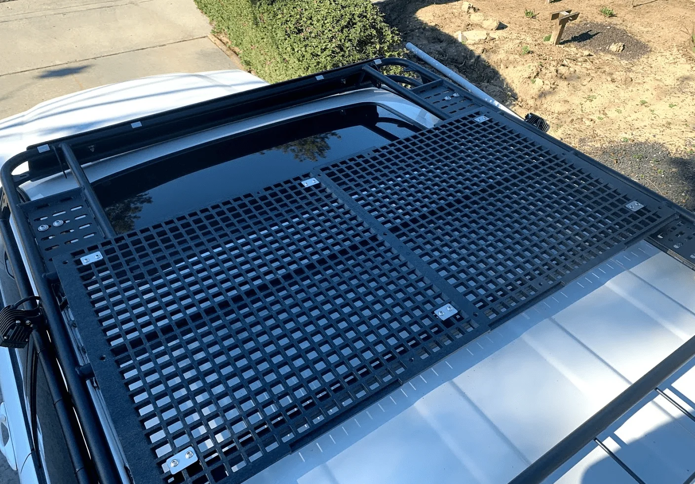

Is that two grid panels or one? I love it!
That is just one grid panel. Also ignore the other solar panel below the rack...
Awesome. I’ll be ordering the panel and clips today. Need to get this thing mount before a trip at the end of the month.
Side benefit of the grid is you get some airflow under the panel when parked. Solar panels lose efficiency as the cells get hot, so airflow under them makes a big difference in output when your in the desert

Love the grid system with the solar panel. Video if the snap clips on my instagram here:
