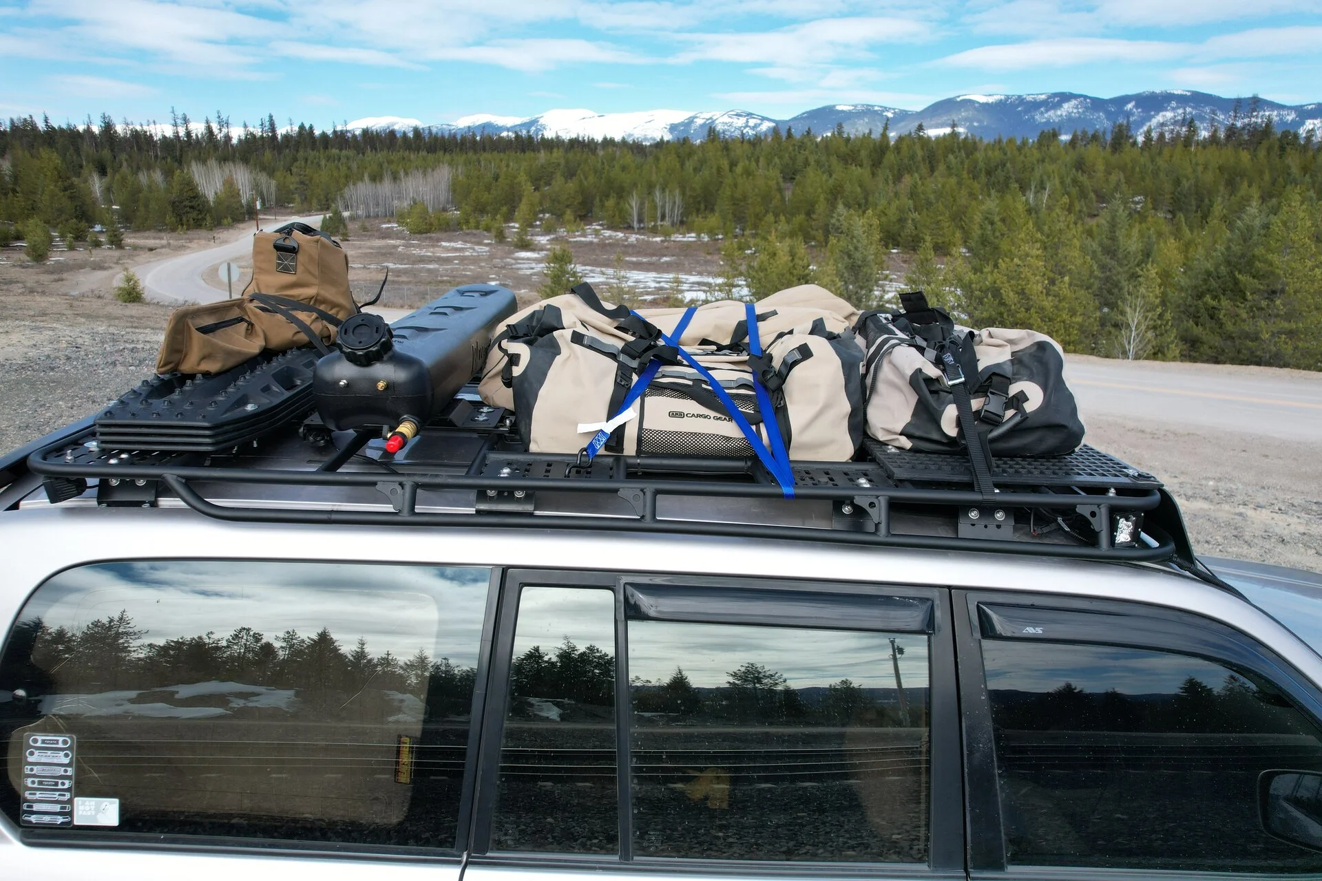

Securing cargo - yes I’d agree that the side rails are not necessary. Probably just my wanting that peace of mind that’s irrational. My cargo will be big coolers.
Grab bar - Am I missing something or is the only real use of the expo bar as a grab handle then?
I’m 6’ so would be comfortable reaching the side of the main rack to grab onto and I see there are openings there one could use. Just questioning if I need the expo bar at all then?
Drop basket - I’ve got a question in to Tim about this as I wonder if there’s room to do a drop basket is there room to simply lower the whole rack?
Definitely appreciate the fast, attentive customer service, which is most refreshing.

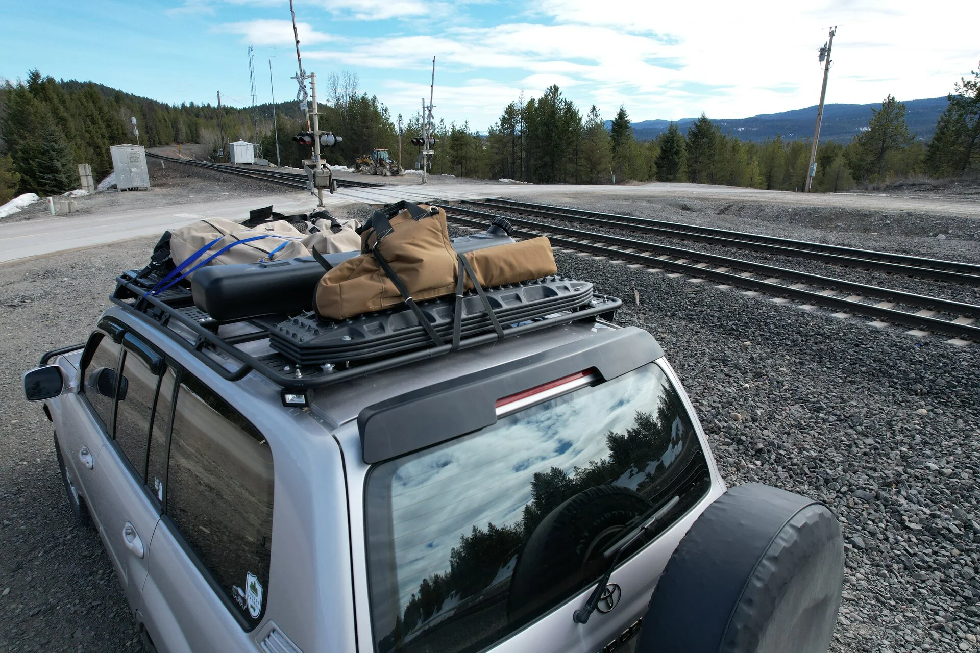

Another consideration with the expo bar is you can add the gusseting which provides another location for a ratchet strap or even a place to hard mount items like shovels/traction boards/lights on the edge of the rack.
For me the gussets have been useless. Every ratchet strap hook I try ends doesn't really sit right. Same for all the light tabs, had to open them all up to get aux lighting mounted. Not trying to complain, just if I could go back I probably would do without them.
Can use the expo bar or rack to wrap a strap around and keep everything just as secure.
But hey that's just me, the beauty of these racks is you can custom design it to meet your needs.

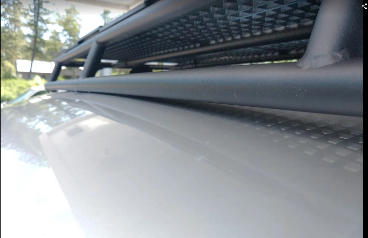

The drop basket might require the rack to raise 1/2" at most, compared to without it. In most setups the middle set of towers are as low as they can go, which provides about a 1" gap between the cross bar and roof in the center... agreed with @Mike NXP that if it were any lower it would be less useful. But that drop basket only hangs about 1" below the rack surface, so you set it up just high enough that it can't deflect & rattle against the roof. If you want the lowest setup possible then yes forgo the drop basket. You could also do the non-tapered Expo bar and that would allow the front to be maybe 1/2" lower also. Not going down a few inches though, every variant is about the same height, and in general within 1" of the factory cross bars.
As for the gussets I also rarely put a strap into them- they're more for quickfist clamps, so adding shovels, hi lift standards, etc. But on those occasions where I have a wide mattress or something it's nice to reach under and put the hook in the gusset. All other times I just wrap the strap around the bar then hook it to itself.
You can get that sucker pretty low even with the middle drop basket =]
I've since raised mine an inch or so because this was too close for comfort but pic below just for reference. At this setup I had no wind noise at all which was nice but when hammering down washboard roads I was worried it would start to damage the roof there.

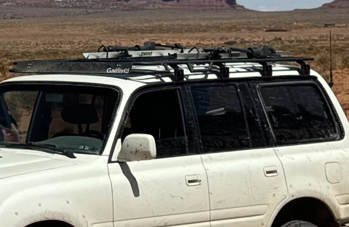

Anyone out there have bike mounts on their Gamiviti rack ? Curious to see pics on how it all syncs up with the rack
** disregard , found this thread. But still hoping to see some pics of the bike mounted up . Tims dark garage pics leave a bit to be desired =]
Either way, awesome to know it's possible.
Now that is classy, I sort of wish I had a trailer hitch for stuff like this but I don't really ever want to remove my rear bump bolts again . One of two of the welded nuts in the frame may be on the fritz.

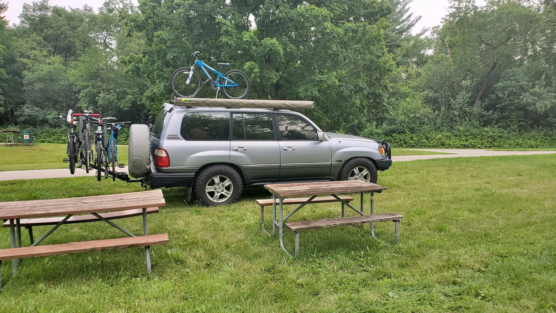

Looking forward to throwing a bike or two on the roof. Might just lay em down, strap em up, and gopher it.
Hey, that was like 12 years ago! you just need bike racks that sit on top of the bars, then clamp them down. Older Yakima stuff seems to work well for this.
also, welcome to Utah
Will the drop down basket be an issue, I feel like you may have warned me about that when I first decided on it.
Yeah, you may wish you had one of the bars that were removed for the drop basket for location... as not all bike racks are long enough to span it. the work around is moving the bike rack outside of the basket, or forward/behind it, or putting the bike rack up on bolt-on cross bars above it.
ah yeah, that's right....or, I just throw my bike up there strap it down and move on =] All this fancy crap is taking over.
