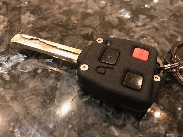

Initially, the ss hardware was just a little too shy to engage the nut threads...I had to use the black hardware first time through to get the stack up to marry. After a few days (of the stackup being compressed) I removed the black hardware and used the ss hardware. This time the ss threads engaged the nuts and the key is even more cool than before. A+
Wife loves the key, so happy life!
Initially, the ss hardware was just a little too shy to engage the nut threads...I had to use the black hardware first time through to get the stack up to marry. After a few days (of the stackup being compressed) I removed the black hardware and used the ss hardware. This time the ss threads engaged the nuts and the key is even more cool than before. A+View attachment 1539433
Nice! Good tip! That probably explains why my tester worked so flawlessly. I used black hardware first, then switched to SS after a day or so and had no issues. It's such a small difference I could see the plastic compressing just enough to get that tiny bit of extra engagement needed.
FWIW, I revised the plastics after that first batch so most folks receiving fobs going forward should have good engagement right out of the gate.

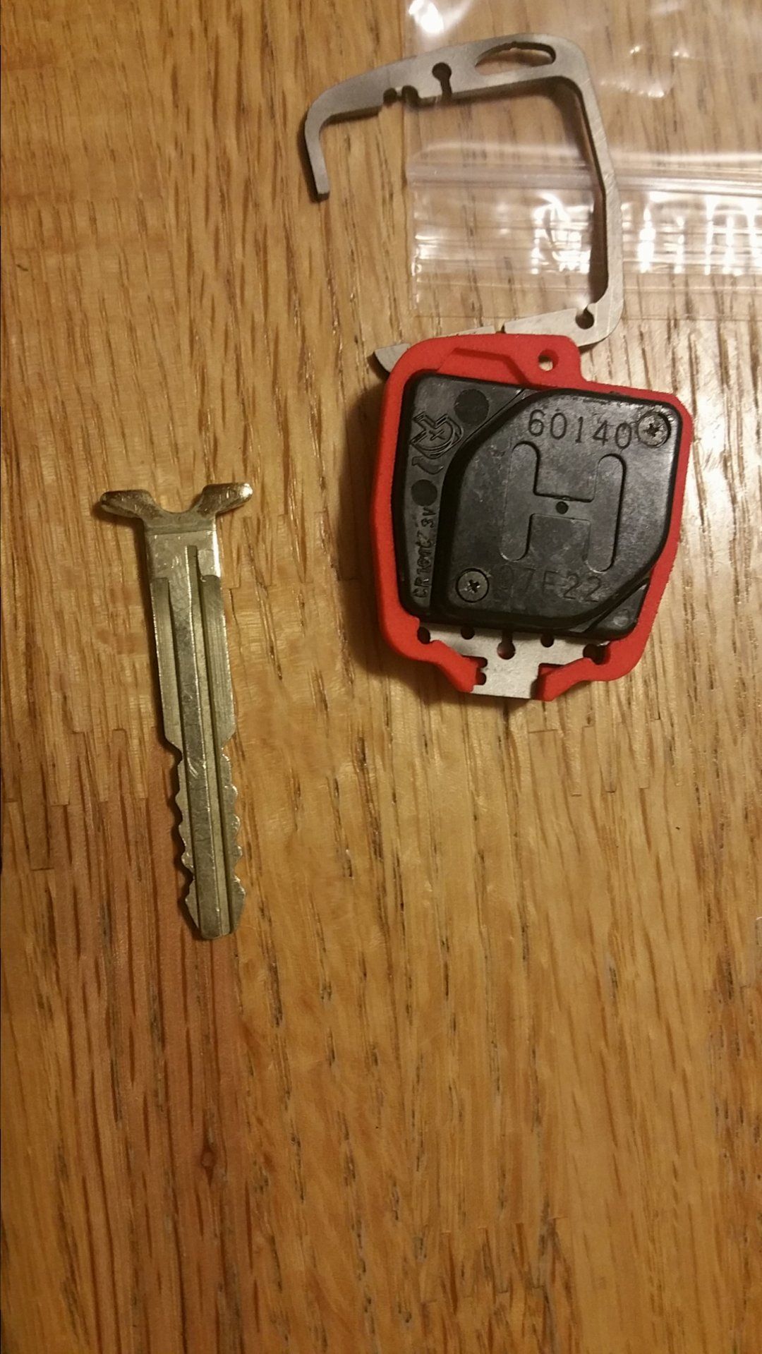

Finally got the key in today! Not the USPS's finest hour. Looks great!
And of course I'd have one of the wierd keys... :|
Shout out to Andy (@suprarx7nut) for prompt response and fix for my issue. His commitment to a quality product and customer satisfaction is impressive. I have already had a positive comment on the key.

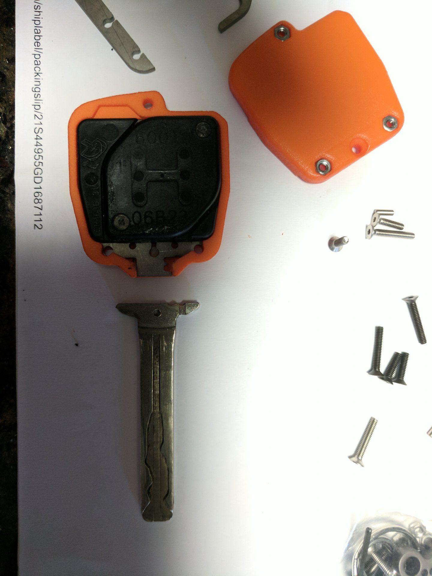

Mine is an odd ball too. The blade flares out just a bit before the T, enough to cause an interference fit on the housing. I don't want to stress the plastic so I'm going to file the blade enough to fit.
Otherwise looks great!
Hmm... That's bizarre. Don't suppose you can snap a picture of the interference? If you've got calipers to measure, that'd be even better, but I realize that's a long shot.

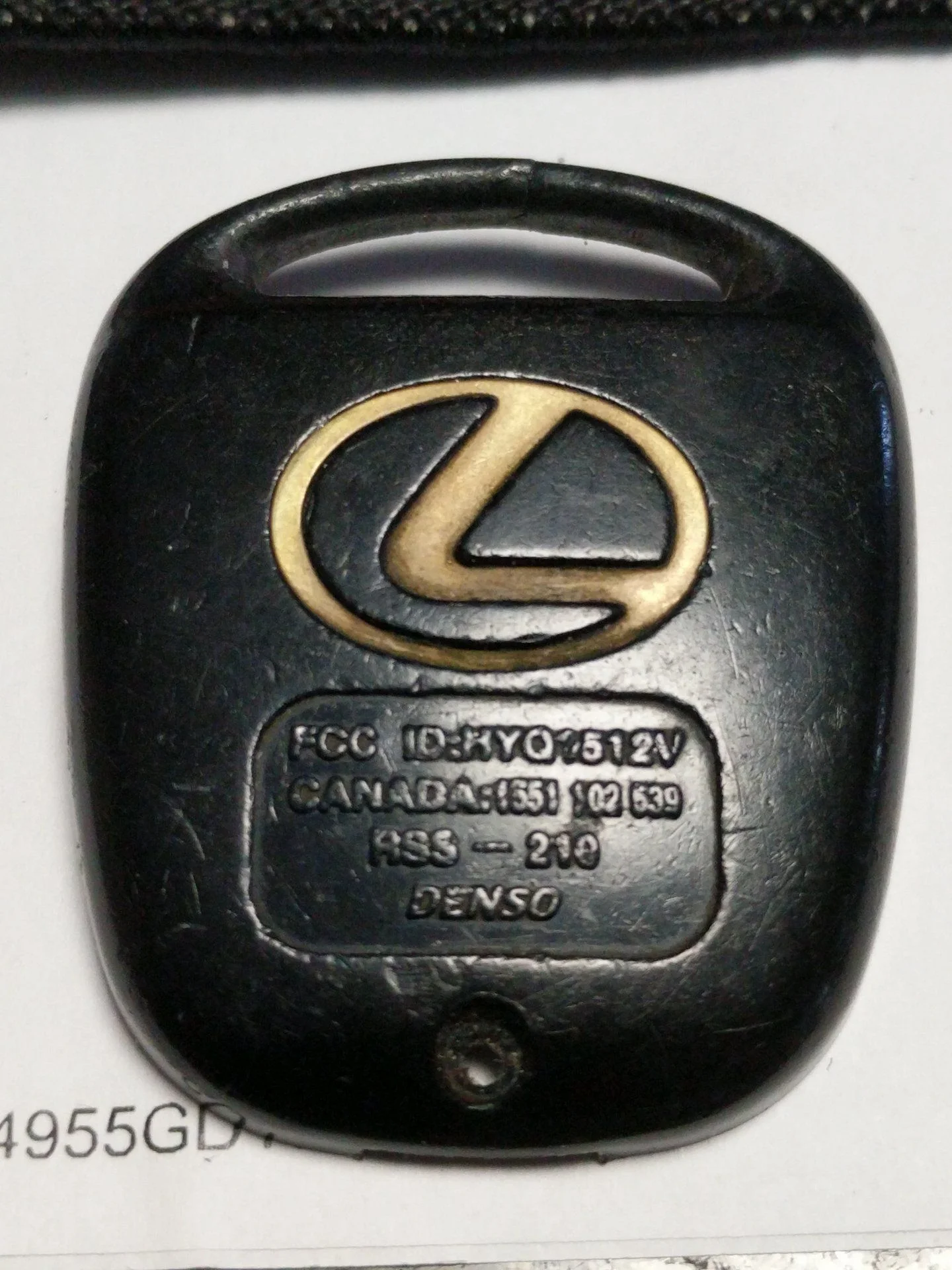

Just had to knock a couple thousand the off each side of the blade just below the t section. Here's the back of the original fob. It's the only one that came with the truck.
