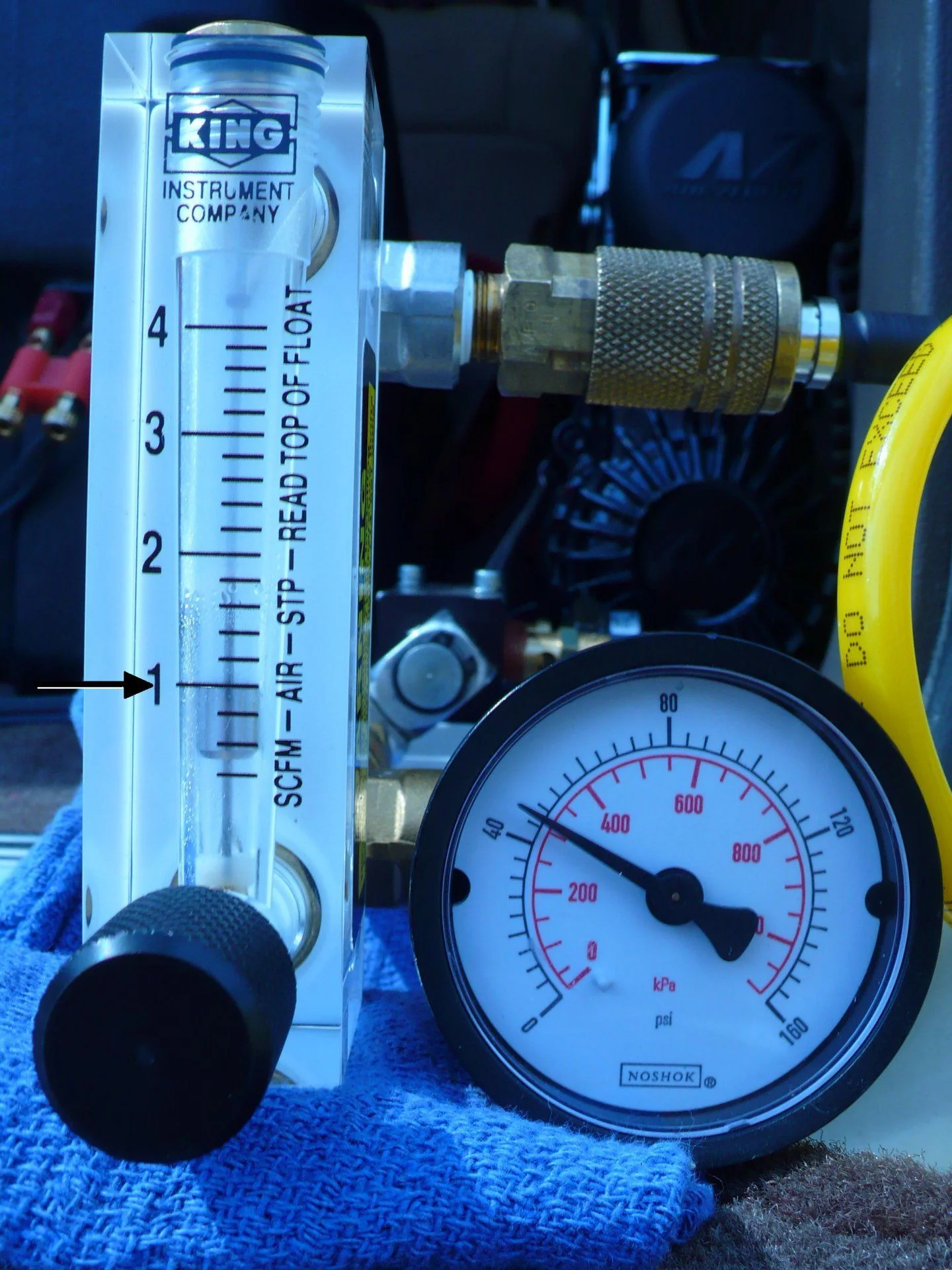

Has anyone else measured the the actual CFM output from their compressor? The manufacturers make some impressive claims, but we know the only useful data is the actual air-up time. But what is the true CFM?
I'm happy with the performance of my Air-Zenith. With the engine running at 1000 RPM & using 25' of 1/4" hose, it takes a 33" tire from 25 to 40psi in 1.5 min.
But would you know?...that's only about 1CFM! (Here at ~45psi)

I wouldn't mind one of those flow meters but at $300+ ugh :(
