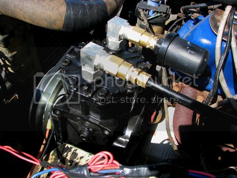

I have all three options you are considering. In my FJ40 I have a redundant system with an ARB electric compressor and also a York, both of which feed into a 2 1/2 gallon reserve tank. Years ago I just had the ARB compressor and reserve tank but it just wasn't fast enough to quickly fill tires. I added the York and it works great.
In my FZJ80 I keep a 10 lb C02 tank. It works well, but I still plan to add a York. The York has the advantage of unlimited air, so I'm more willing to break out the air tools on the trail which speeds repairs. You don't have to worry about keeping it filled or forgetting to pack it (which I've done with the C02 tank). The York is always there. It is reliable. It doesn't take up storage space.
If you or a buddy has a welder it is fairly easy to make a bracket, add a pulley, and mount the York. The rest is simple plumbing.

Now on the York side I have decided to go with LUMPDOG's York bracket...if he can ever finish it :P. And then getting a shiny "new to me" York from APPLETECH. This will then be going to a VIAIR 5 gallon tank and then all hooked together. My question now is what do people run for the hose to the tank AND what about running to the bumpers for quick-disconnects? I was thinking of using Semi truck brake hoses but no idea where around here I could find that stuff. Any other ideas?
Sounds good. Fuel line it is. And here I was worried about getting air-brake hose :P
Type B air brake tubing is not hard to find.
Any large truck/trailer shop will have it. I imagine your local NAPA has it or can tell you where to get it.
Keep it away from headers and exhaust components and you'll be fine.
I used it on my Early Bronco in 3/8" and have 1/2" sitting around for when I do the Cruiser.
