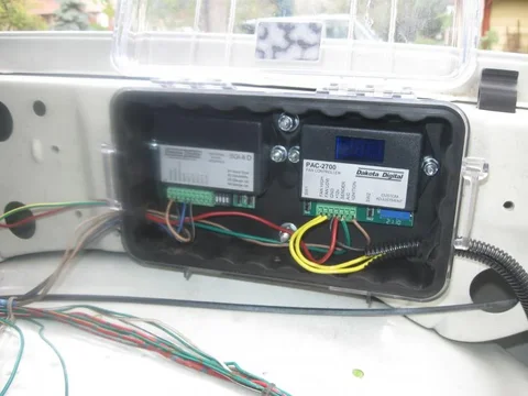

here is the installed fan with the controller box mounted on the driver side fender well inside a pelican case (top left of picture)...
the controller on the left is for the tachometer interface (changes the 6-cylinder tach to accept 8-cylinder signal) and on the right is the fan controller. it can be set up to run both fans simultaneously or individually. you program the high and low temps that you want each to come on at and indicate the type of gauge/sending unit you're running. it also has a function to control the length of time to keep the fan running after engine shut off.

I like the dakota stuff (at least from what I've read on their web site)...what's your take on the quality?
Does the tach interface feed an aftermarket tach ? How does it connect to the engine on your truck? My vortec has a tack signal coming off the PCM. Are you running the LC tach or aftermarket.
the tach wire from the dizzy goes to the control unit which converts the signal to interface with the Toyota OEM tachometer... not sure if it's different between the '60 and '62 but my tach shows revs up to 5K RPM... not sure if that's high enough for your Vortec!?
and, i'm sure you remember my alternator troubles... i went through two before i recently upgraded to a 140 Amp power master from summit. still have it wired the same way, but it seems to keep up with the work load better and should suffice once i get the second battery wired in.
i haven't had any problems with the dakota digital stuff. i did end up having to manually set the temperature between the control module and the gauge, my stewart warner gauge/sending unit didn't seem to want to read right on the fan control module. (you can hold down a button on the module and it shows the sending unit temp reading digitally under the hood) their tech support is pretty good too, always helpful.
Very cool. I'm getting ready to stab my TBI in for the last time too. How hard was the tach interface to hook up?
it was easy!... power & ground and then in from the motor and out to the tach... just checked out your threads... sweet rig!
