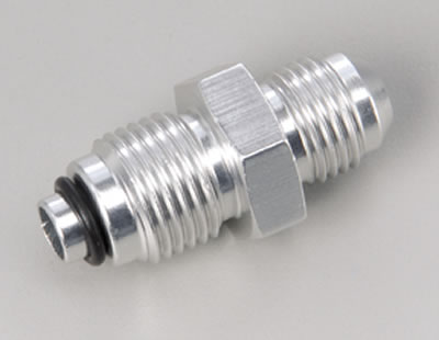

For the fuel filter, I would suggest using the filter that GM used. They used that filter on everything EFI. That makes them a common and not terribly spendy EFI fuel filter, $9 -$16 at Rockauto.com. They are a 10 micron, SS bodied filter that is fairly compact in size and can be mounted with a hose clamp if desired. There is one issue with them though and that is the fittings on the ends. They are the "O-ring Bump" style of tube fitting.
Absolute easiest way to deal with this is to cut the tube nuts and section of tubing off a junkyard car. Soft solder just the ferrule from a compression fitting onto the tube, and put the hose clamp further from the end of the tube than the ferrule.
Next easiest, works better, is more robust, but costs a bit more is to buy the AN adapter fittings and either some push-on hose ends or AN type tube nuts for flaring some tubing. I can post pictures of this tonight if needed. The fittings are a one-time only purchase, not like they need to be replaced when it's time for the filter to be replaced.
The adapter:
Aluminum: Russell Performance 648060 - Russell AN to Metric Adapter Fittings - Overview - SummitRacing.com
Steel: Aeroquip FBM2608 - Aeroquip AN to Metric Adapter Fittings - Overview - SummitRacing.com
