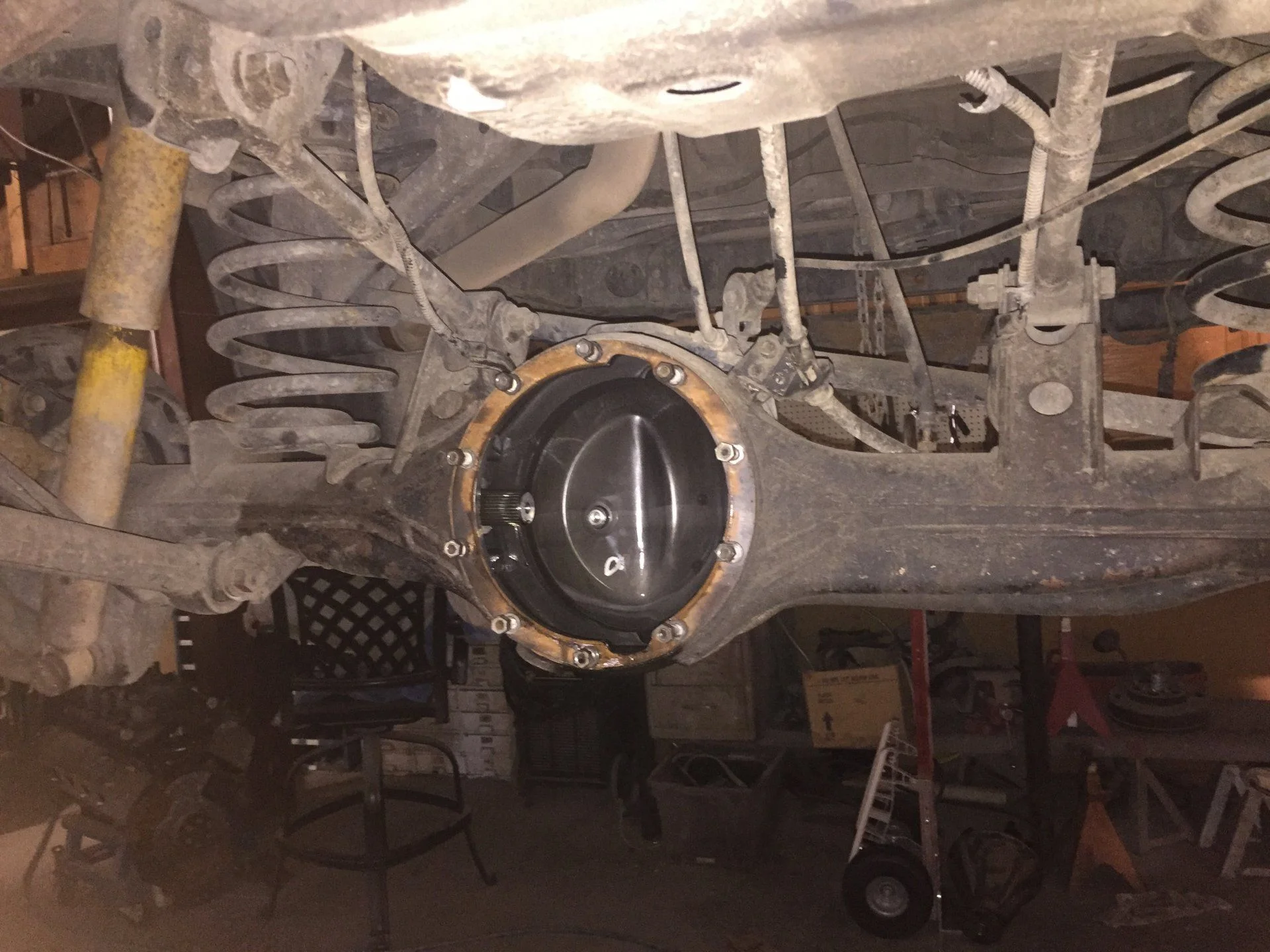

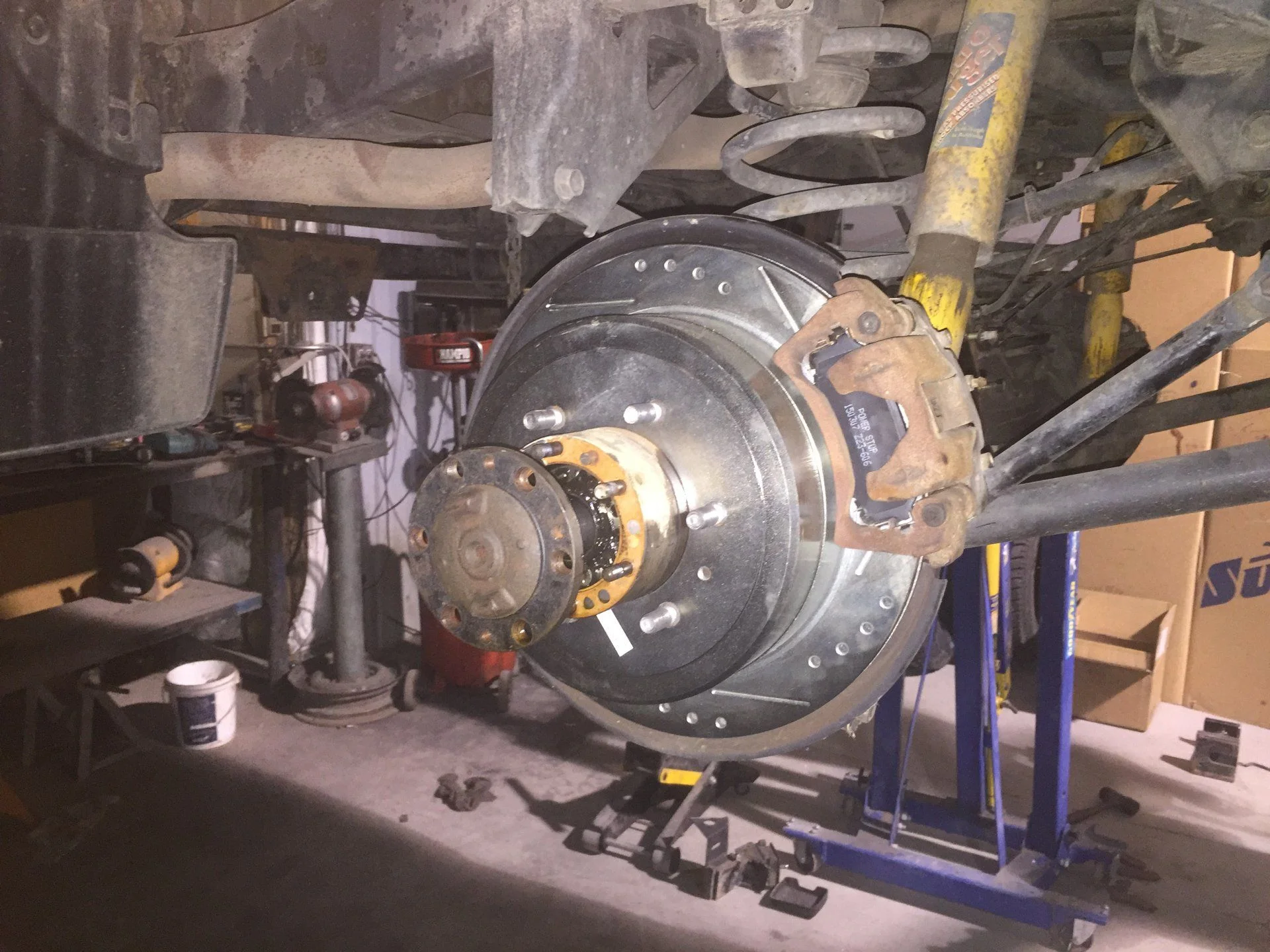

Broke down the rear axle getting it prep to install the new Detroit Locker. Also installed new brake shoes and new rotors. Decided not to replace the bearings. They look and feel great. I have a feeling these were just done not to long ago.
