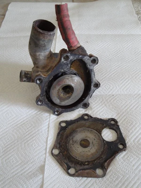

cruising along at 70 on the highway, a bit more noisy running than normal, and then a sudden SNAP - after which it ran quieter and smoother :confused:
luckily, I was on my way down an off-ramp - at the stop light, steam came out of the hood vents :eek: - radiator fluid all over :rolleyes: :rolleyes: :rolleyes:
never leaked in 6 years

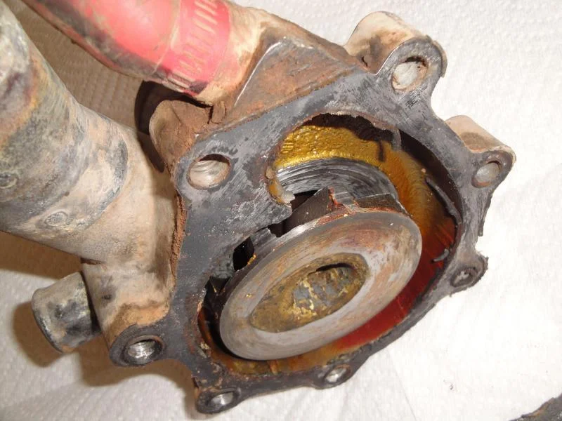

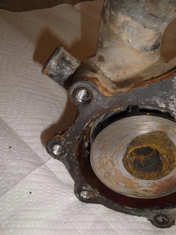

the second and third pic show scores on the propeller and on the inside of the housing, respectively - the shaft is moving around sideways and parts are rattling in there now :doh:
