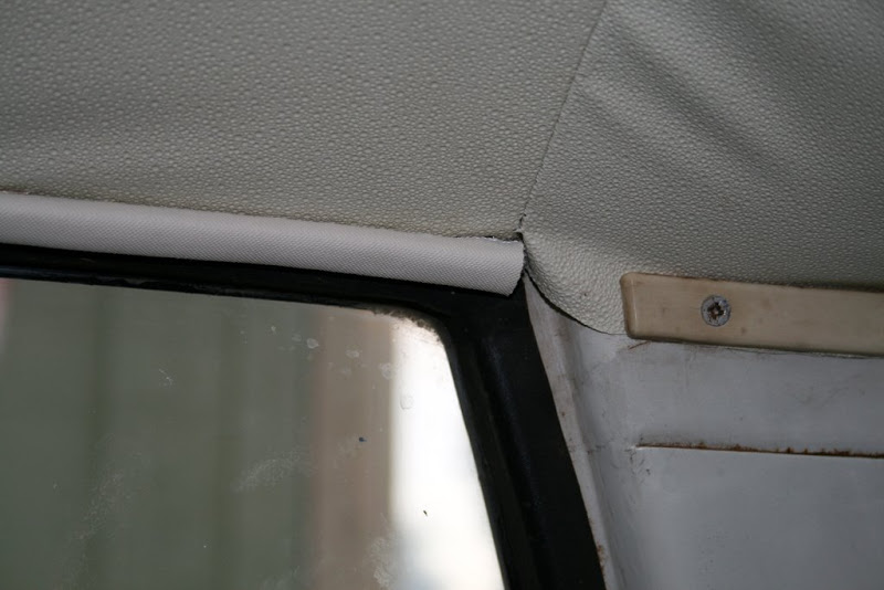

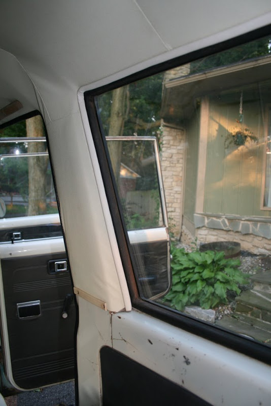

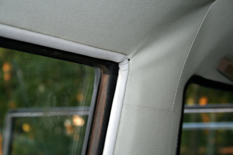

I looked at the situation and noticed that there is a metal ledge about 1/2 inch wide around every spot where the headliner tucks under a window weatherstrip. Seeing how Toyota used the white ivory strip to finish off the headliner in the rear, I thought that you could just get a strip of something flexible, drill a row of holes and screw it thru the headliner edges into the sheetmetal. So I told the upholsterer guy my idea, and he said he'd see what he could do.
He said he ended up attaching a tack-strip that he had to the little metal ledge - then secured the headliner to it, then covered it up. I am not an upholster so I don't know the details, but I'm guessing the tack strip had a cover of some sort built into it.
It does look good though- I would have been happy with a row of visible screws!
Photos:
If you had a 1/2 strip of something flexible, you could pull the headliner tight, and screw it down into the sheetmetal underneath - that's totally doable by one's self.
