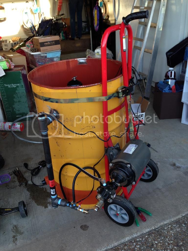

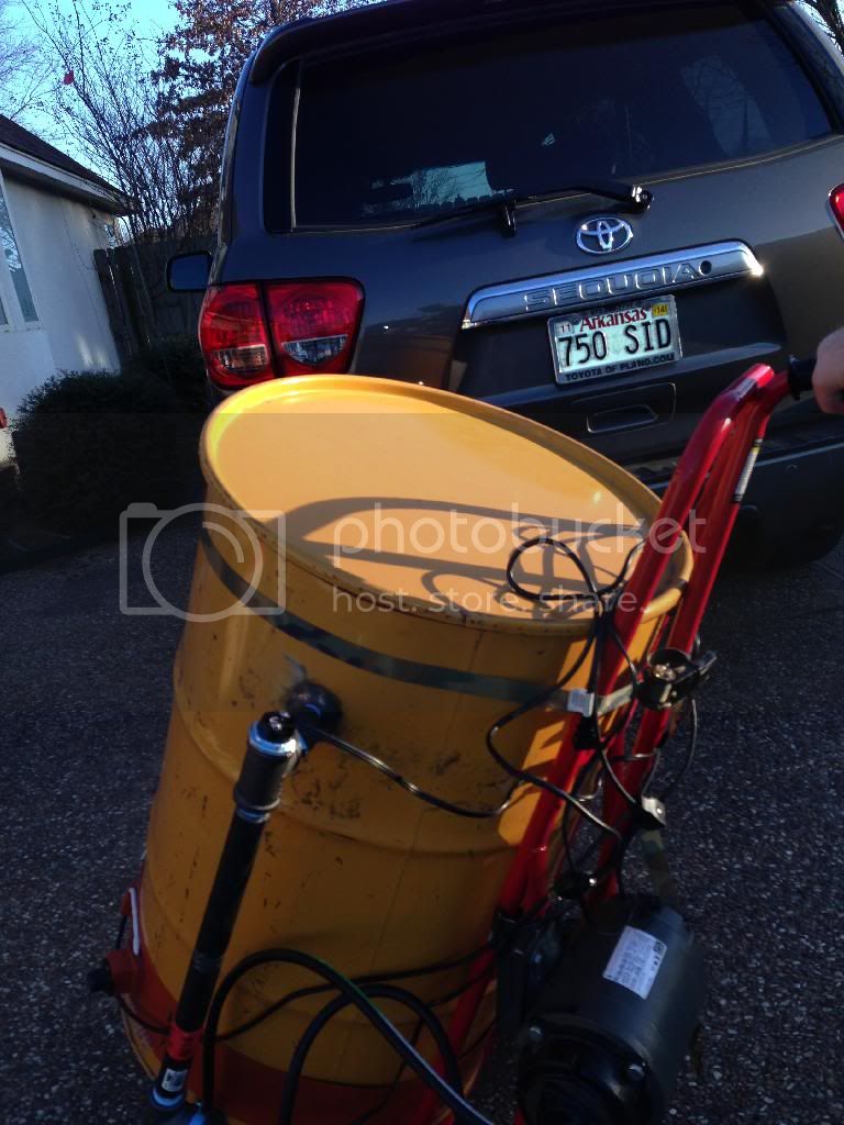

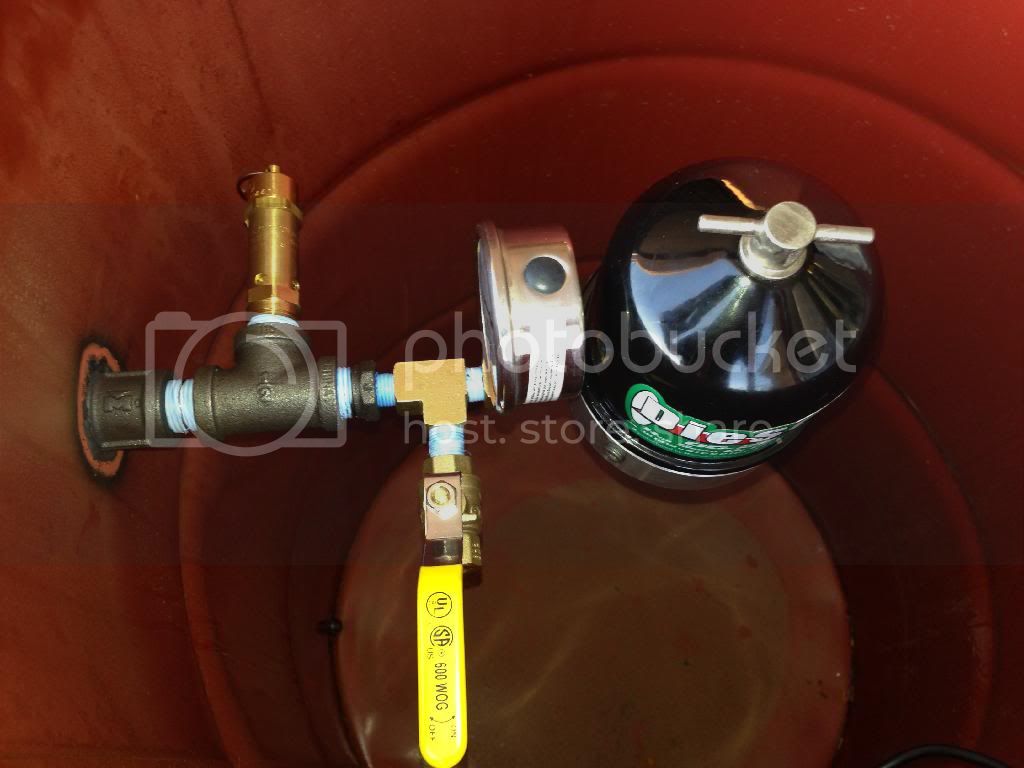

As some of you know, I plan to make my pig capable of running on used fry oil. I (mostly) finished my centrifuge filtration system today and wanted to post up some pics.
I still need a pickup tube which I hope to get Monday and then I'll be able to test it on the 30 gallons of waste veg oil I already have collected

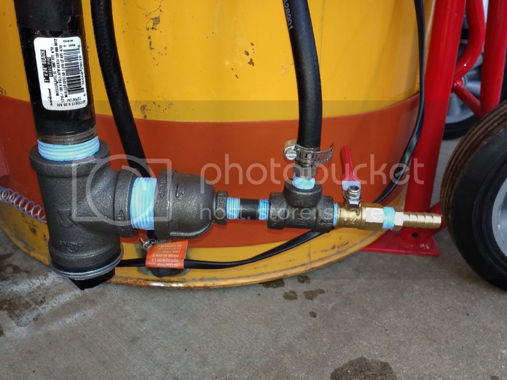

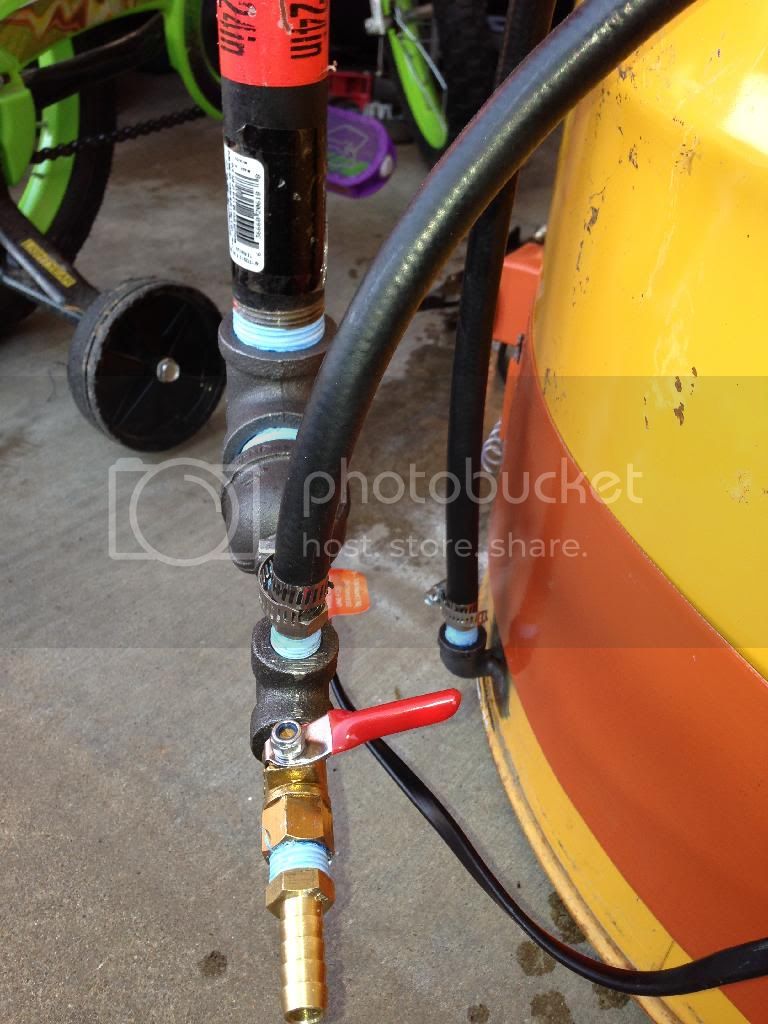

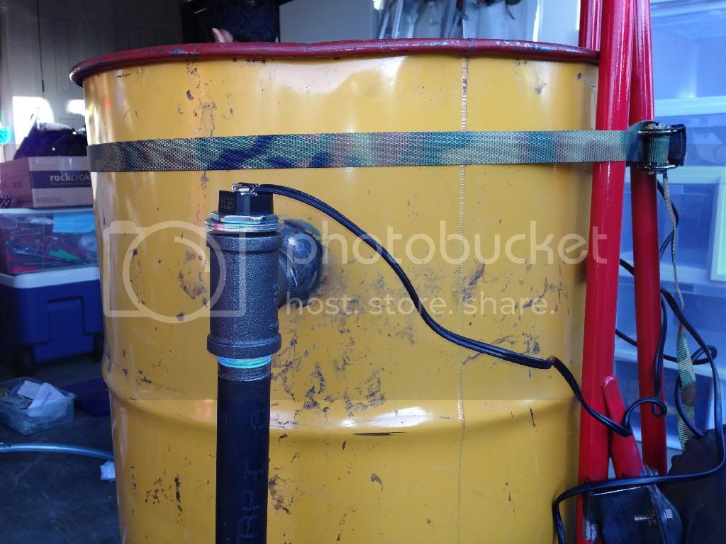

The barrel has a 1000 watt silicon barrel heater and the 1" pipe running up the side has a T at the bottom and another at the top. Each T holds a 4500 watt water heater element in the pipe. The heat creates evaporative losses (wvo had to be dewatered) and decreases viscosity which is necessary for the centrifuge to work.

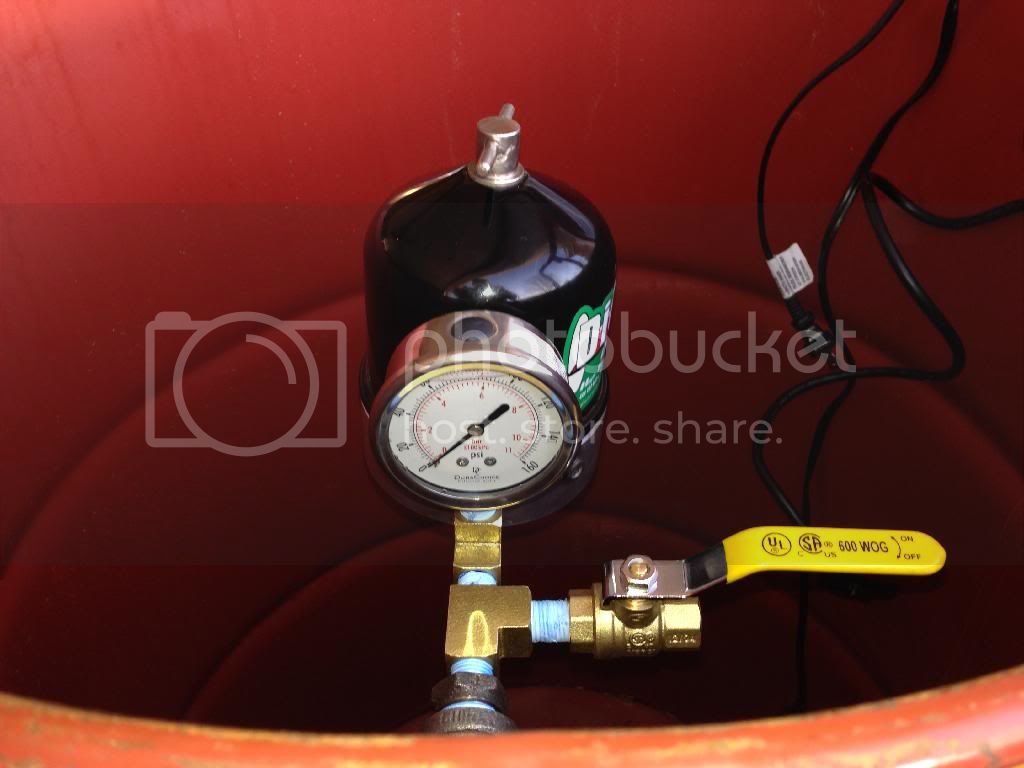

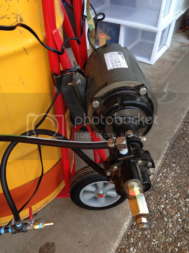

The pump will push the wvo through the centrifuge at 1gpm at ~180 degrees and 80 psi. I will let the filter run long enough to get 6 passes (a 30 gallon batch at 1 home would need 3 hours) which will dewater and filter down to 1 micron.
