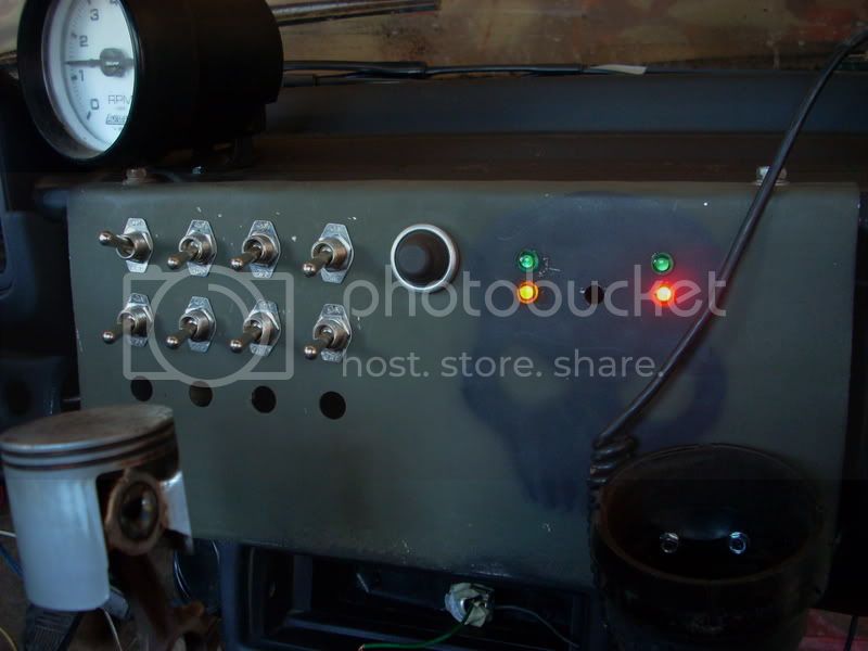

I did not use any of the factory relays or fuses from my 89. all mine i installed uunder the dash using Bosch 4 pin relays.
if you opt to do it this way, its IMO easier than pulling the whole harness out of your donor truck

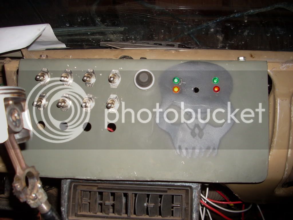

i made the switch panel. thats all wired in now
4 LED's 2 turn, charge and check engine
i couldnt afford 4 more switches. they will be for aux lights any way. now i have everything i need to drive it down the road legally. or at least close to it :doh:

I really like the piston/rod shift handle :cool:
and the switch plate came out terrific wristy keep em comin!

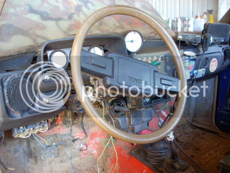

i pretty much finished the interior.
painted it all black. painted my switch panel and CB radio olive drab.
i put my special box ;) some of you may know what is is :grinpimp: and my cd player in the glove box. i had to cut out the rear of the box to fit the cd player.
this looks way better than the boring tan.
the floor will remain the way it is. i see no point in spending money on anything, as it will soon be covered in mud.
I painted my CB radio OD green :grinpimp:
the check engine and charge light

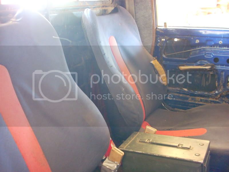

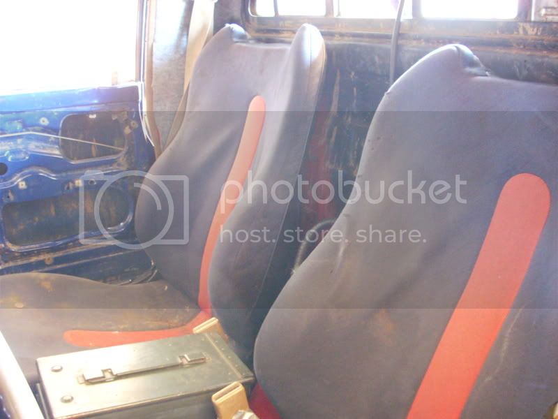

i used some honda delsol seats. i ripped the cottin pickin head rests off there. i hate those things :bang:
used a ammo box for a center console. sweeeeet

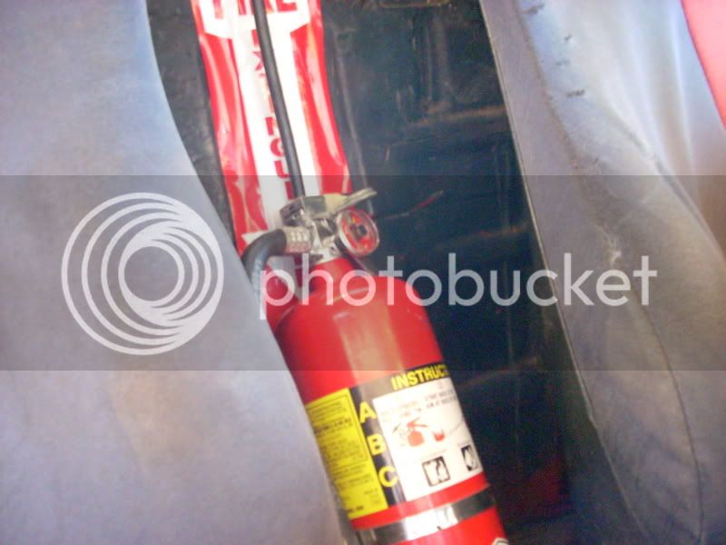

gotta have a fire extinguisher
The drivers side vent hole, i taped off the hole in the cowl. I always hated that. then made a home for a little 4" speaker.
the passenger side vent, i used the outer grommet and ripped apart a coffee cup, duct taped em together, and now i have a storage hole.
the cup holder affixed to the switch panel is from the swivel vents, the ones i just described.
a 12 oz can fits in there PERFECT.
the heater unit is pretty much worthless. there are vents in front, but never blew warm air, it was always cold. so I taped off the hole, removed the louvers, and now have a second storage hole.
since i now have no heater controls, i wired up a Hi only switch for the fan, and rigged all the flaps to fresh~defrost at all times. if i want no hot air at all, all i gotta do is open the hood and close the heater valve.
the del sol seats fit in there pretty good. i wouldnt say it was a direct bolt in, but dang close. the front mounts, i only had to drill one hole. the rear, only one side touched the floor, and drilled a hole there.
the other rear mount sits about one inch above the floor. and below that hole but off to a side is a weled nut. so making a spacer and drilling a hole would interfere with the nut. so i screwed in a 1.25" bolt, and the seat bracket sits on top of it. once the other three ate tight, the seat does not move around on that one bolt. its alllll good :grinpimp:
plus these honda seats are wayyy more comfy than the old worn out yota ones
