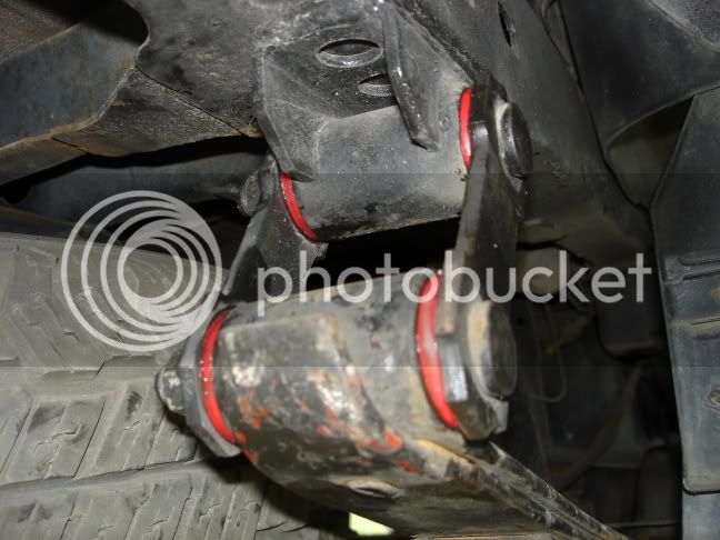

I decided to bob the bed. started with the frame. cut off the tails. welded in a 2.25" square tube. I pounded down the spare tire hangar, then once it was all welded, i pounded it back up and made a few welds under it. I used some angle 3/16" thick around the corners of this tube. I wasnt to worried about the heat affecting the bushings. i loaded em up with grease inside and out the other day. since i didnt see any boiling out, they will be just fine.▼▼▼
