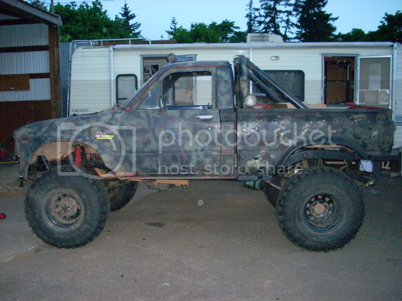

rear half of frame is all done. i made a new wire harness, too.
then make a cool skull stencil, and made skull camo. what do you think??

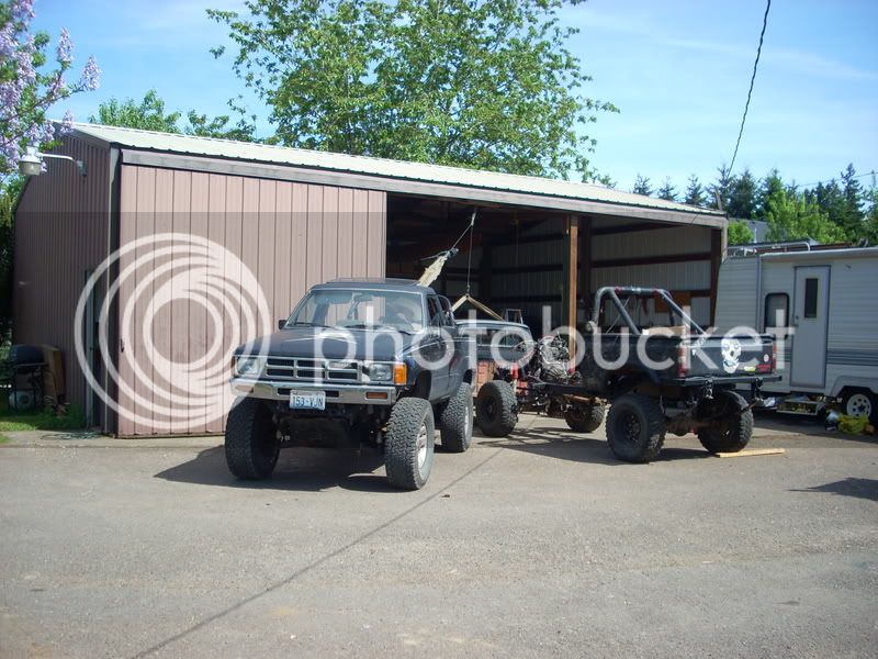

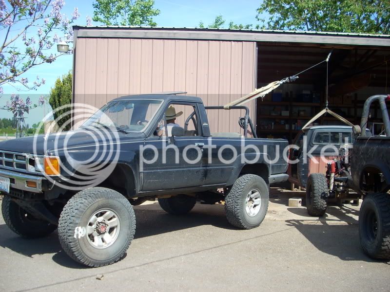

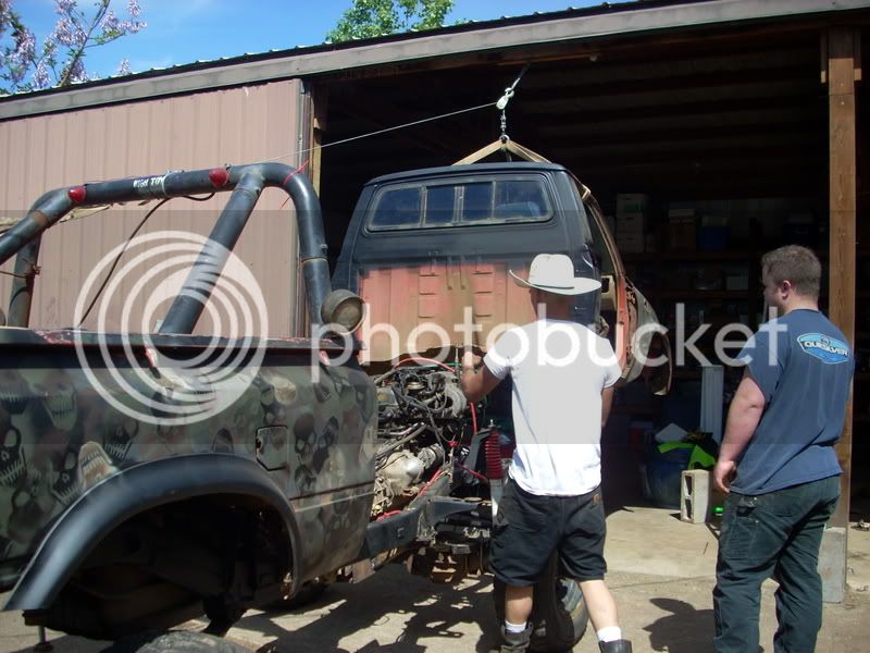

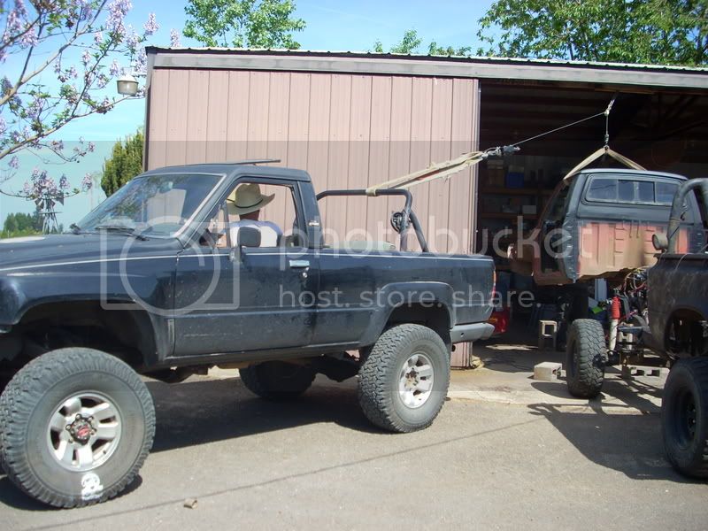

got the cab back on
i had to do it differently than before, as the come along is junk
hooked my 4Runner up to a strap, then to a cable, around a pulley, and to a strap around my cab.
redneck engineering at its finest :hillbilly:

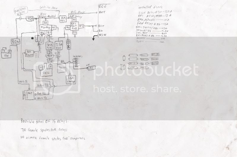

22RE to carb'd truck wire info
I have swapped in my 89 22RE into my 80 truck, formerly with a 20R
Since I am using a separate circuit for an external inline pump, i am able to eliminate the factory circuit opening relay.
Here is a diagram I made using the info here, and the info from my FSM. the colors i have written does not apply to anything you will come across. I used the stock fuse block and made note of stuff, for future reference. The injectors, igniter and O2 are essentially all tied in with the ignition. a separate wire to each of those parts is not nessicary.
the fuse amperage values on the side is for me only too, you can do the same, but again, its for my specific truck using the stock 80 fuse block.
on the alternator, you see values listed as 1/3 2/3 3/3 and 1/1
its how the FSM referes to a wire in a plug. all of these colors and values are of significance to you when doing the swap. since this was built off a 89, the alternator is internally regulated. you should use these wire colors to help you along the way.
The swap was quite simple really. I did make hard on myself cause i built a new body harness too.
