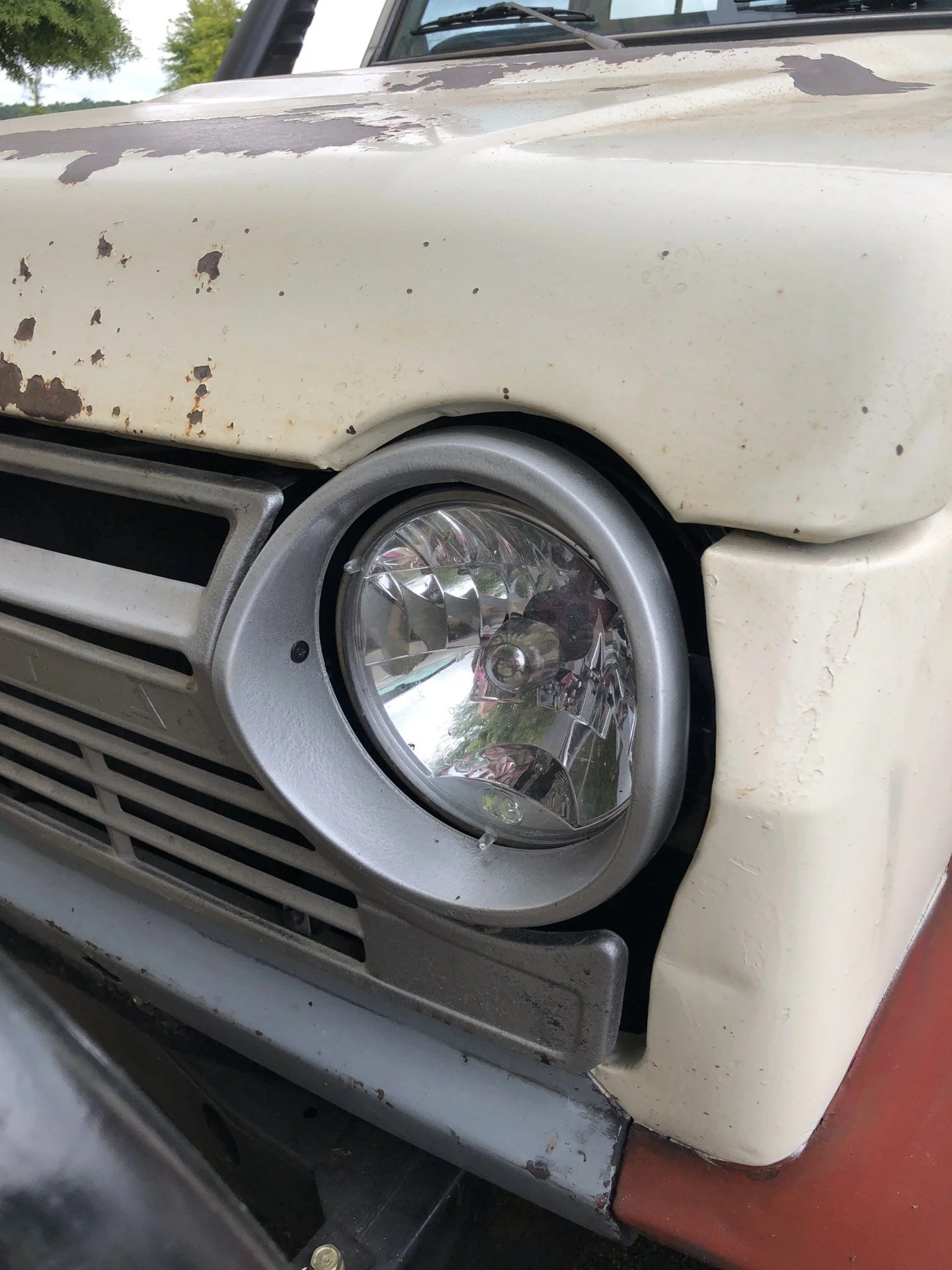

Funny you say that, I don’t run them due to looks either. I have a couple of different housings you can remove the H4 bulb from and add LEDs
I use the Stark LEDs of Amazon. They are $40 a pair.
Those Phillips and those housings you linked @c2dfj45 , is there a noticeable high beam? My Starks and aftermarket housings are nice and bright on low but in high they don’t do much more than low.
Mine on this truck are KC housings with Stark bulbs

Those Kyoto lights are really nice but spendy for sure. And yes, the Phillips LED has a noticeable change between high/low. Really pricey for bulbs. I like the idea of traditional looking lights but with LED light. Nice setup.

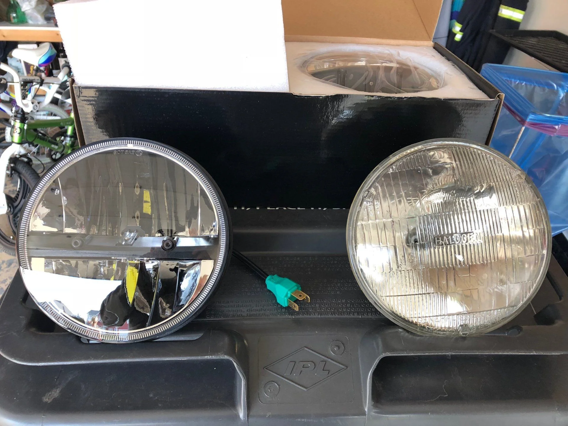

Love2fly,
I just put the lights in from cityracer. They are plug and play. I actually like the look of them on the truck and most importantly they work, really, really well. I can actually see what is 10 feet in front of me now. See pictures attached pictures. If you like the look I recommend buying them. I'm very happy.
