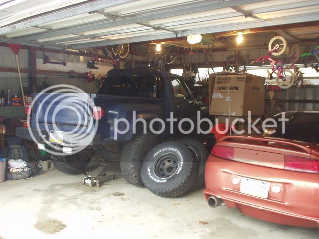

I cleaned it out good, cleaned the windows, took off the front push/brush guard and 4 fog lights, fixed little stuff here and there. Its time to dig into the axle now. There were 2 steel wagon wheels with BFG's in the bed, it has a brand new sony explode cd head unit and an amp under the pass seat.
The kids like it and it fits in the garage(just clears the door).

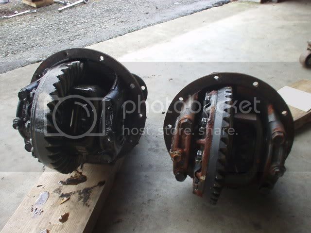

I got the 3rd out of my truck.

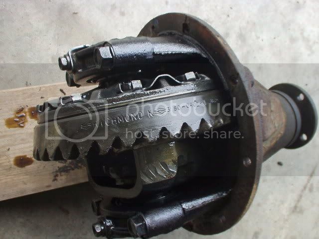

I think someone changed the gears, Unless toyotas came with richmond gears.:rolleyes:
The ring out of mine has 37 teeth.
The one I got has 41 teeth.:doh:
The busted one out of my truck on left.
By the thickness of that ring gear, I'd say you have 5.29's in there. And from the looks of things, they're no good now!
And I wouldn't put that other rusty POS diff in MY truck. Take that thing back, get your money back. UGH!!!
I just counted teeth again on the Richmond gears.
8 teeth on the pinion, 37 teeth on the ring.
I went to there site and none of those numbers matched with what they sell.:confused:
Well by the looks of the carrier unit it seems that the pinion gear is WAY to far in torward the diff and needs to have a new crush sleeve or solid spacer installed and probobly new bearings. If the teeth of both the ring and pinion gear look good you could probobly asemble a good diff with the parts you have there and a couple new parts from toyota.
Ken those numbers look to me more close to 4:88 or mayby even 4:30 gears and my yukon 4:88 ring gear was about as thick as the one pictured above.

Look at the chunks in the ring teeth, those gears are trash. The pinion probably looks worse. A few things could have caused this: bad setup, pinion nut coming loose, pinion bearings disentegrated. Something allowed the pinion to walk in too far, that's for sure.

Yup, I misscounted, its 37 ring & 7 pinion. 5.29's
I'm gonna call richmond tomorrow because the part number does not jive with anything they list. Here is what is stamped on the ring:
RICHMOND K 3 80-0402-1 8620
The pinion is trash, no teeth at all and the ring is missing a few.
