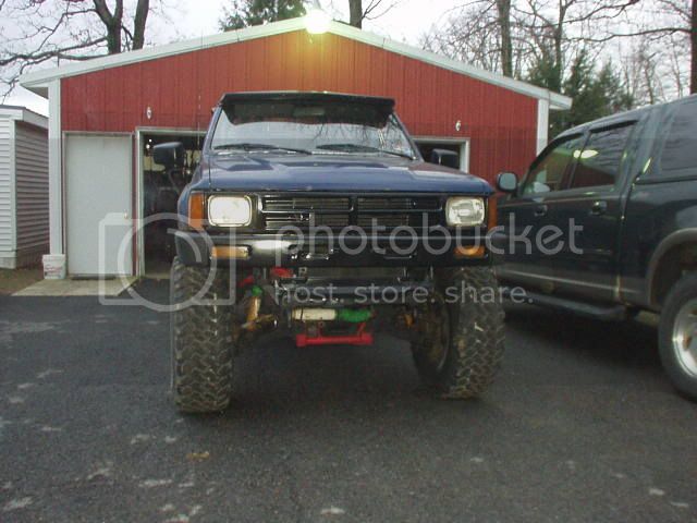

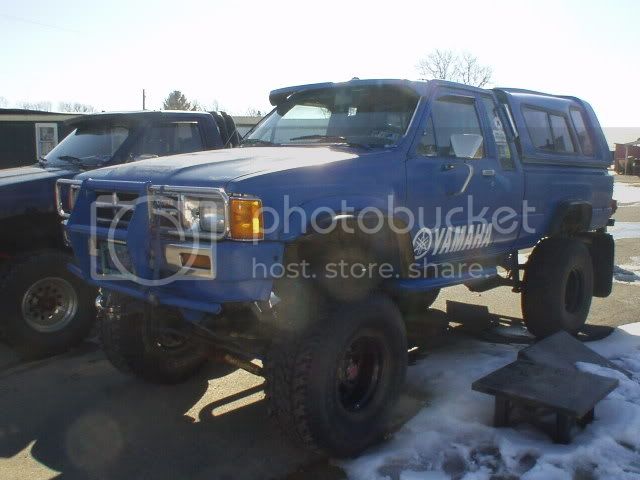

Update with Pic's
Its alive!

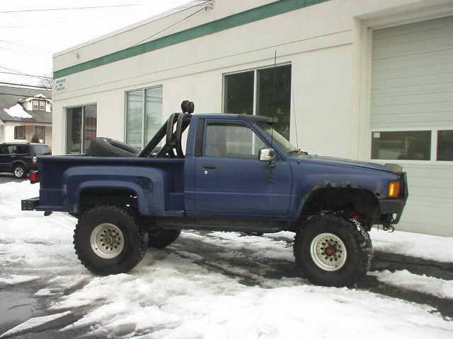

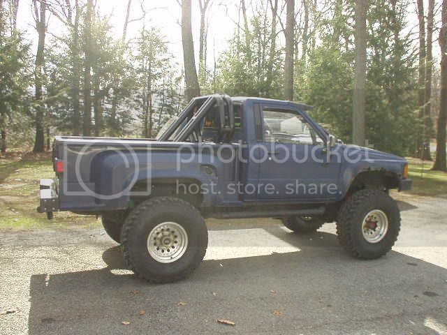

I did a bunch of stuff here is the "major" stuff.
New trans and T-case, found it has a newer center force cluch when I pulled the old trans out.
New 35" Pro-Comp mud terrains.
New Motive Gear 5.29's in the rear to match the front Richmonds.
Changed or checked all fluids.
Covered the bright green roll cage with black pad.

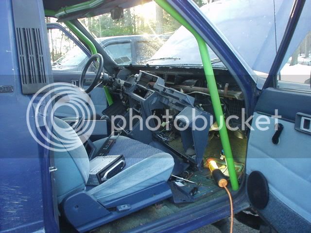

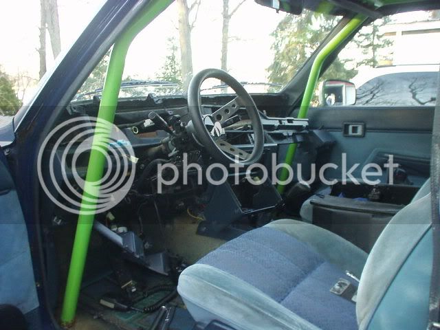

Had the whole dash out trying to figure out why the heat would not work and the whole time it was just the cable was off the little flap thing for the hot/cold air blend thing.:mad:
I made a bunch of short trips and got about 100 miles on the new gears, so I'm gonna change the oil and go wheeling next Sat.
Here are a few pics from the last couple weeks.

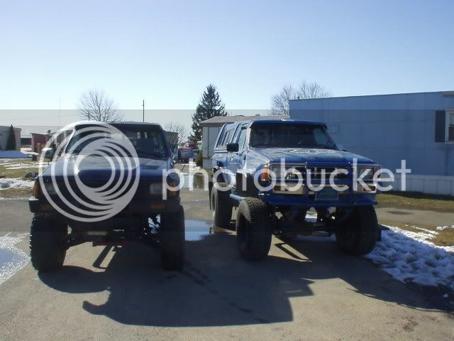

Here is an 85 xtra cab I found not far from my house, I'm thinking about buying it.
Just wanted to give ya an update.
Thanks for looking
