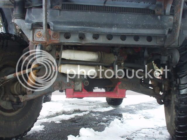

Is it me, or are these tires pointed funny?
Your right, it does look funky.
It looks like the left front tire is still somewhat straight. I think its just the picture though. Look at the pic I took of the rear from the rear, both wheels are turned to the right. I will double check it when I pick it up tomorrow BEFORE I give him the $$$$.;)
