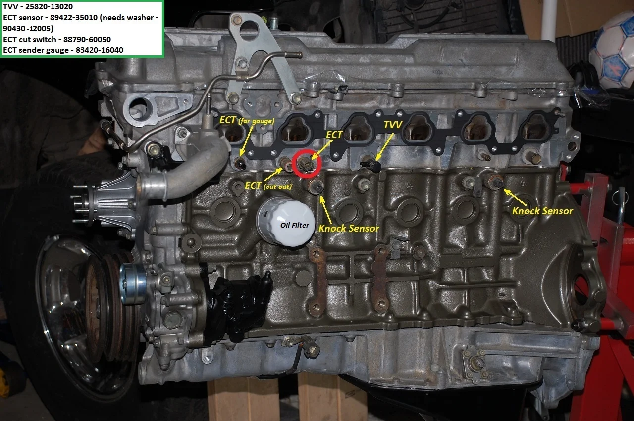

Temp sensor is in the head for the ecu
Driver side up above oil filter, there is pic in fsm that shows exact location. There are two one for the ecu and one for dash
Right. The one above the oil filter is just a sender sensor IIRC (single wire).
The other one is more important I think.
Want to know which one he replaced.
