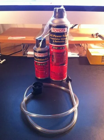

That system is super simple... no holes to drill. This is what Toyota uses in their AC cleaning services.
The large can is for the evap. Remove your belly pan and locate the evap drain. Attach the nozzle and spray about half a can in the drain. It reaches the core and creates a foam which drains out. After about 10 minutes repeat.
The small can is for the intake side. Run the AC at full tilt on various vents with outside air mode and spray the small can contents into the AC intake on the outside of car.
Start to finish about 40 minutes. It really works well. I also installed fresh cabin air filters.

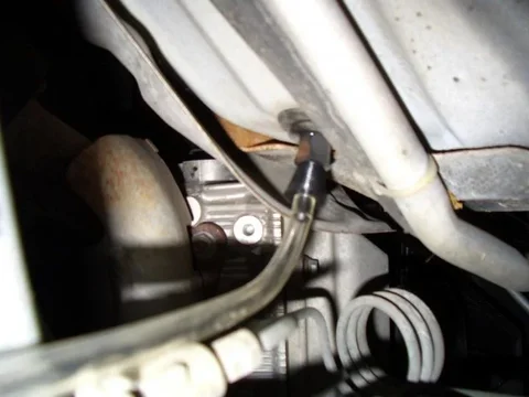

With the middle skid plate removed.
If you are under the car, head toward the front, on the passenger side, look up and next to the frame near the wheel well you will see a small rubber drain. It only sticks out 1/2". That's the evap drain. This is where the water comes from when you run your AC on a hot day and a small pool appears under your car.
Here is a pic from Ronulus in a similar thread.
