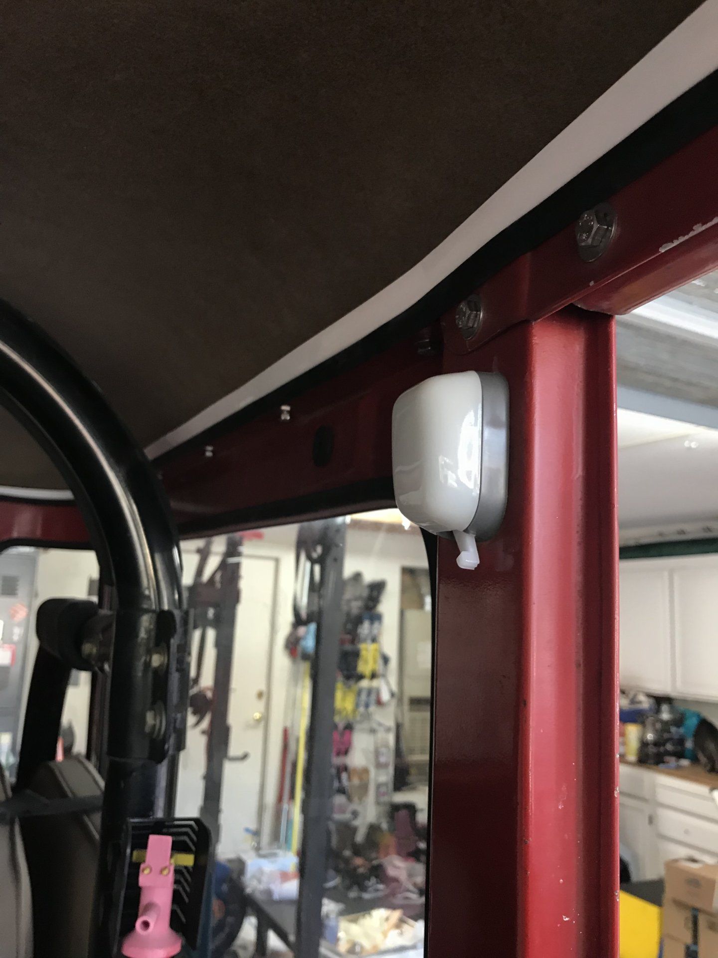

Put the final heavy coat on this morning and now will put on a thinned coat so it is even smoother. Then paint. Starting to warm up so should be good. Decided to install the new OEM dome light - need to get an LED to provide more light. But nice to see it is working!

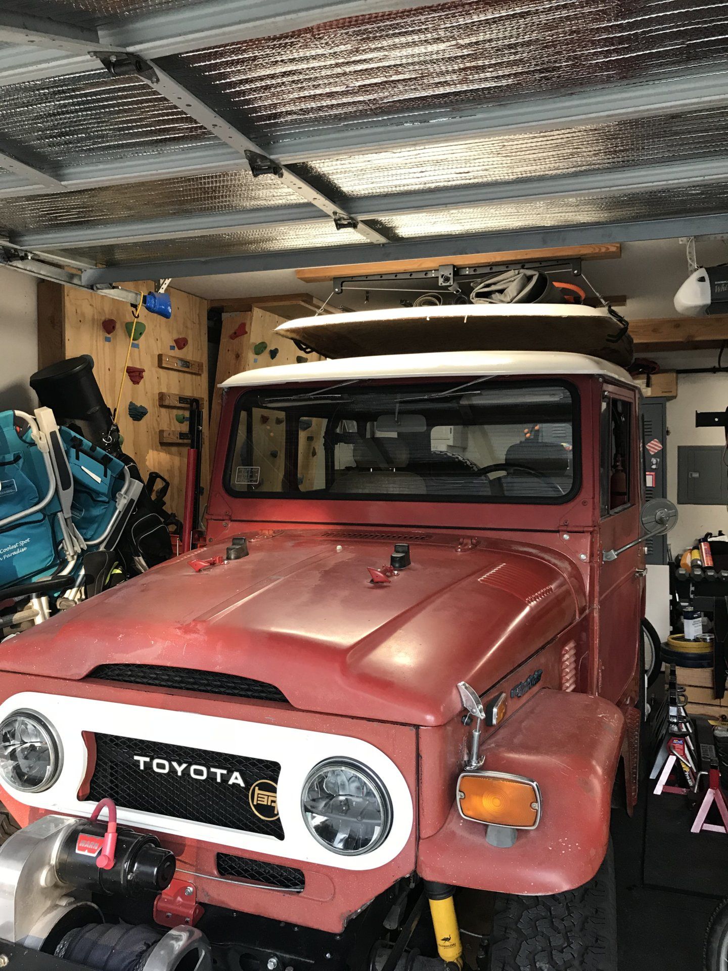

Yes, I am that neighbor. I decided against the thinned coat as it wasn’t timing out right getting the top coat on. So it has a little more texture but still looks good to me. I’m bummed I didn’t get a chance to take a photo of the cruiser all wrapped up and in my “paint booth” but there was a lull in the wind so I had to get it back in the garage quickly (I have a tree that drops little flakes).
Look at that shiny roof! Weird the cruiser sounds very different with a top on... couple creaks and rattles here and there but overall I’m pleased with the improved sound level in the cab.

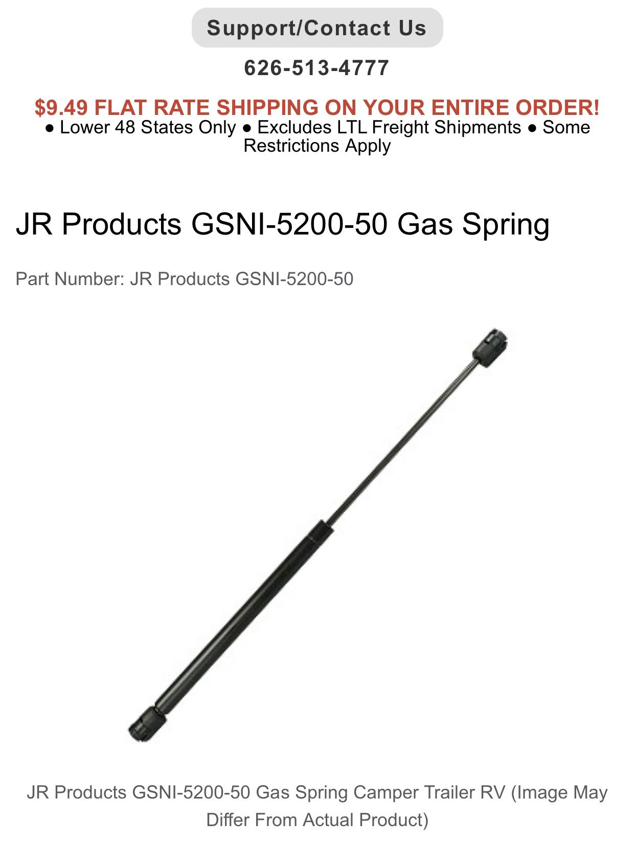

And installed a couple of things tonight - LED for my dome light which is a nice upgrade. 4 bulbs for $6.99 amazon prime! Also installed new modern gas struts for my hatch. I was going to do the struts inside the OEM ones however it appears they don’t make the strut anymore that fits inside them. Very narrow diameter required. So I got these instead and used my old mounting brackets. I can still touch my head on the handle (clearance is 5’ 7.5”) so will need to be careful but it is a nice improvement over what was there.
I must have a different OEM strut because the diameter of the bigger part (tube) of the strut will not fit. I measured the inside diameter and it will not work based off the spec. I had purchased the Napa one a long time ago in anticipation of doing this and it doesn’t fit either. Very strange...

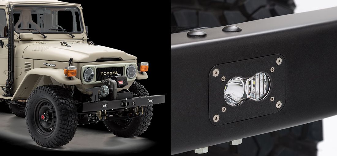

I can’t afford a $200K land cruiser but I love this little detail and could do that. Wonder if it is overkill however with my @Racer65 laser beam headlights... That flush mount is pretty sweet.
Not on a landcruiser but on my Tacoma I have LED headlights and LED fogs. I have non "DOT" floods for fogs so I don't use them in traffic. The LED headlights are quite nice though and work most of the time. But I will say turning the fog's on on dark back roads really lights things up even more. Especially with a flood pattern.
Seeing this detail just got added to my list to possibly do on my FJ40 lol. I like that brands flush mount too as all I'd really see was Rigid's offerings and I hate how its stamped rigid on the face plate
