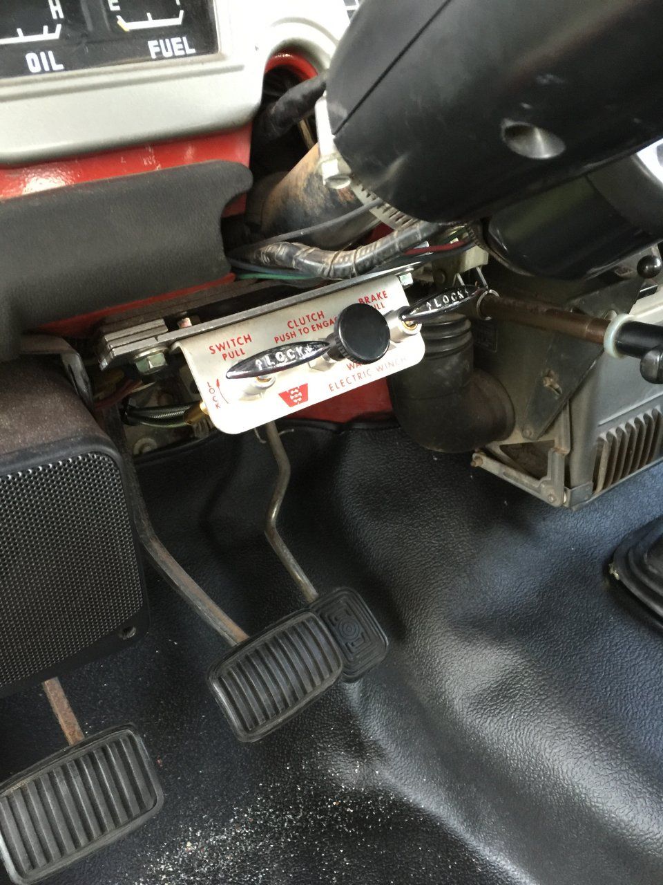

So I've had the winch mounted for quite some time however I haven't hooked it up yet. Thanks to @Kayaker I'm ready to take on the task! He sent me a bunch of photos and a description of how he ran his winch (same model and controls). Hopefully this weekend if I can shake whatever bug I caught.

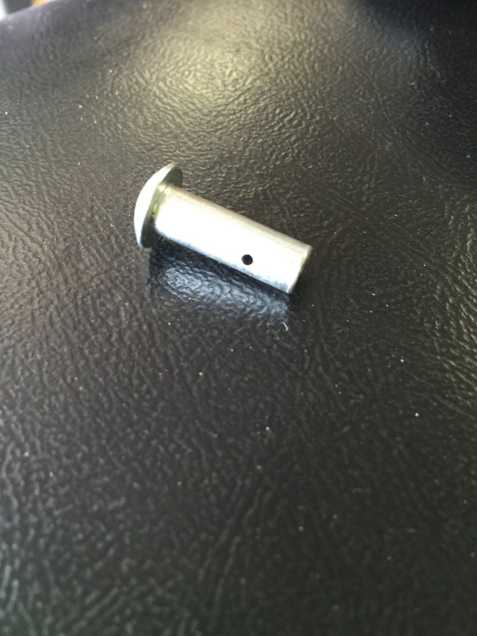

Here is the switch I finally fixed - I had sheared off the copper bolts so filed down some aluminum ones to fit. I just need to put on the anti-corrosion gunk in the event I need to take the nuts off. Hopefully won't have to but you never know...

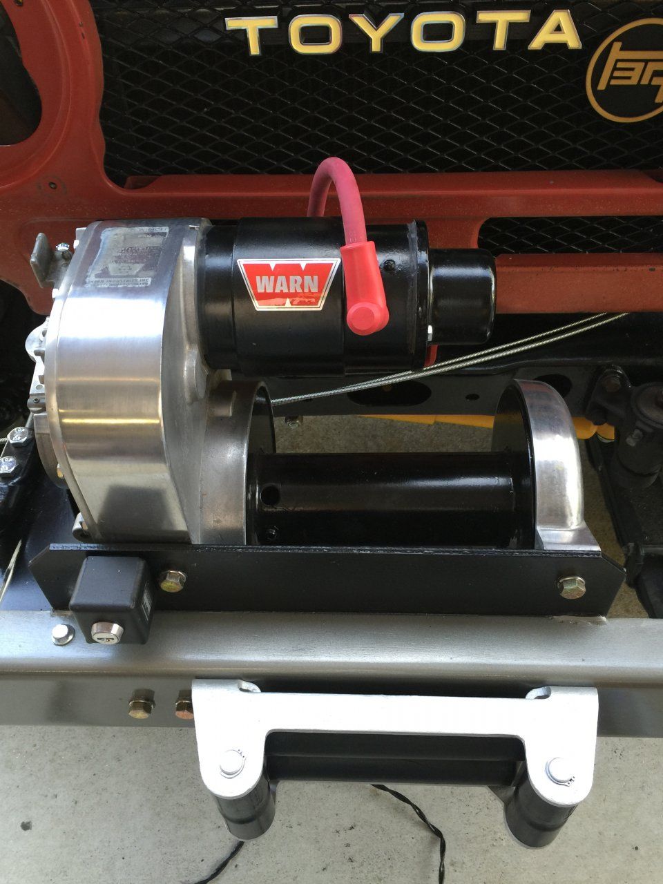

Making some headway on the winch installation. Of course the screws to hold the control wires sheared so I had to improvise (drilling that little hole in the photo below was interesting). Just need to connect the control wires and fill the winch with oil and I should be good to go!
Lookin good. Is that winch cable as light as it is clear?
I have a synthetic cable so it is very light but I haven't figured out how to make it invisible... ;). Actually not 100% certain how I'm going to mount it - it is designed for a steel cable and you simply feed it in a hole and tighten down a set screw. Maybe I can grind down the end of the synthetic cable as it has a crimped end on it.
Cool, bet that shaves a lot of weight off that winch. What's the working strength of that cable and do you know what the cost difference is for that vs. galvanized steel?
Here is the rope I got - it says 12,750# rating. Cost $160 for 92'. I know that I won't be using it much so didn't want to go crazy on the rope. This thing could probably fit hundreds of feet on it. Galvanized is much cheaper but I like the reduced weight (7# including hook) and the benefits of synthetic rope - particularly the one where if it fails there is no stored energy to release violently like there is in steel rope.

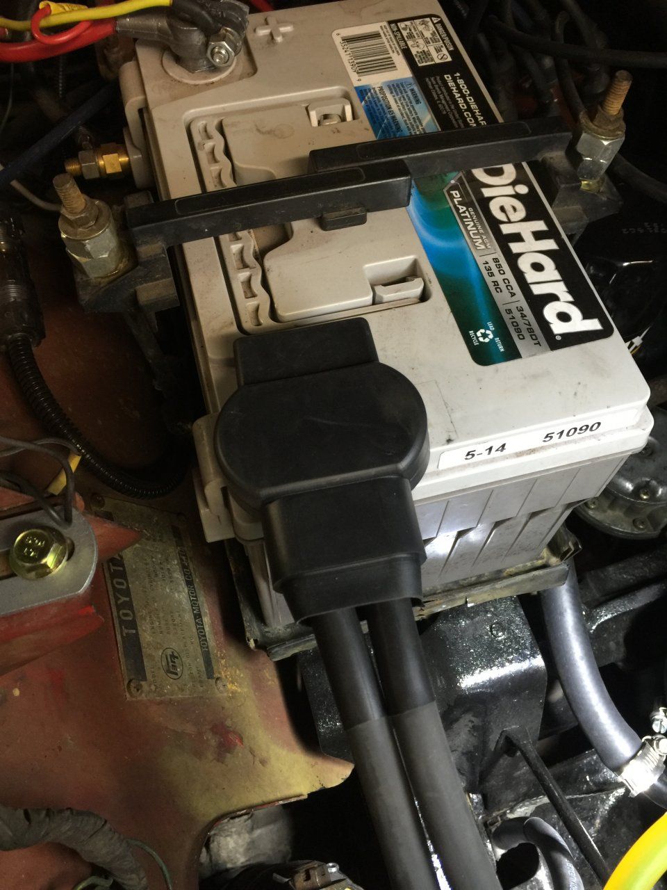

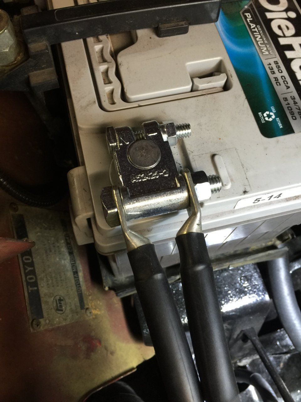

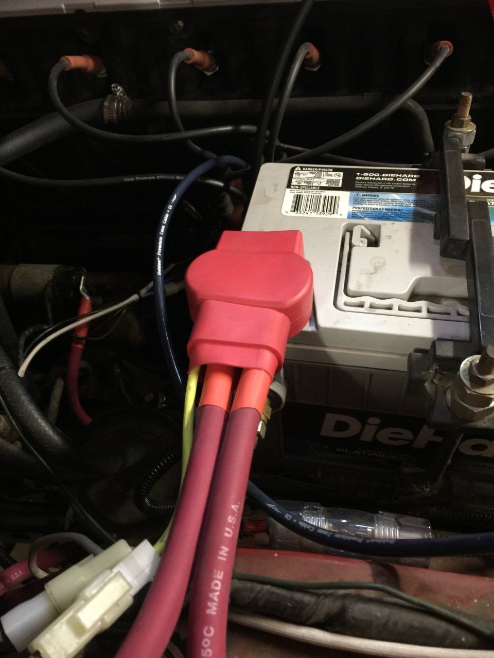

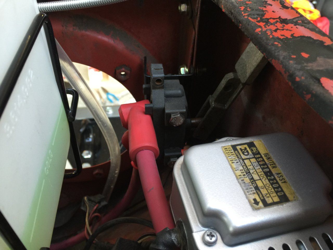

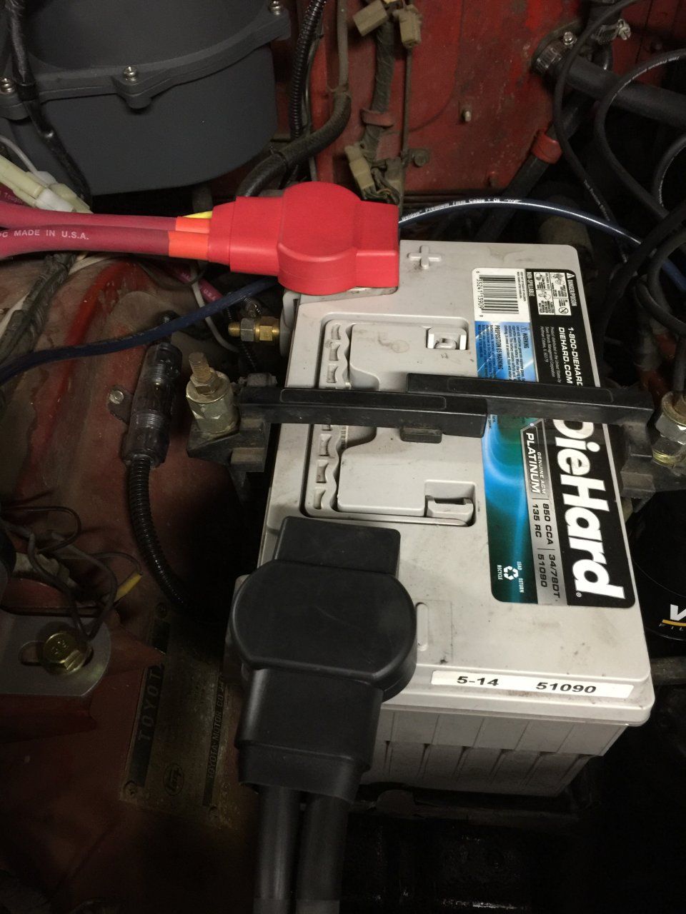

Got some electrical work done! Thanks to @GA Architect for his help! Used 1/0 welding wire - the length to the starter is longer than it should be, just in case I switch to the much smaller GR starter... :)
