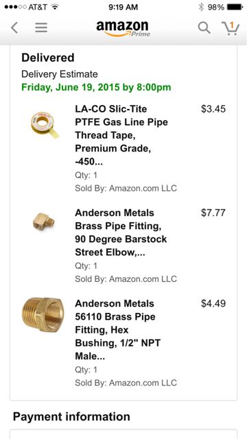

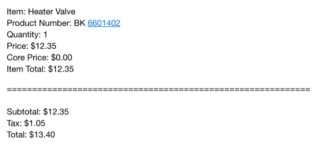

This ended up being a pretty expensive setup but it does indeed look purdy. I had also bought a PEX inline 1/4 turn valve which was a much cheaper and easier solution which simply goes inline with the hose. So now I have that piece laying around in the parts bin. But here is the solution:
Need this because the right angle doesn't clear the bolts of the engine block.
This I found on MUD can't remember who posted but it is from Napa auto parts.
So was this just for burping or is this also where your heater hot water supply comes from?
It shuts off the hot water from circulating into the cab so will help a little bit with temperature in cab... So they say. Still warm in there but I guess every bit helps! So the latter of your response. :)

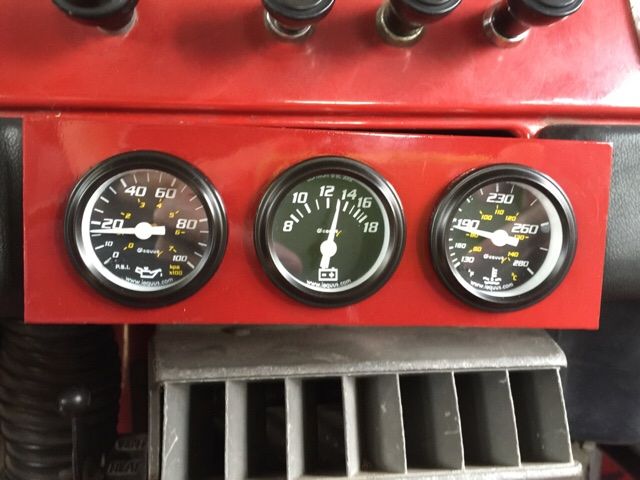

So I'm not sure what is going on with my oil gauge - it worked upon first connection but after I shut it off no luck. Their tech support suggested there might be an air bubble in the system and to bleed the hose. I did that and then it worked the first time but then stopped working. I'm thinking the gauge is bad. Have requested a new one be sent. We'll see... Does that pressure seem right at idle? Seems low to me but could just be because of the gauge scale.
I never noticed 44's oil pressure dropping at idle, before the rebuild. Now, after the rebuild it drops down at idle, just like my tundra. I'm not sure if it's as low as 18-20 because I only have the stock gauge in 44 and in the tundra... But, it's real low at idle and comes up to the normal range when not idling.
But, it doesn't take a lot of oil pressure when it's idling at 650rpm.
Do you still run the stock oil gauge too?
How does/did it compare at idle?
My GUESS is, you are fine, Mike... Think about how the dissy shaft turns the oil pump... Turns slow at idle... Turns faster and faster as you accelerate.
You could always pickup another gauge and see what it shows... Maybe rent from an auto parts (money back on return) or buy one and return it...
Okay good to know pressure is probably a non-issue. I do have the stock gauges still connected and I get good pressure readings for the oil always past the half way mark and an occasional drop to about 1/2.
The biggest issue is it doesn't read pressure anymore. Twice it has done that to me - worked on initial install but then after shutting engine down it doesn't read after restarting. Then I bled the line and same thing happened. Works initially but then on subsequent starts no Bueno. So the plan is to have them ship a replacement and test that one out. Kind of a pain since I've taped up my custom bracket and will now have to do it for a third time. Hopefully it is just a defective gauge.
