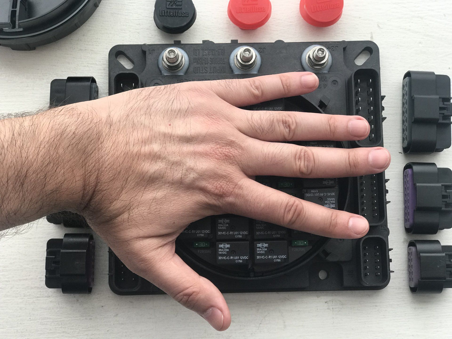

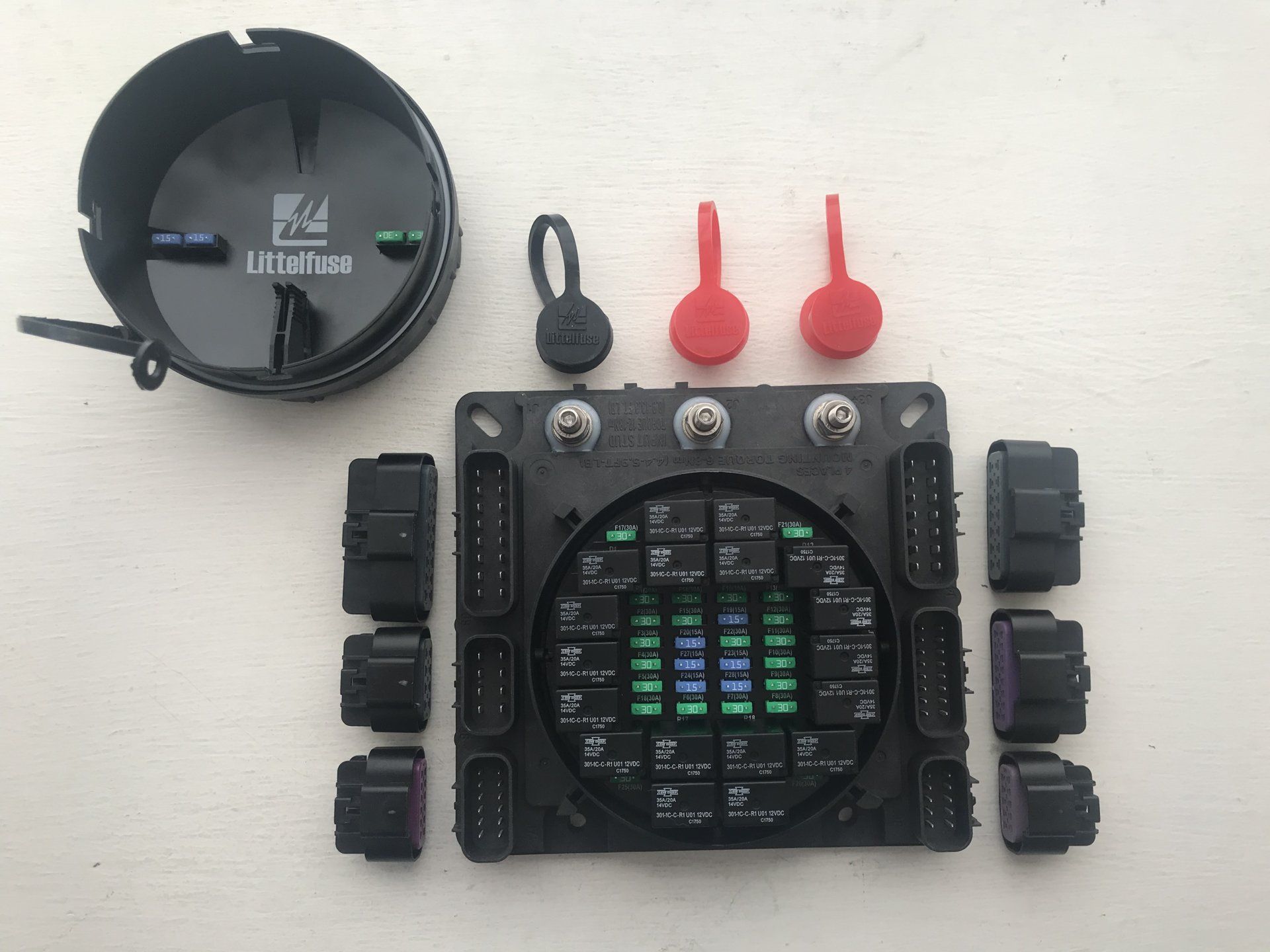

I kinda feel like the round takes up a lot of real estate compared to the typical square designs...

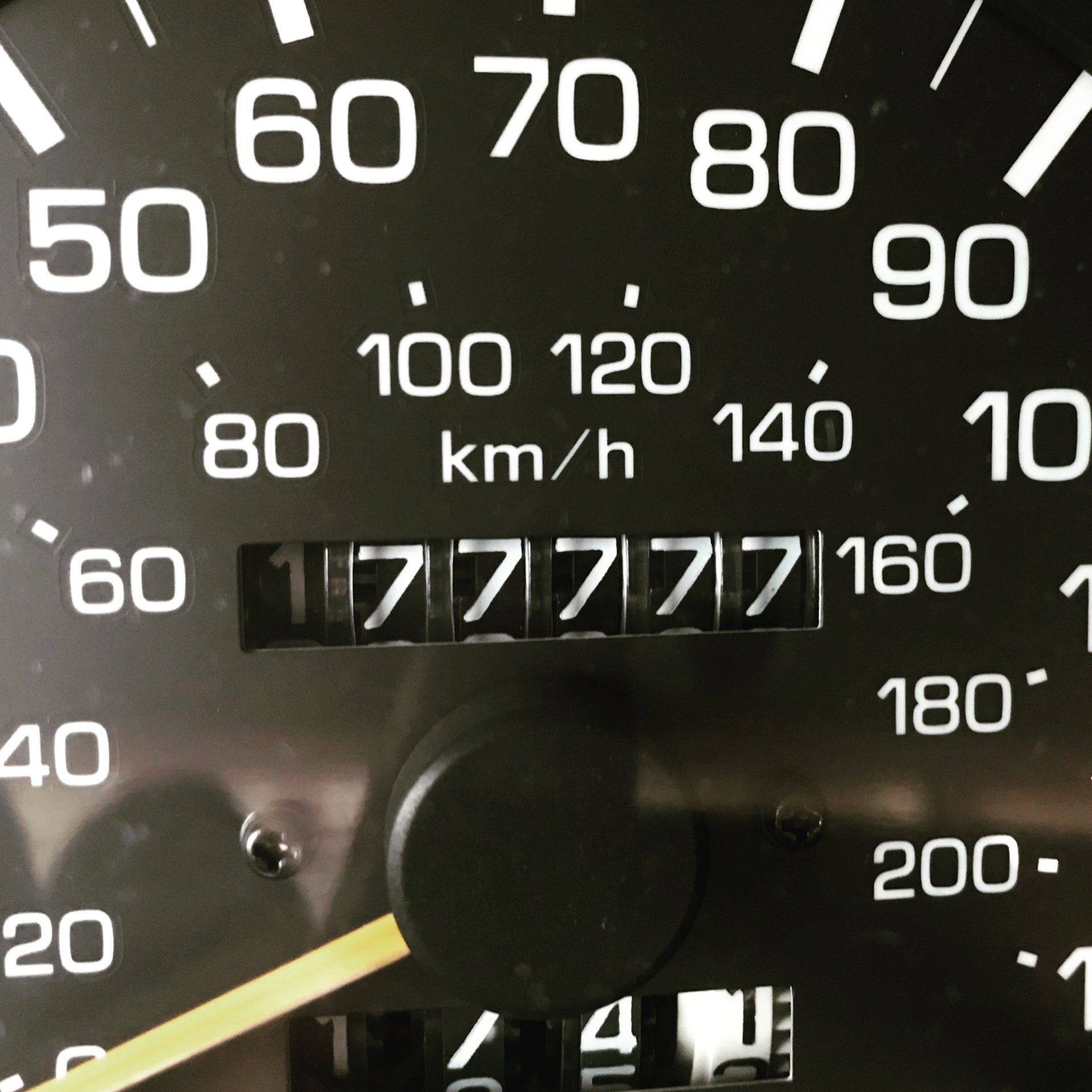

While SEMA Garage was doing mileage accumulation for my CARB certification, the new test mule #3 rolled 7s
If 7s is all that's Rollin', ya gotta be happy with that!
Oh OK. I thought the bussman had 30a max as well per circuit but just provided various sized fuses in the kit. Anyway your dual inputs will be nice.Its not really round, its square. Its just the fuse/relay section is round. But the Bussman is longer and taller. Although its rated at 400A combined, it splits the available outputs to dedicated amp ranges. The Littlefuse one doesn't do that. I can select any amperage up to 30. It seems they all limit their circuits to 30A.

That's not quite all 7s. I see a leading 1. This is all 7sWhile SEMA Garage was doing mileage accumulation for my CARB certification, the new test mule #3 rolled 7s

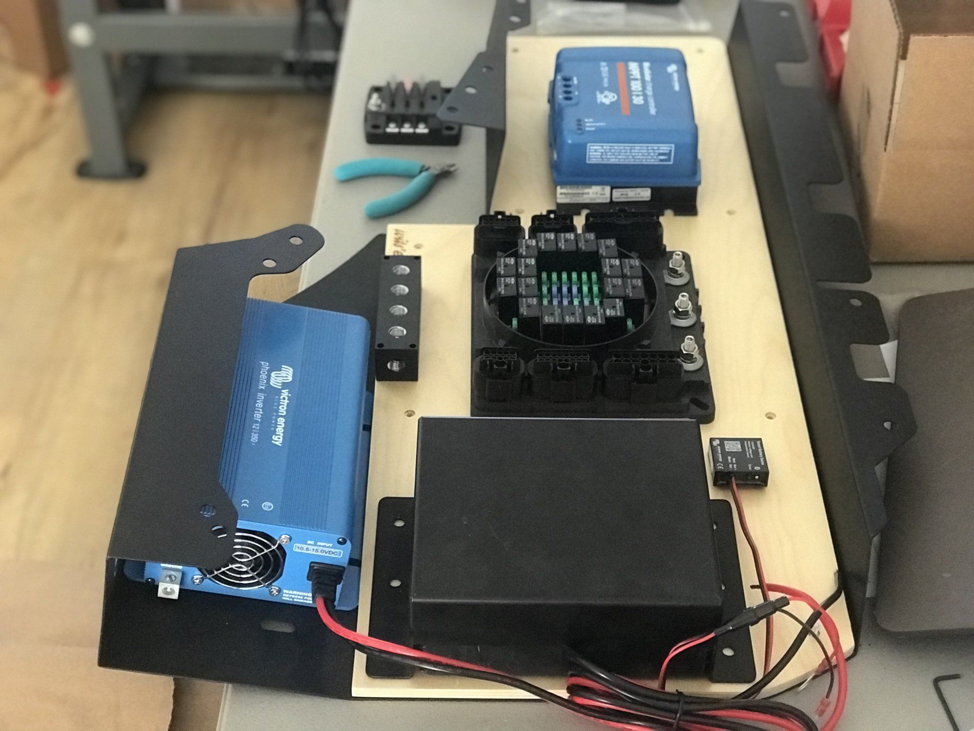

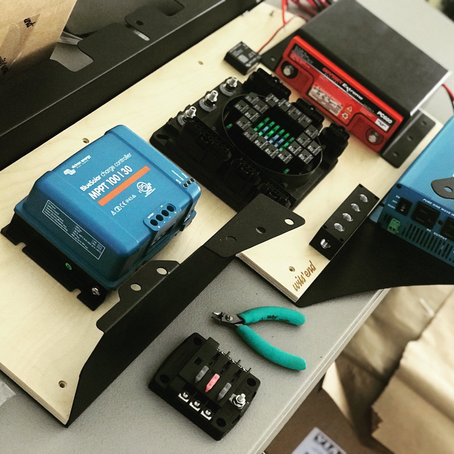

I am eyeballing that very same unit for the same area in my truck.Oh and I picked up a power distribution module to mount in the QPM. Solid state, 27 circuits, 30A each for max 300A and can take dual power inputs. I’ve got huge plans for this
View attachment 1997400View attachment 1997401View attachment 1997402
