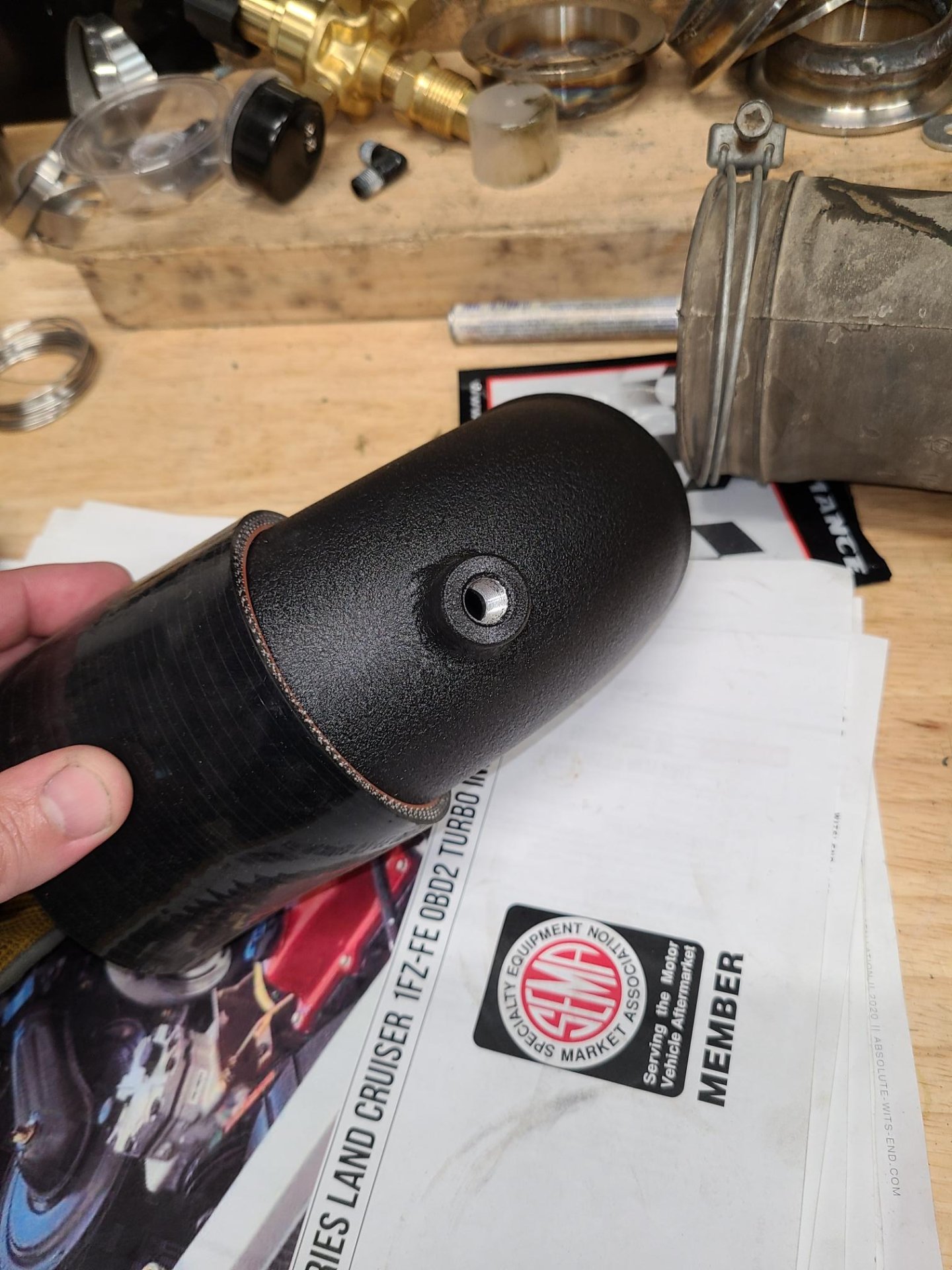

This is the hard line between the throttle body and the turbo. The bigger and tight U is the intake to turbo. Did you get anything to seal it?
I will try to dig through it and see. Yeah, that is what I was meaning. Still thinking IAT. I got a kit that was incomplete, just waiting on a few pieces. So I probably am not the guy to tell you for sure
what is supposed to go on here? This is the bend into the throttle body.
Since it’s after the compressor, that could be for air temp sensor, but I’d speculate that bung is for water-meth injector.
Joey mentioned he planned to develop a water meth injection kit at some point. Adding a bung isn’t much additional work prior to powder coating compared to after. Also, it’s easy to plug for those that don’t plan to add kit.
IAT is already measured at MAF and available in OBDII.
In the cases when you would want post-compressor air temp, It would make most sense in an application where you are running an intercooler. You’d want Measure pre- and post- intercooler to monitor temps.
