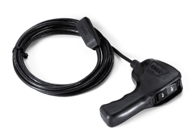

and new remote
P/N 83665
Winch Remote Controller, 12' - 83665
Remote control stands up to rough treatment offroad. Ultra weather/ mud resistant thanks to improved sealing. Simple, intuitive operation. 12' (3.7m) lead, compatible with all current WARN Truck/SUV winches, except ZEON Platinum, PowerPlant, 9.5ti, and 16.5ti.www.warn.com
