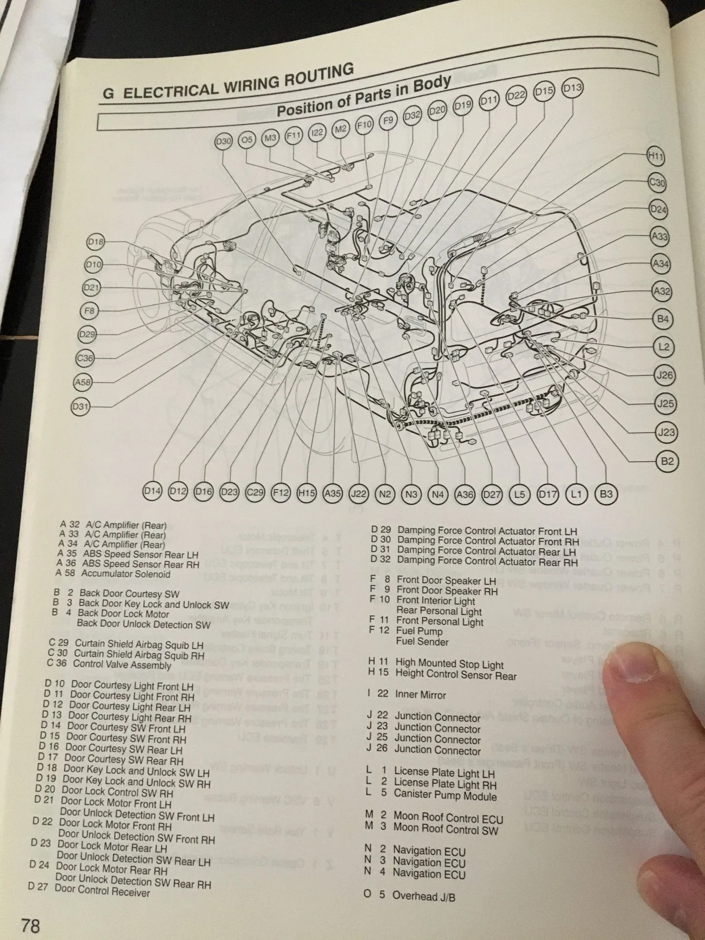

I'm trying to confirm the location of the Wireless door lock ECU, as I want to see if there is an FCC-ID on it for me to reference. The FSM looks to show the ECU in the rear passenger door/quarter panel.
1940869
Can any here confirm the location? I wasn't able to find anything solid via search.

D27 is pointing to the door control receiver (referencing a 2007). Looks like it’s on the passenger side between the front and rear doors.

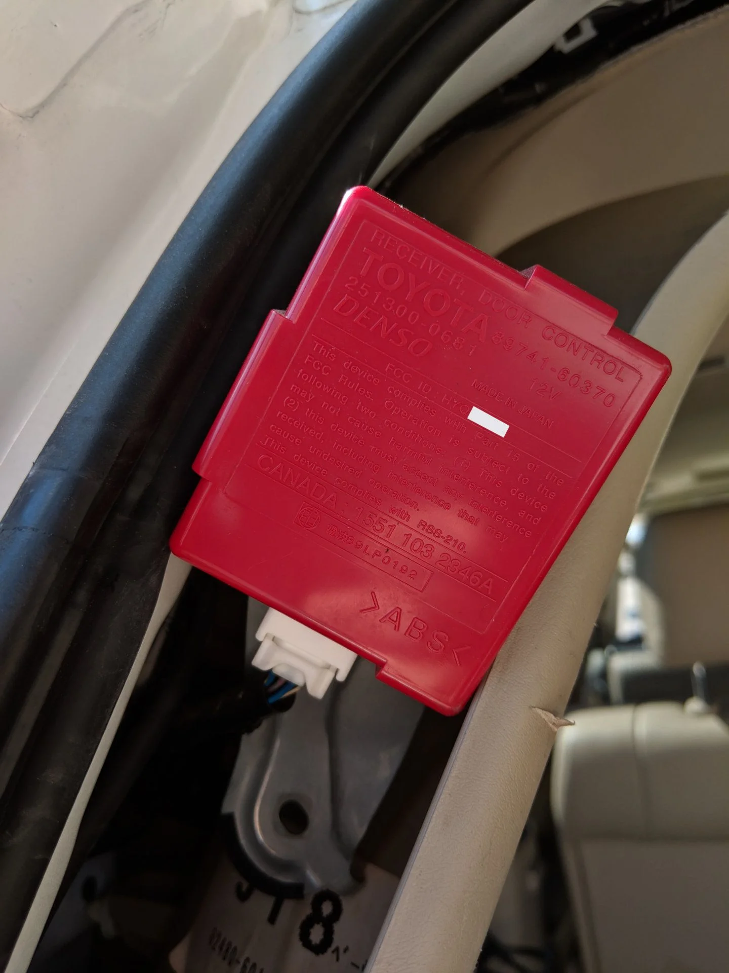

Update, after @aging fleet reminded me of the wiring routing diagram and some exploratory panel removal, I found the wireless receiver/ECU.
It is located behind the driverside rear upper interior panel. I noticed on the second page of the routing diagram that the harness actually was on the other side of the truck.
1941314
Good news is that you can access the ECU without fully removing the panels:
1941326
Adding further, you can enter the FCC ID number here: LINK, to determine what frequency your receiver uses.

does anyone know where the wire is routed towards from this receiver? my key stopped locking or unlocking remoteley and i have error code B1242 wireless door lock tuner circuit.i dindt go near the receiver but did peel the carpet near the driver side front and rear doors .im assuming i must have damaged a wire or something that connects this receiver and some sort of ecu near the dash. im looking for diagram of the actual wire that connects wireless receiver and mysterious ecu near the dash. thanks mine is 2003 LC100
Are your dome lights working. Receive share a fuse with them in the 07LX, likely in the 03 LC as well. IIRC, dome fuse was in RH junction box (PS foot well) of the 07
Hi. all the fuses, dome lights sunroof are working. key is locking all the doors via driver side door using key. only thing not working is remote locking/unlocking. tested the key and its working also changed the battery in the key fob. locksmith tried to reprogramm the key but said car is not responding to programming and only solution is to find mechanical issue between wireless door lock circuit and door lock motor or something
Make sure locksmith did his job correctly.
Make sure power is getting to the receiver.
In the one I had issue with. It did not have a key fob. I purchased one said to work, it was wrong frequency. Then once I had the correct fob, I got the same code as you. I found it to be a fuse. In the 2006 LX470, it was tied to dome fuse. In 03 it may or may not be tied to a dome fuse. So if everything works you'll need to confirm power is getting to receiver. If it is. Then likely you need a receiver, but check, no response/signal coming out of receiver. But that is not common part to go bad.

hey everyone , my remote locking no longer works. the key itself is working tested by a professional, key battery is fine, i can use the key to lock all the doors from driver side manually no problem. after using a scanner i get error code B1242 - Wireless Door Lock Tuner Circuit... I know the location of the wireless door lock circuit thank to this forum but im wondering how to test the wireless receiver is working or wires that go to the front dash is working??? what tools do i need to test it? PS: i live in remote place with almost no one with great knowledge about LC100 as well as tight on budget so professional mechanic is out of question...
How can i test the wiress that connect wireless door lock circuit to to other ECUs? using tester?
you can see the wires in the pic.
blue, violet, blue/yellow and white/black.
assume blueyellow battery, whiteblack ground, violet and blue to body ecu
