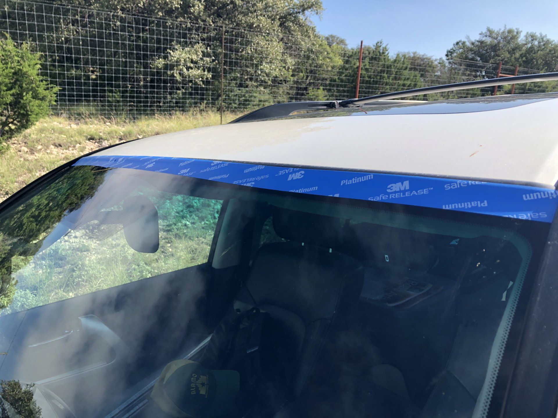

Heading out to California and since there was so much interstate time I brought a roll of blue painters tape to modify airflow and see if I could alter or eliminate the common low pitch whistle from the windshield.
Background.. 2013 LC with a replaced windshield. It is not OEM. Tech reused the side trim and did a s***ty job of it so back in May I ordered all new clips and a flexible epoxy for the top clip pads.. trim is now installed perfectly.
Taping the sides at the bottom, no change. Middle, no change. Top.. whistle got substantially louder...
So I removed all of the side tape and put a line across the top covering the rubber trim strip. Noise: GONE. Speed, wind, nothing matters. No noise.

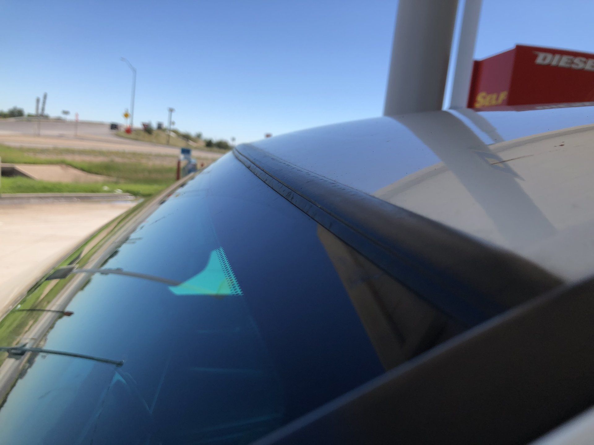

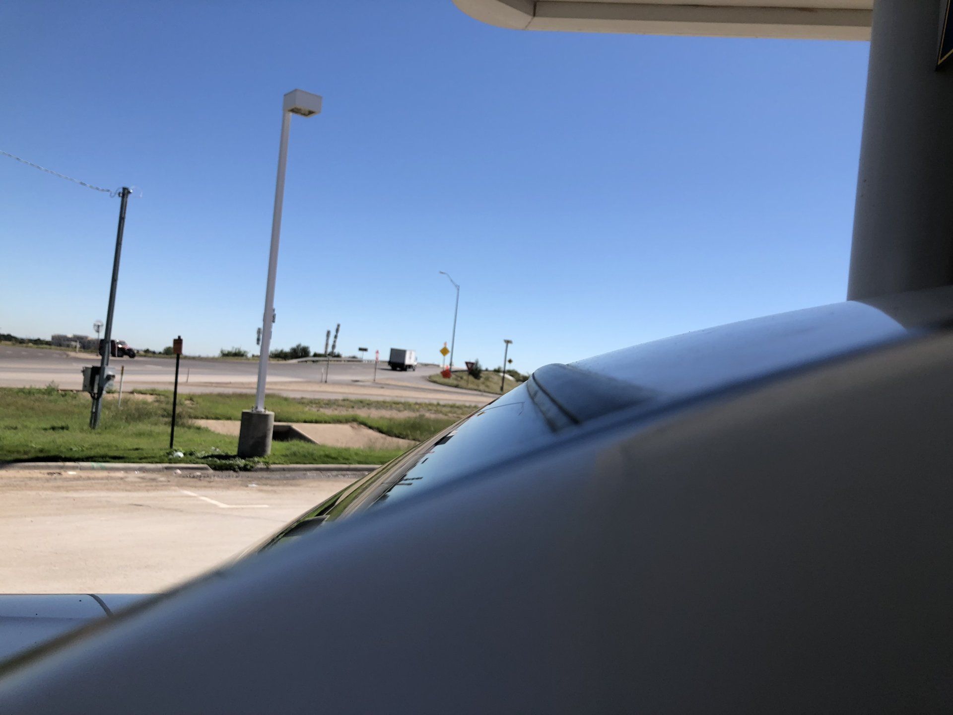

I also have a 2013LC (silver) which I bought new, but the top edge of my OEM windshield (as is from the factory - never replaced) looks nothing like yours.
Here are some pics taken from the driver's side looking across and down at the top edge:
Looks to me like whoever replaced your windshield used some "alternative" gasket for the top edge - and most probably the source of your wind noise.
I have no wind noise of any kind.
HTH
Wow thanks for the pics.
Yeah I’m betting this is some generic rubber trim and it doesn’t play nice with the way the air flows over the top edge.

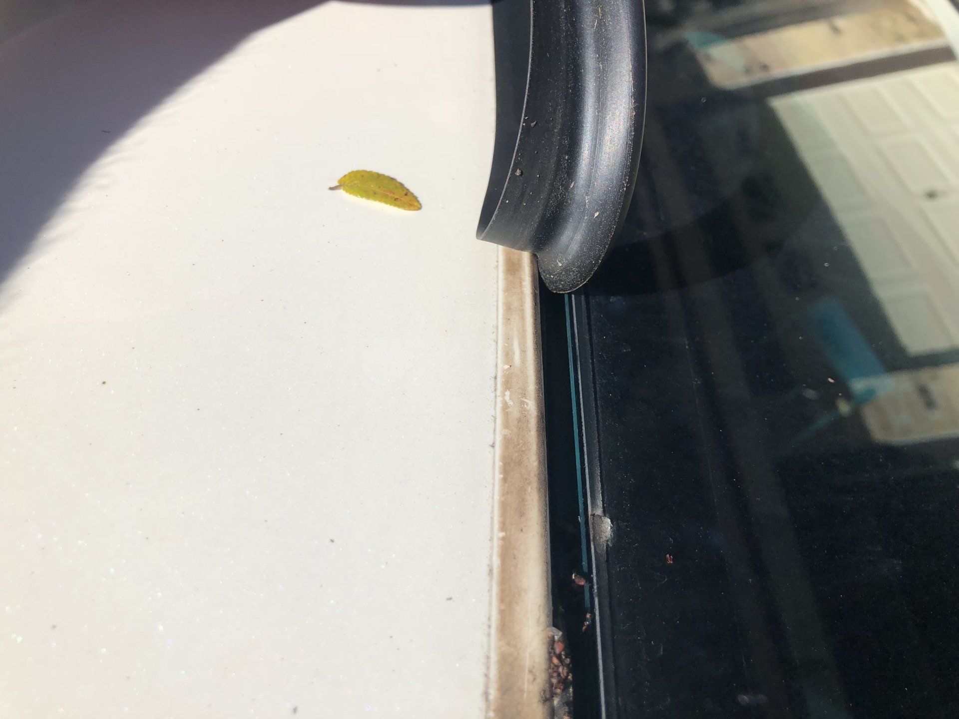

And yes I thought about protecting the leading edge.. however pulling up the back edge of the molding reveals my white paint being quite brown from organic matter getting trapped there. Still looking for time to try removing the molding before I start pulling/cutting at it. Will take pics of that process too.

Pulled the aftermarket stuff off today. Came off without too mouth trouble.. though some over applied urethane in a few spots will make mounting the factory trim difficult.
The brown strip came right off with a wet rag. This trim has been on since roughly april so maybe not long enough to actually stain the paint.
