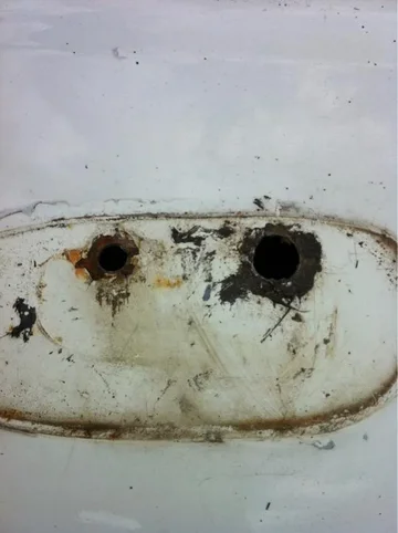

My plan was to remove the wind deflector and roof rack this weekend, as many on here have found rust under the towers or feet on these. My 80 that I purchased in Oct last year is essentially rust free, or so I thought. Last night I started to take the deflector off. The pics show what I found.
While I got 5 of the 6 screws out, one of the deflector nutserts (rivnuts) is spinning. My plan today, after searching here on MUD and elsewhere, is to try to tighten the tower back down in an attempt to clamp the nutsert. I may try a woodworking clamp on the tower to add extra pressure to the nutsert, as well as try to tighten the nutsert back up to the body (tightening the screw). If that does not do it, I will try to squeeze a scraper in there to hold the spinning nutsert from the side. After that I am planning to drill out the screw head inside the tower, then I will have better access. Some folks have then drilled out the nutsert.
Any other ideas????
As you can see from the pics, I will be attacking some rust. I am planning on welding the holes closed and repainting after repairing the rust, but I am still pondering this one.

Hope your not as surprised as I when removing rack.
This fastener wasn't port installed.
Nor were these.
One of the results

I have to fix that rust. BrotherRob, I took it off to look for the rust we keep hearing about. Before I took the deflector off, I was expecting to put it back on after painting it (purple or something). Now after seeing that rust, I plan on filling the holes and painting.

You are right Duggy, that second pic looks like a surprised Tiki carving.

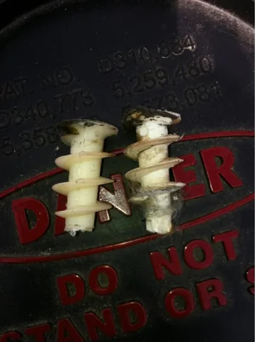

Delancy, that is some funky home depot drywall picture-hanging crap somebody put in there. I hate those PO surprises. I expect some rust when I take the roof rack off, but I hope nothing like what you found.
