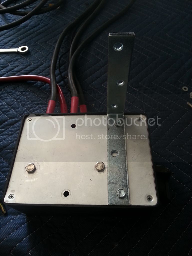

I mounted mine in front of the DS battery. I simply took some angle iron, welded a bracket to it, then bolted up the contactor. I then made custom cables that go down, out the DS headlight hole, under the rad, and over the bumper to the winch. Routing is pretty easy and I was able to run x4 1/0 cables this way.
