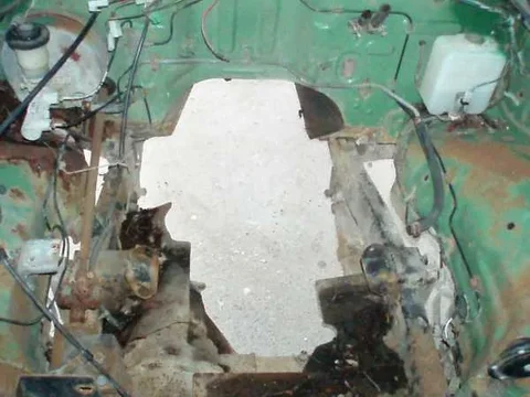

This pic shows the amount of room I have to mount the V8. Not much.

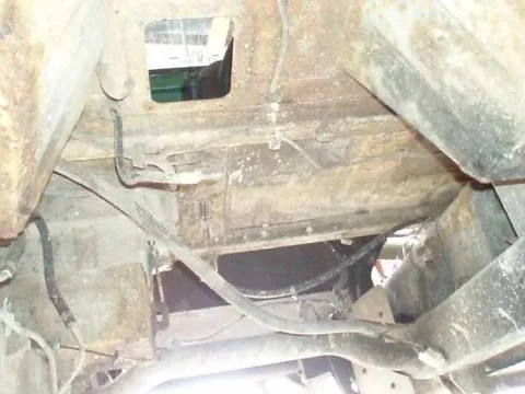

This pic shows where the winch will have to fit. The battery tray, to the left of the pic, will be relocated hopefully leaving just enough room.

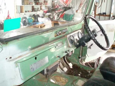

Ohh ! :eek: it have the steering wheel in the wrong side :D lol .. ! ( just kidding )
Loks plain .. perfect for off road. I'm thinking in more than V8 .. did you get space to place a rad . ?

According to my rough measurements so far if I use the Rover engine driven fan the radiator won't fit but hopefully I will be able to use some twin electric thermo fans. Either that or I relocate the radiator to behind the cab.
It is looking to be a bit of a squeeze behind the cab. Radiator, LPG tank, spare tyre, recovery boxes, air reservoir, fold down "wanker" lights and I also want to mount the snorkel and air cleaner back there as well. The batteries also need somewhere to be mounted but I think that I should be able to make room for them under the drivers seat. The original battery lived there and I reckon I can sqeeze two in there. Under the passengers seat is where the original fuel tank used to live so maybe I can mount some of the stuff there like the air tank.
I thought is great idea have the weight distrubuted .. so in front you have the weight of the engine .. and lloking your plans midle weight it's nice ..
Only I keep in mind most ( and jusnt wondering ) of the toughes parts of the trails are up hils. In a short weelbase rig and with rad, GPL tank, air tank spare tire and tool box behind the cab . ?

The Ute has a 107" WB so that should be alright wheelbase wise. With the rear bobtailed the weight even though it is moved backwards should still have a forward bias. I'll be trying to keep the weight low too.

Any further updates? Specifically interested in the centre-mounted winch idea. I'm stubbornly thinking about adapting it for near stock US spec FJ62 with a 1" body lift. ( I know the spare tire and stock exhaust will have to move). And, I want the rear seat to be able to fully fold forward with the winch access hole in the rear footwell. I'm hoping my 1" body lift will give me just that much more wiggle room.
