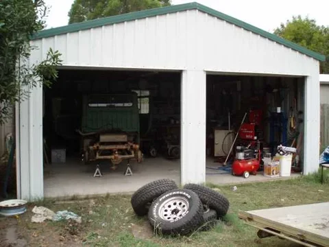

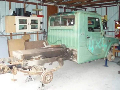

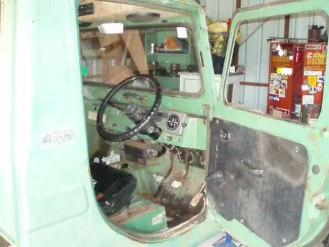

Quick update.
Haven't done much to the ol' girl in the past couple of weeks. I've been putting up a garden shed so that I had room to put the Ute in the main shed. Of course once it was up I had to clean the shed up.:doh:
I have done a bit of selling of Daihatsu parts lately too. I sold the DG diesel motor for $500 and just today sold the 235/75R15 Kumho M/Ts on Suzuki Sierra rims for $400. Of course once I sold the rims I had no way of wheeling the Ute around so I had to pull my finger out and finish cleaning the shed.
Anyway the Ute is now in there and the tyres are sold now. Time to start work on it for real.
