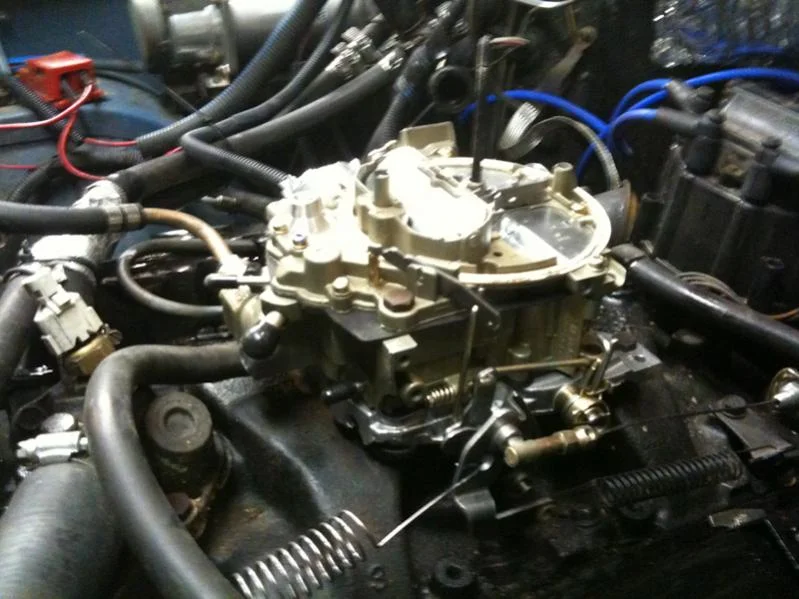

Fall Gathering was at the end of september so much done to get ready for it and so much needed to be done after it :) seemed my spindle bolts on both sides of the front axle had loosened :( so Wilma has had like 3 hub rebuilds in the last month while odd ball parts were replaced and buttoned up. it was pointed out that my carb has a vacuum leak at the throttle linkage bushings. so a new (rebuilt) rochester went in last week. noticeable difference can't wait to see how my milage does would love to break that elusive 10 mpg:D

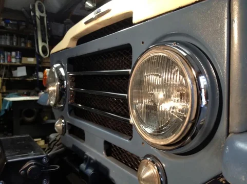

also started the transformation to fj35, picked up an old T bird from fox removed my bezel and fabricated some 25 bars and then electroplated them got that all installed today and am happy with how it came out.

last is today of the bars installed jury is still out on the TOYOTA badge
