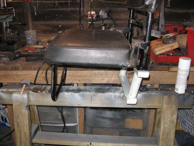

so I have 2 girls in 1st grade and they got picked up a few weeks back from a play date and the hot mom was driving what they termed as there vintage 4x4 a 93' landrover discovery. so my girls climbed into the back on its jumps seats. they thought that was the bees knees. so it got my tapped brain thinking and planning. started asking around and fox had one of every style jump seat so I grabed a 78 with the drop down leg and a mid 70's without the leg.
I also made an extremely beefy slick mount that emulates the wheel well mounting surface and for right now just screwl the upper mounting spots into the 5/8 wood paneling I had made for the inside sides. I may acutall pull off the paneling and weld in some tabs out of angle iron and weld some nuts to them so I can mount it a bit more solid .
so my girls love the seats. my plan is to only use them around town. I live in a small town on an island so I will have a no bridges rule for the jump seats. that will keep the speeds under 35 mph max.
So when I started rumaging through my large box of seat belts somewhere along the way I had picked up some retractable lap belts with 'Toyota' on the buckles . :) way kewl I am stoked how it all came out.
still have to mount the other side but one down. the other side has my air tank that will be integrated into the mount I gots plans :)))
