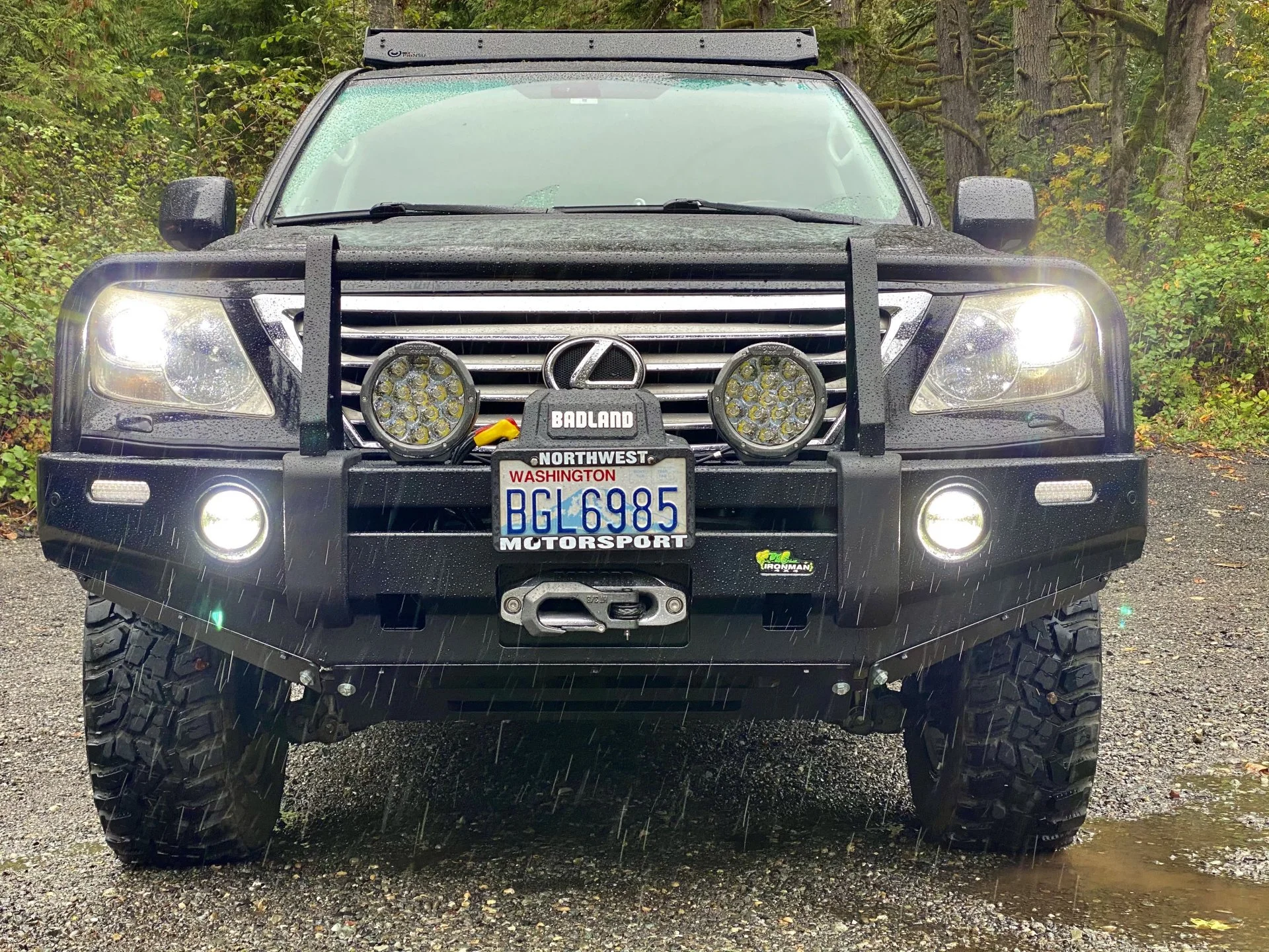

I have a Gen 1 Lx, so it's hard to say exactly what you'll run into. On the Gen I and II, the LX lights are higher than the TLC lights, but the nose is longer, so the hoops tend to get into the fascia/grille as these are 1.5" or so further forward on the LX

yeah, a lot of making a bumper fit is just getting it bolted up and deciding what to do with the fascia.
Here's my attempt
